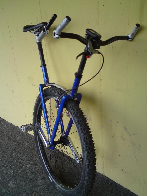

back from the xc-tour! it was almost perfect, i’ve just to wait for the kh/schlumpf wheelset!
a changed the setup before leaving again, as showed in the first picture.
the ride was a 700vertical metter uphill and downhill of course too. on the top there is a singletraock with even still snow on it. i really really like this setup, you can even play with it:
Oh my God! That is something special! Is the future for off-road unicycling going to be the V Frame? If it is I’ll adopt it! I wonder what a 24" version would be like, especially on real technical single-track both up and down? Can you get by using the handlebars or do you have to go to the seat handle? If one can hone their skills to doing all their riding with the handle bars then we’d “look” far more like mountain bikers. I don’t know if that is a good or bad thing? I kind of like the looks I get because they think I’m riding around grabbing my crotch! As if!
Another, radical, idea might be a “collapsable” v-frame. Think everything about turtle’s frame but make it so the “down tube” can pivot forward or backward (and lock) that way if you have some gravel road miles to cover you can “drop” the down tube out, lock it and ride more like a bicycle. When you’re going to do some rough muni you can fold the downtube back against the main frame and lock it? Obviously something would have to be done about the main handlebar to keep it out of your way when doing rough muni?
Perhaps I’m overthinking this, if one can truly ride this new muni V-frame much like a bicycle then one wouldn’t need to be grabbing for a seat handle? Very interesting! Boy I need to make some friends with some metal workers!
at the moment i would’nt want this with my 24", for real technical stuff (mostly downhill) i think you dont need a handlebar, it’s dangerous and you cant hop very well…
for hopping i used the bar in front of the sddle, that works very good…
about the collabsable thing, i think gizmo is doing something like that, but for road riding, so he can change the distance between saddle and handlbar.
i’m sure V-frames will be the future for XC and road riding! i don’t think it will be for freeride or downhill riding…
I agree I think there is just “too much stuff” in the way to be able to do freeride/downhill riding. Still it might make a uni (at least a 24") more “one purpose” if it had a collapsible V-frame so one could (like I do) use the 24" for XC and free-riding? One of these days when I have time/money to experiment I’ll give it a shot. Looks great Turtle and everybody… have really got me excited about the future!:slight_smile:

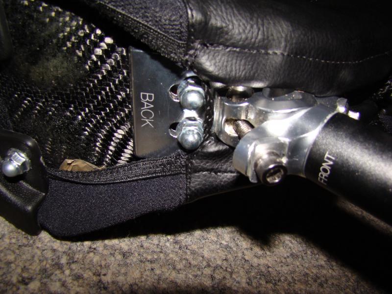

Hi roadies,
I’m going to build a few handlebars shortly to test more riding positions on my 36" guni.
I designed something between the coker PI Bar and the custom “bike stem” ones, but without the wideness and with a lot of adjustability. It’s simply bolted over the KH handle and the seat tube (27.2mm).
I prefer relatively close-to-the-saddle handles. But I’ll keep the “toptube” pretty long first, then cut it to the length of the best position found after testing. It will be made of Alu 6061-T6, except for the steel bolts. Total model weight = 516 g. I’ll probably hack a few more grams with more machining or thinner tubes, right now the design might be a tiny bit overkill.
Inputs are welcome of course.
Vince
[EDIT] I’d be glad to share the 2D drawings (or 3D parts) to anyone interested. And I need to name the thing too!
