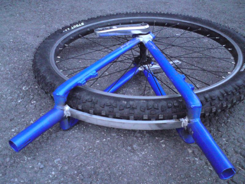

Where are the pics of Turtle’s frame? ![]()
Thats nice, it just needs a powdercoating now and this thing is ready for the road (and dirt)

only the top pice that goes around the tire looks fat to me
already thought of drilling holes?![]()
it will be stiff enouf and you can safe some good weight
even more stimulatian to finsih my frame soon;)
Good stuff turtle but I would be a bit concerned with the bridge part being flat and curved like that. Seems to me like if you put enough spreading force between the saddle and handlebars it could flatten out that bridge ever so slightly putting stress on your join at the bearing housing. I would not be so concerned with a steel frame but aluminum does not like going through stress cycles as much.
I would be tempted to add a tensioned cable just above the bridge so it only really has to deal with compression forces.
That thing does have awesome stand over clearance, I wonder what it would be like to mount it from inside the frame.
Wow, now that’s a pretty sweet looking V frame. Have you had a chance to ride it yet? How does it feel? how stiff is it?

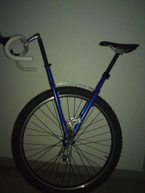

This is almost what I’m doing next week. I have spare KH36 frameset. I’m modifying it into a V-frame. but it won’t be by welding it to another KH frame. I’d prefer the length adjustment, so won’t be using a second seat-tube…just a long top-tube to bolt the stem onto. Like my 7-shift.
Ken

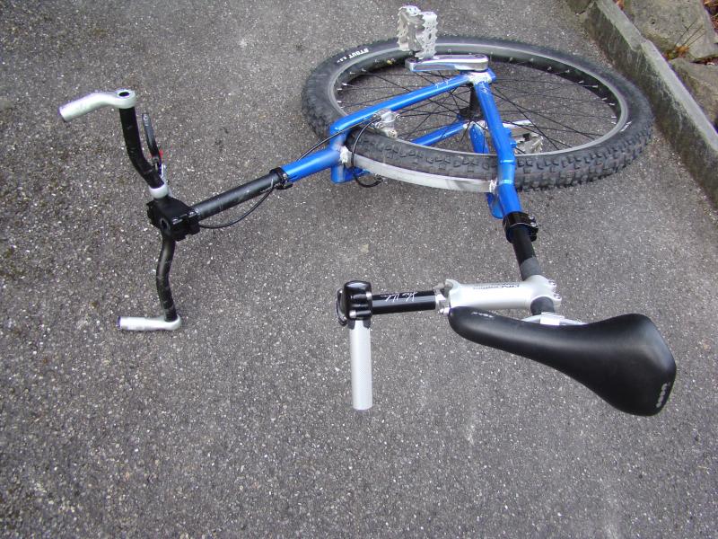

@gizmo: that was why i was rushing…
about adjustments: i’ve got 7cm with the saddle (forwards or back) on the rail and with different stems there are lots of possibilities. i think for road riding that’s enough, if you use a brake. for XC we’ll need something different.
here is my X-version with a “kh” handle
i’ll try it tommorrow on a real XC track (uphill and downhill offroad)
i messed around today a little with this setup, for xc it’s pretty hard, because i’m not used to the bike seat.

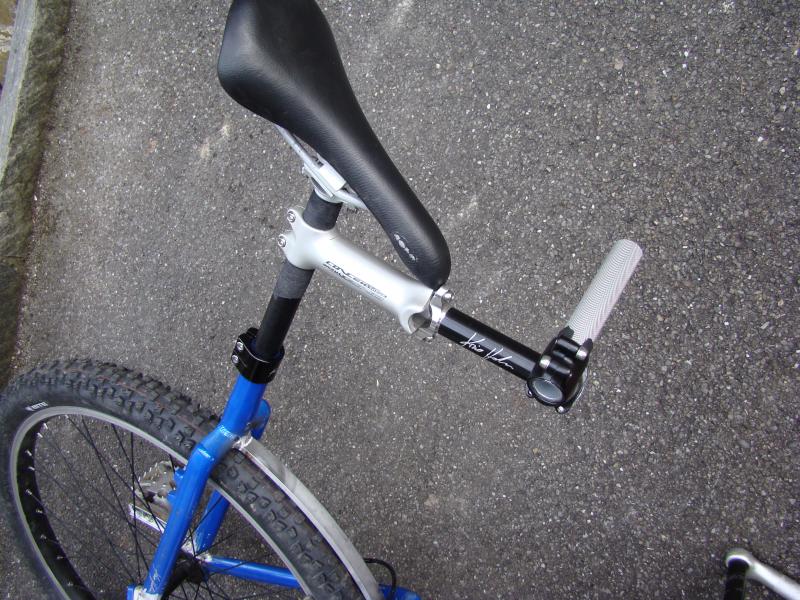

so i made a saddle out of a cf base and foam and cover from a freeride saddle.
when i tried that, it was much better but i felt that it’s to wide in the front, my legs rub on it.
so i want a almost flat saddle which is not that wide in the front, but which has a handle in the front, so i dont need an other one…
anyway, tomorrow i’ll test the setup (in XC as i said)with this cf-base-freeride saddle with the normal handle
i really liked your race setup
clean no things stiking out
then your xc setup
the front part i like but that extra handle no thats just to much:p
i know your alsow just experimenting things;)
