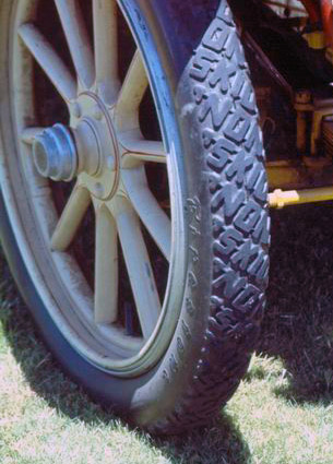

Early 1900’s automobile non-skid tires did have a NON-SKID tread. The so called Coker non-skid tires have COKER in the tread.
Jim
Jim,
My dad has an antique motorcycle with the “non-skid” tread. I have attached a picture of the Nightrider tire for comparison. The Coker definitely looks more round.
