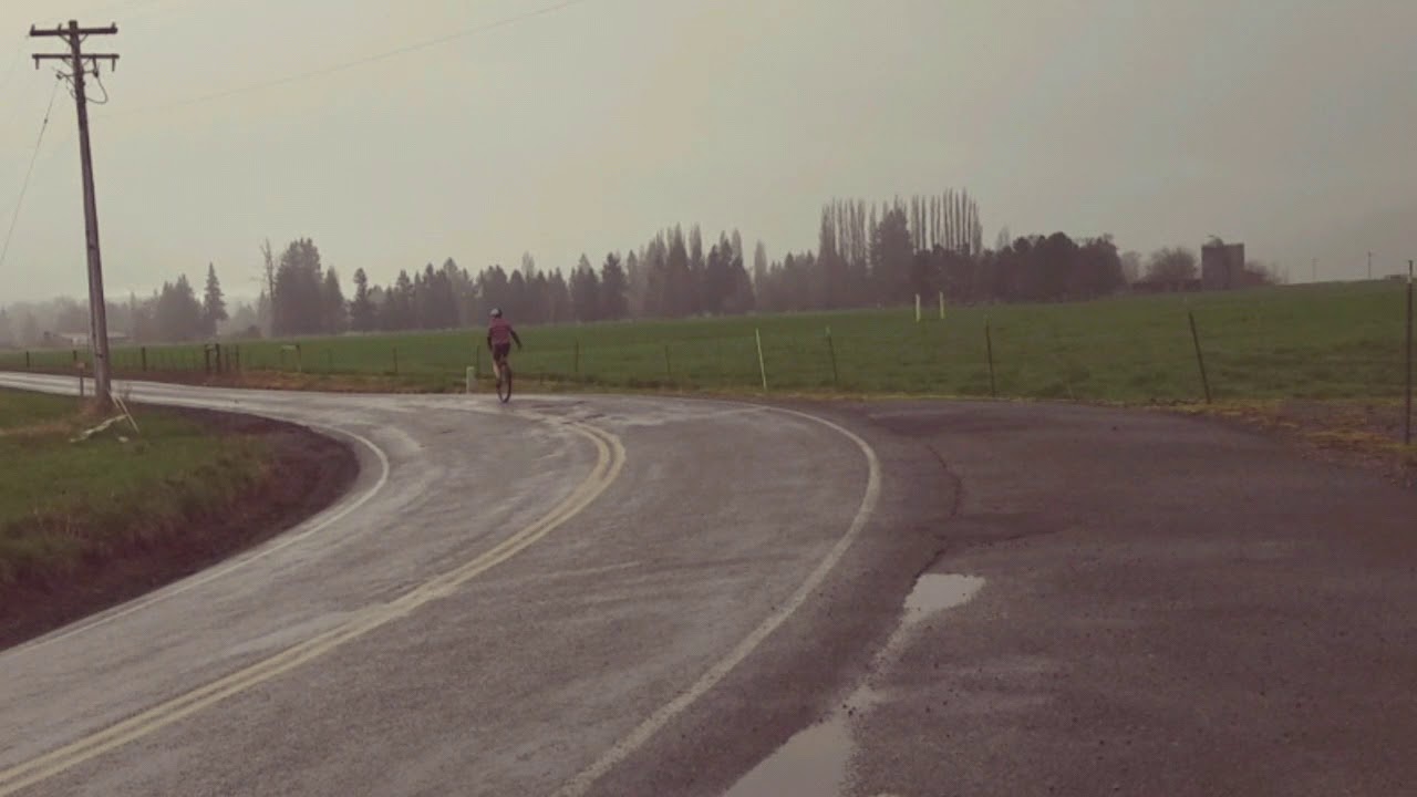

I’m reposting your pictures and a recent one of me for you to compare.
Please note that my spine is close to vertical and shoulders are close to level. I’ll turn street corner and make sharp turns in this same body attitude/alignment.
Many will first claim there is no room to move their seat over. I’m a small man with narrow hips and I can. I’m only talking about a minor adjustment. Your pictures seem to reveal room for a minor adjustment. If your seat is adjusted in the wrong direction this will compound turning issues. When turning the opposite direction as the adjustment like in the picture facing the camera notice the required legs—hips—shoulder angle it requires you to make the same turn on the same camber. See how the shoulders are not level, the spine is no longer vertical, and the body is twisted.

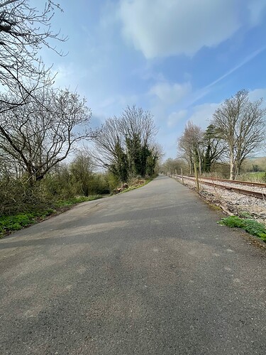

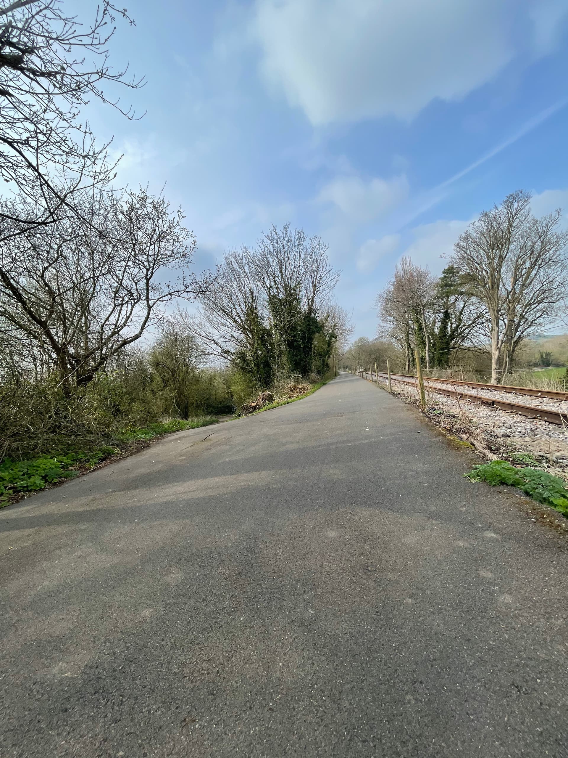

It’s a converted railway line and if you can picture it as one of those stretches when you can imagine that the locomotive had to put on steam to get up and round the incline. Well, I suspect that’s what was needed when it was a fully operating line. There’s a recreational steam line that follows the bike path for about 2 miles.
I can’t recall fully how I used to ride this section my my KH36 and I’m now curious how the wider 125 mm + KH spirit cranks impact camber control on my Nimbus NR set up. It’s a wider stance which I guess does make shunting the saddle / frame under one’s hips / centre of gravity more of an action than I’d have needed on the KH. But I don’t mind learning the extra muscle control here.

Well I am happy to report that running 55PSI really helped a ton. I was dreading it being too bouncy or hard to manage - but it was far far more controlled, including over some of the dreaded roots and double dip ripples under tarmac I don’t like.
I rode without an angled back to cope with 95% of the camber on the stretch I ride these days.
The wheel tracked the line I needed and I didn’t need to yank it around to cope with odd off camber moments.
There is still one section where I couldn’t stay on - and that’s when the camber opens out with a downward left turn and an upward to the right curve of the path I want to stay on.
This photo doesn’t do the in real life angle of the path - it is much more slanted when you’re then and up on top of a 36er. But I sense that after a few more rides out and back I’ll nail this section.
