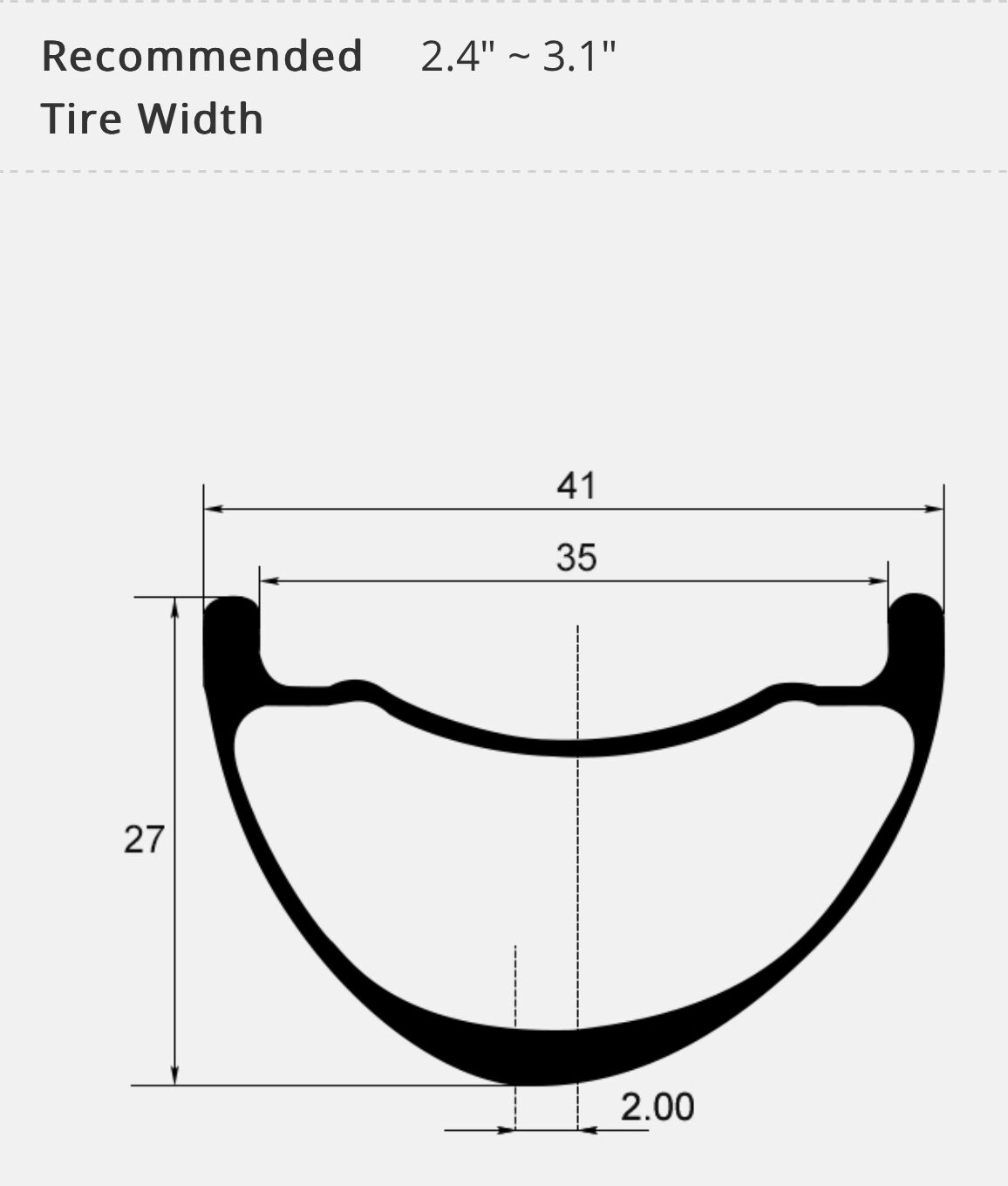

I can totally second this point. And wish I’d thought a bit more about my choice when buying the AM935… perhaps going to the EN932 which is ID 32mm not 35mm
It does show on the spec page that that rim - can take 2.4”-3.1” tyres:
And at the time of ordering I was on the fence between running a 3” or 2.8” so felt it was a safe bet. But I think in hindsight I could have gone narrower as I’ll never need the 3.1” sizing capability.
In short, I feel you need to aim for your favourite tyre now, but with the awareness that as you develop skill you’re likely going to want to go narrower, not wider. So give yourself bottom end “growing space” for narrower tyres… and don’t worry too much about being able to install fatter tyres (unless you just love fat tyres)
It’s the one area that needs careful consideration so you don’t trap yourself into a too-wide-a-tyre, as with unicycles changing tyres is a pretty easy and common way to change the ride and feel of your wheel.
