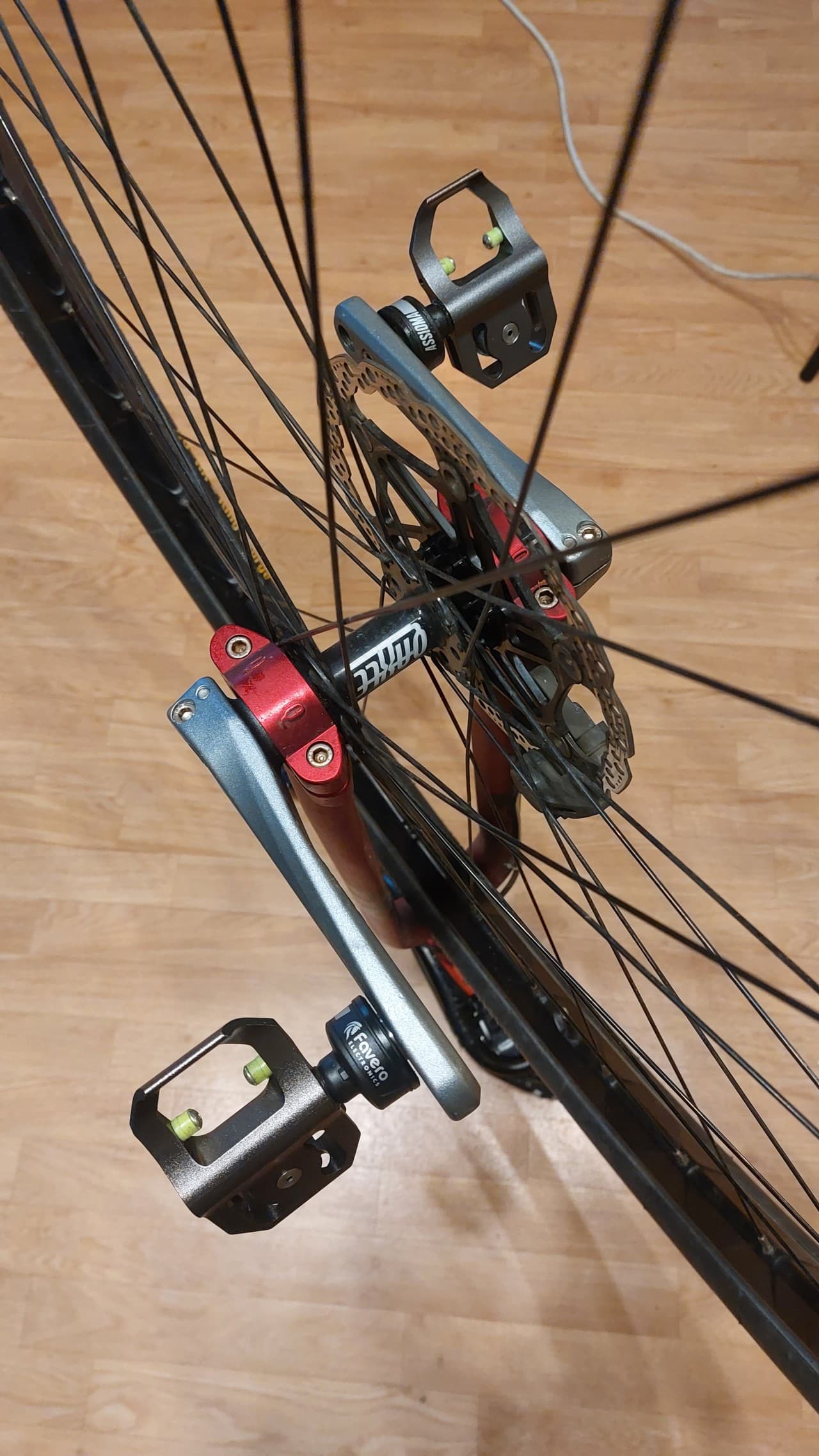

I am a bit disatisfied with my flat pedal setup… It forces my feet to be further apart, which I don’t like. (At least 16 mm per side)
Few things I will try
  1. custom cranks that are a lot narrower to move the pod inwards.
  2. clipless pedals… will need to work on my unicycling skills before I try them again
If these don’t work, then I’ll have to look at the SRM X Power Pedals again! I think the high sampling rate data would be cool for road riding too.
Decided to try some modified VCS cranks with 5.5mm offset each.
This decreases the Q-factor from
100mm hub +
12mm bearing +
6x2mm spacer +
27x2mm crank width -
16x2 mm powermeter pod
= 210mm, down to 199mm (-11 mm)
This is still a bit wide, but now within what fat bikes use.
road/gravel bike = ~150mm
mtb = ~170mm
fat bike = ~200mm

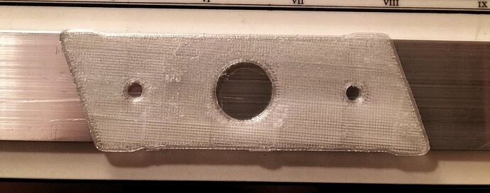

Made some 3d printed platforms that are thick enough so that I stand on top of the pod without touching it. No I don’t have to modify my cranks (which was not possible with hollow bicycle cranks)
I am not sure how robust I can make them. One good thing is it can be super custom… but with a new challenge of figuring out what type of pedal shape and pin placements are best. Did my best for now to just look similar to other pedal designs.
If anyone is interested, I could share the other files/parts.

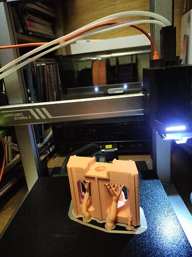

My son printed the Pedals on his new 3D Printer - Anycubic Kobra 3.
I just installed the right pedal Power Meter, installing the bearings in the 3D printed pedal. Finished printing it this morning - took approx. 8 hours (material: PETG) Needed just a slight bit of sanding and the bearings have a firm push fit.

Version 2.0
Is currently being printed - 23 hours printing time. I modified the 3D model in AutoCAD. Changes include:
  1. Print at 100% fill
  2. Simplified shape with flat sides.
  3. Component will be a solid block.
  4. Bolt an aluminium 3mm plate to the outside face of the pedal. Add rubber on top… Should resolve the weakness of the Printed PETG with impacts of the pedal with ground in UPDs.
Image of a failed print - filament melting temp too low. Sitting on top of 3mm Aluminium bar I will cut to fit.
Adding aluminum support is a great idea!! My next step was to do somehting similar!
I forgot to update it here, but I made a new model to remove the thin sections, and also make everything more rounded.
It breaks at the middle of the axle (
Would be cool to try some sort of aluminum sandwich plates, or screws to compress the print layers.
Edit:
Just took a quick look at the area I broke, and updated it to be 40% thicker. Should be reflected in the original link in this post. (v13)
I don’t think it is the best solution. Looking at how it broke, I would say the main problem is the print orientation. It broke by delaminating, to avoid this kind of braking, you should print your pedals flat on the plate instead of standing up. You might end up with poor print quality inside the sensor hole.
I should add that PETG, ABS and PLA might not be the good choice of materials. I would personnaly use nylon or hard TPU (at least 95A or 50D). This way it wouldn’t shatter on impact (and ideally I would put an insert inside to fit the hub as well as possible, and then the actual plastic around).

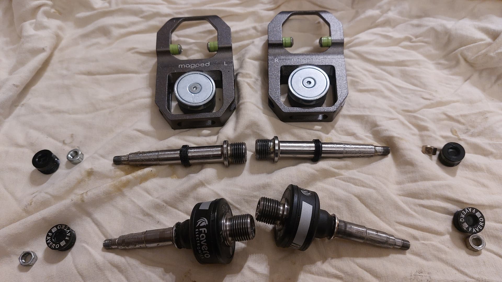

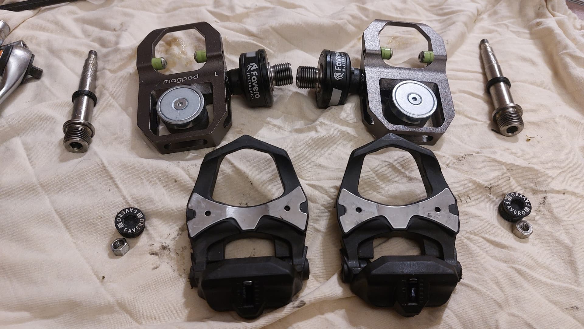

A few weeks ago, I tidied up my garage and took a look at my favero assioma duo pedal set… I bought them at the end of 2021 and rode them for a season…
I’ve been sponsored by magped for a year now, so I’ve been able to test several pairs of pedals. I love them and couldn’t go back to the classic clipless pedals.
Out of curiosity, I took apart a favero pedal to inspect the axle. I found that it had some similarities with the axle of the magped road1 and road2 pedals.
I then tried swapping the pedal bodies and it seemed to work perfectly… I took out the caliper to measure the internal diameter of the bearings and the distance between them. Everything was exactly the same.
I tested the road1 and raod2 pedal bodies, and the fit was perfect. It looks like it was made for it.

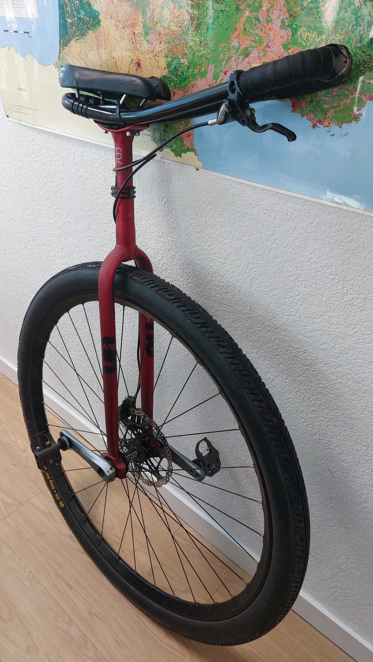

I did 2 rides last weekend on my ungeared 36” with these pedals:
I’m looking forward to this weekend to collect data on my G36 :wink:
