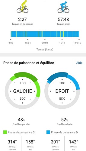

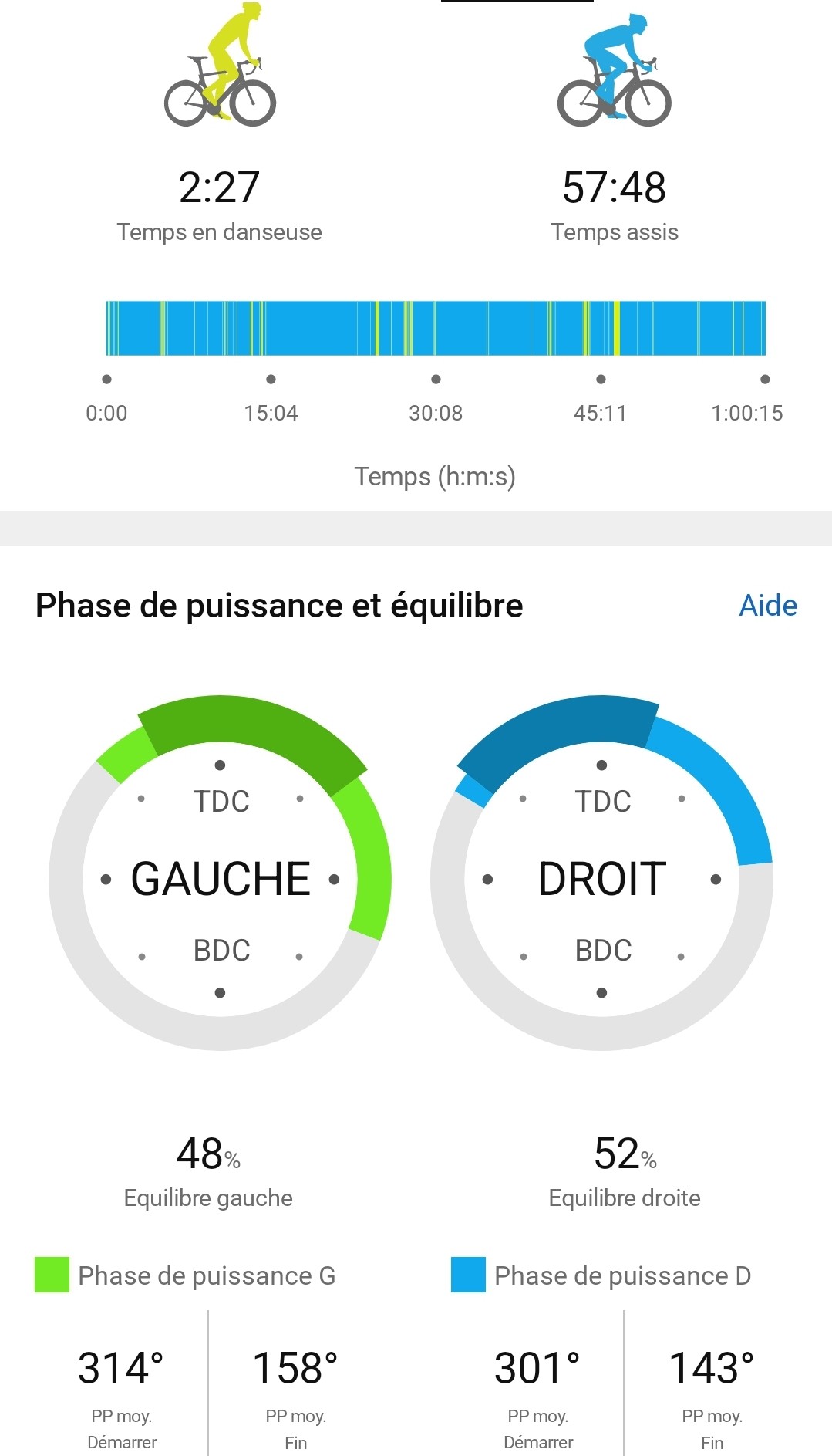

At the moment, I’ve done 2 hilly rides (20km with 350m of d+) in 36” 145mm:
  • The first was intense, I gave it my all in every hill (to raise watts and heart rate).
  • The second was on a similar route but I tried to keep the cardio low and concentrated on pedaling smoothly.
On both rides, the data on power phases, left/right balance, fluidity and pedaling efficiency were the same on the 2 rides. I was offended to see only 2/3 efficiency and 15% fluidity. :smiling_face_with_tear: Probably the sensor considered that I wasn’t in the right gear…
It seems that cyclists have their power peak at 90°, whereas my power peak is around 0°.
My hypothesis is that crank length and schlumpf use should have more impact than focusing on pedaling smoothness.

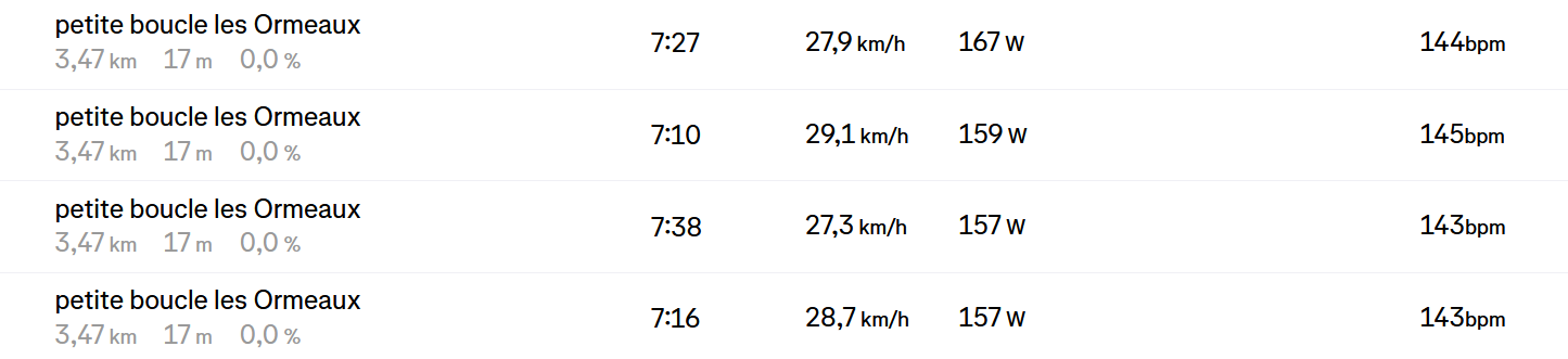

I’ve done several rides on my G36 with my power sensor pedals.
This morning, I wanted to test the impact on power of the 2 positions I use on my unicycle (upright and aero).
Near where I live, there are some little country roads with little traffic, including 1 loop of 3.5km (with 17m of difference in altitude, mainly on a 1km false flat at 1.5%).
I did a simple protocol with 4 laps:
  • laps 1 and 3 in the upright position (hands on the barends)
  • laps 2 and 4 in the aero position resting on my aerobars (elbows in the elbow rests).
I tried to be regular in my effort (I put a little more intensity into the first 2 laps). Here’s the data:

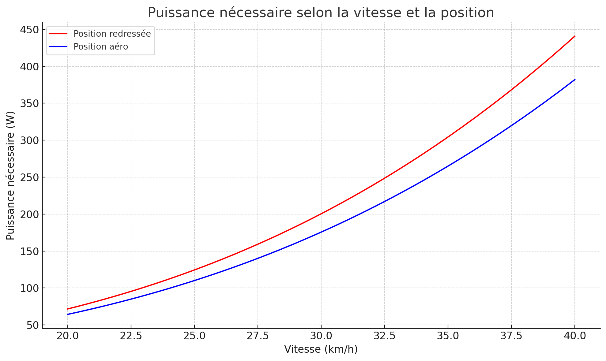

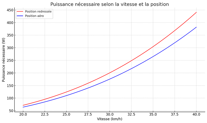

I don’t know the formulas for calculating CdA so… I asked chatGPT to estimate my CdA in the 2 positions and the relative and absolute difference in performance of the 2 positions.
ChatGPT estimated that the upright position has a CdA of 0.47 and the aero position a CdA of 0.40.
The AI estimated an aerodynamic drag difference of around 15% and produced this graph:
I’m unable to check the calculations, there may be errors. Finally, the CdA are higher than those estimated by @unicycleharry, there is certainly an overestimate due to the efficiency of the schlumpf hub and the course where there is a bend where I have to brake.
