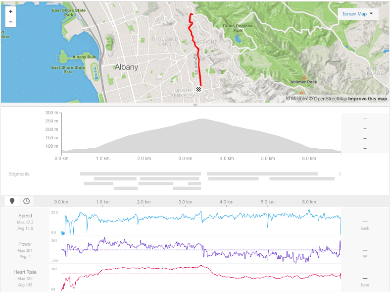

Installed power meter on the left crank, 125mm KH spirits.
I don’t have a way to log more data yet; only using strava. I can ride the hill recording either net, positive, or negative power.
Today, my first ride was using net power.
I didn’t use my brakes on the downhill at all.
I think it was estimating low, by about 20W. Before and after the ride, I spun the right crank to about riding speed, and it was saying -20W.
However, after looking at it more right now, it doesn’t seem right…It should have gave me about 5W overestimate… Not sure what’s wrong.
I think it’s cool that the total average power was about 0W. :smiley:
Very cool!
That is a fun way to summarise a uni ride: 0W like in the couch :smiley:
Joke aside, it sounds like a powermeter needs to take into account the uni specifics of back pressure by registering all measurements as absolute value.
It is nice to follow your experiment :slight_smile:
That is interesting. Normally, for a bike, if your foot that is on the upstroke is pushing and not pulling, that will detract from the powermeter’s measurement.
Even though it does tire the rider out, just like going downhill on a unicycle. However on unicycles and fixies without brakes, that is much different when going downhill since we are forced to backpedal.
I’m not sure what exactly is the best way to do it.
One possible take is just letting it go negative, and looking at rides in segments. The reason for this would be so that, someone who is backpedalling vs speeding down a hill, won’t have the same power reading.
