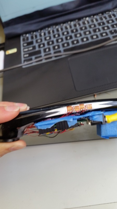

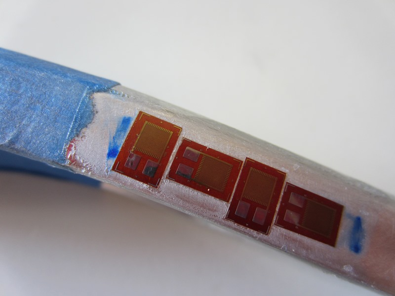

1st pic: 4 strain gauges on KH 137/165mm cranks.
2nd pic: is a power meter I made for my bike. I used 4 strain gauges, an instrumentation amplifier, and an Arduino 101. 170mm square taper cranks.

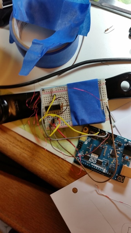

3rd pic: was before I soldered everything together and was testing with a breadboard.

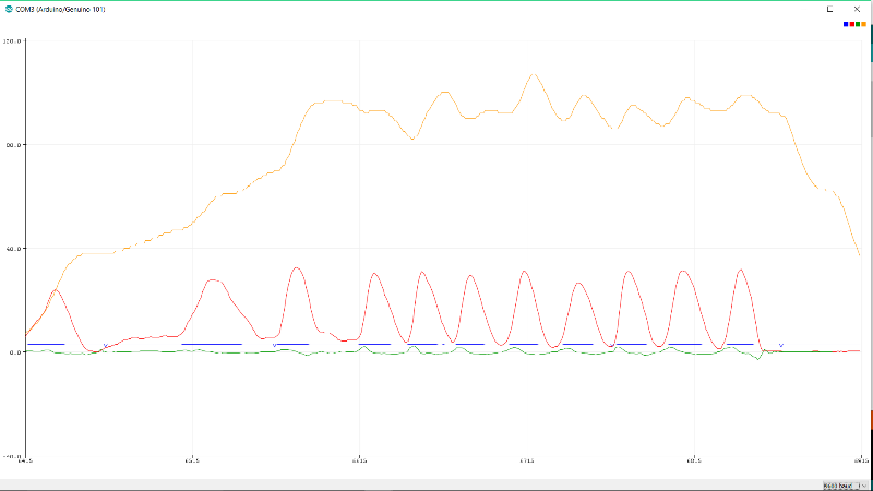

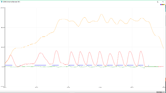

4th pic: I set cadence to be 60rpm, red line is torque, orange is calculated power with a moving average.

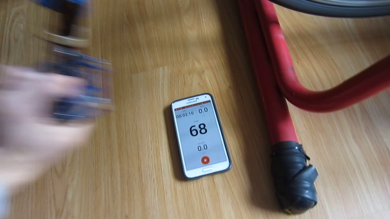

Here is a video of it working, with 5 second averaging.
