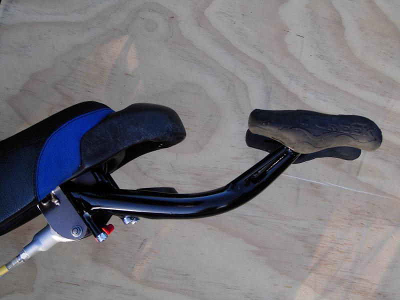

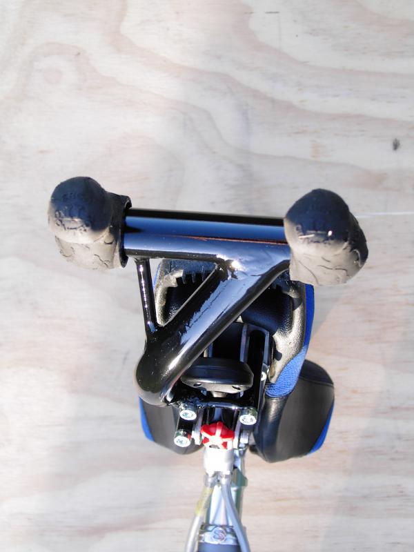

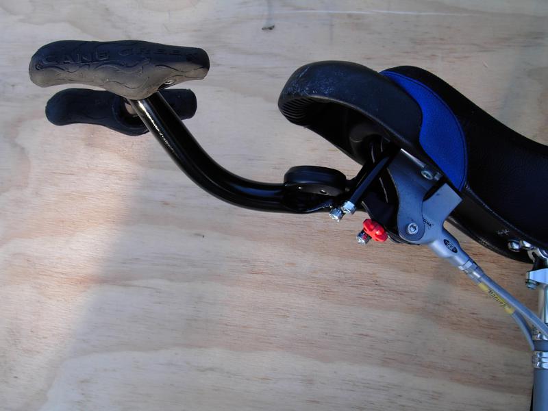

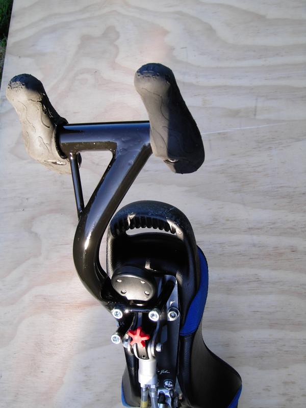

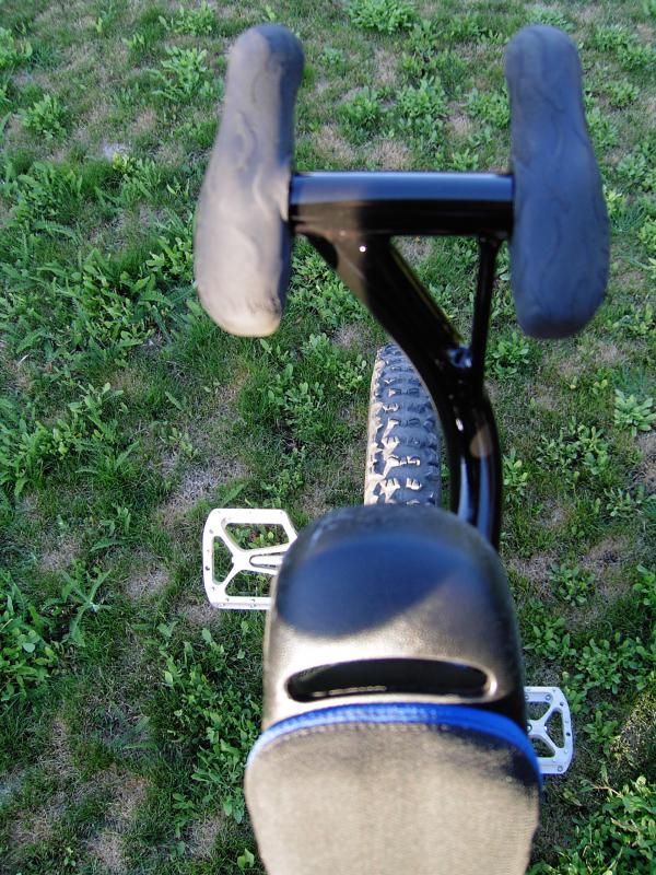

I found an old post I did over 10 years ago on here and here’s a few photos from that post I posted for my medium size handle extension for uni riding

This old medium size handle bar was solely designed for a 50 kilometre Mountain Bike race for when I was in high gear.
But I cut down the brake lever body and tucked up close underneath the saddle the lever body so that I could use it on technical Mountain biking downhills.
It worked absolutely brilliant and are having a brake on the handlebar would’ve been just too dangerous and unsuitable for the events I rode in, and the mountain biking are used to do on my geared unicycle.
The smaller handlebar I’m trying to design is for on my new KH, 19 inch trials unicycle that hopefully we will arrive in the next few days after a long wait in New Zealand customs.

The plan for the smaller handle is for an extra position for when riding 5 to 6 k’s on a 19 inch wheel, I know it’s painfully slow on the smaller tire. I did it when I went over on holiday in Australia and would go for 5 to 6 km ride each morning practising for the upcoming unicon in New Zealand in 2010.
Any ideas for slightly larger handle than the long standard handle that comes on impact saddle would be appreciated.
All I need to do is go and buy some suitable steel and start welding away.

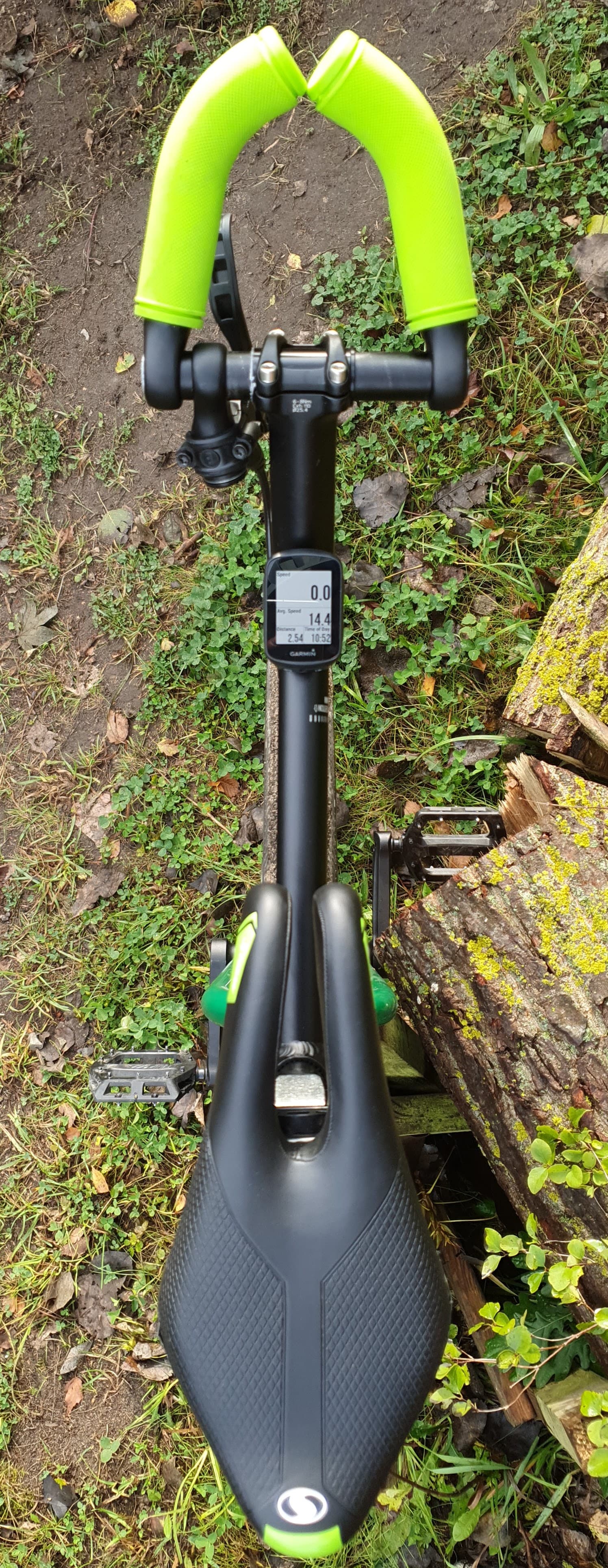

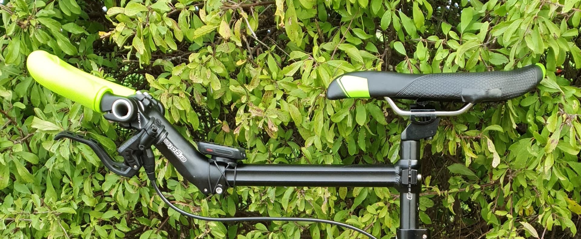

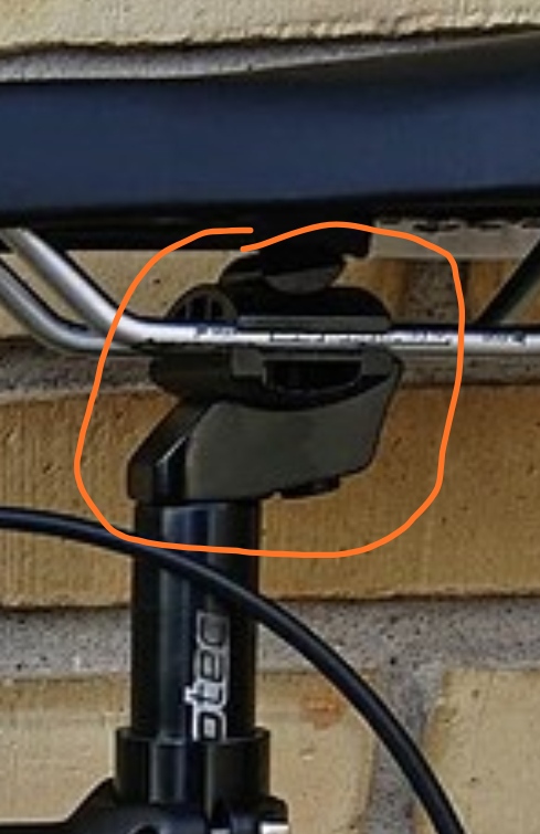

I decided to try to get rid of the protruding “clamping screws” that I showed earlier…
…so I got yet another “folding bike stem” from aliexpress - and this time I got one in 28,6mm diameter :slight_smile:
It is supposed to clamp a 25,4mm handlebar… but used in reverse clamping a 25,4mm seat post in combination with an Ergotec High Charisma makes for an even better setup as there are no protruding “clamping screws” occasionally touching my tights/pants.

Hi, Hammer.
I did try the same type of saddle locks, one screw lock, but without success. This screw get loose all time. So
I went to doble screws seat postes. Do you have the same troubles?
No it seems to be fine - but I also like the double screw with “infinite” adjustments better. I believe this seat post was just a leftover I had from a bike that needed a longer seat post.

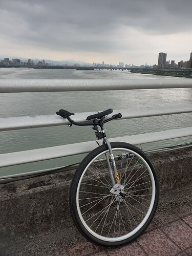

II thought I had posted my own handlebar before, but I can’t find an entry about it.
Here he is. This handlebar is very minimalist and 100g light. You can mount the brake handle under the saddle handle or in front of the saddle handle and you can leave the handle on the saddle. With a ball grip you can also brake from the front if you mount a T-piece on the brake lever, and otherwise from the side. Since it’s just one bar, you can brake with both hands and also switch hands.

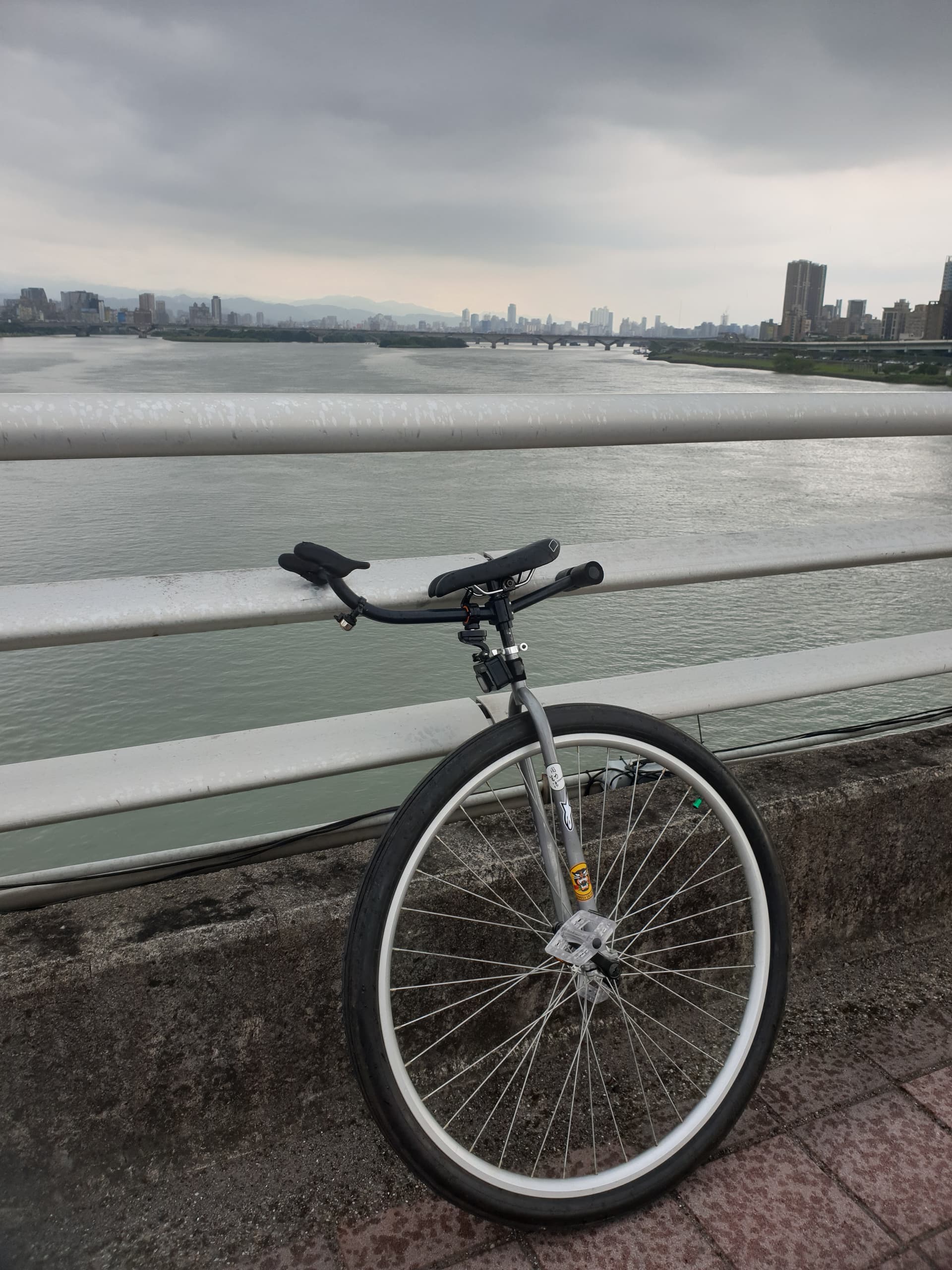

Have you tried to raise the front of the saddle and adjust its front and back position? I’ve been riding with a similar angle and position as yours for several times. For short distances below 15km, it was fine. But last week, when I rode for 50km, I found that after about 25km, it was so painful that I had to rest every 5-10km. I think the pressure point is at the front edge of the sit bone. I may need to test more to find out the best solution.
Yes I did experiment with the angle of the saddle and I think it makes a difference. Too low at the front and I slide forward which makes it uncomfortable.
Apart from a fairly ergonomic saddle with a width that matches the sit bones I think the key to the best comfort for road riding is to have a handlebar that is positioned quite low and with some distance from the saddle. This forces the rider to have a significant amount of force on the wrist/hands and thereby reducing the pressure on the sit bones similar to a regular bike. The handlebar setups I am using feels quite similar to a regular hybrid city/sports bike in terms of pressure on the handlebar and saddle.
By looking at your picture I would advise you to try to lower the handlebar a bit.
Thanks! I’ll try it.
