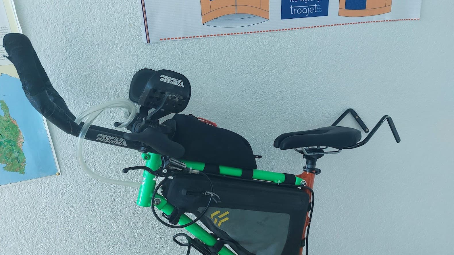

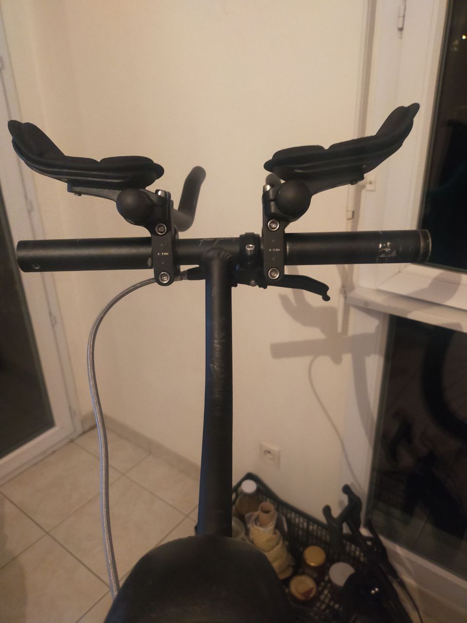

Nothing really new, but I have found something pretty fun while trying to find the best position for my brake:
Based on a regular KH t-bar, I was looking for a bike-similar braking position. The issue is that the KH t-bar is too narrow to let you use it as bike handlebars. So I had to find a way to make the bar larger. Guess what? KH seat posts internal diameter is almost 22.2 mm. That means you can use an old cut seat post to have longer bars! Not tested it yet, I’ll give it a try tonight.
Looks like it could be a real leg catcher on a front off UPD. You will have to say how it works in a UPD.
I don’t think it will be a real issue. Or, at least, not a bigger issue than my aerobars and my previous bar ends. But I’ll say how it works once tested!
Some quick tests yesterday and this morning: the braking position feels amazing. As expected, it’s really similar to a bike-braking position - the brake lever is where it has been designed to be and the fingers spontaneously go on it.

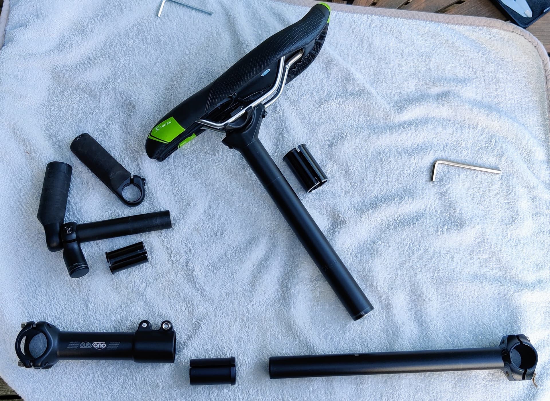

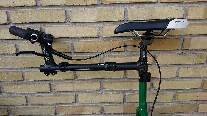

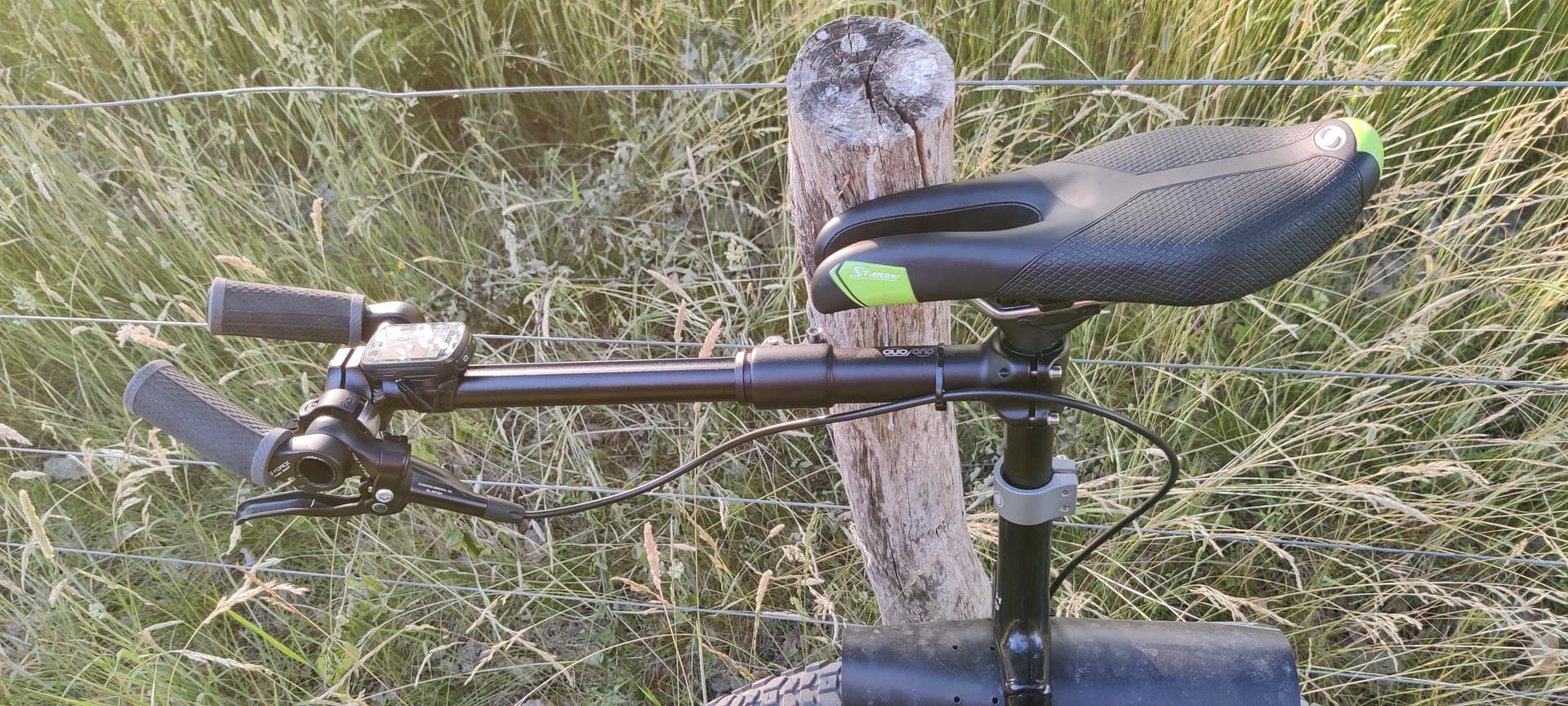

I’ve been enjoying my M40 Handle Saddle + ISM saddle setup for quite some time now. It’s my favorite so far. But I’ve also come to realize that the Handle Saddle base is not really important to me as I exclusively hold the handles/bull horns at the end. So I have long been toying with the idea of building something similar with a regular seat post…
Parts list:
  • Split nose saddle (an ISM clone)
  • 27,2mm regular bike seat post
  • 27,2mm → 31,6mm shim (ideally it should be 31,8mm but I had no issues with 31,6)
  • A piece of 22,2mm handlebar (just a piece of a regular bike handlebar)
  • 22,2 → 25,4mm shim
  • 3 x bike bar ends / one cut short to just hold the brake lever.
  • 180 degree bike stem
  • Folding bike stem 300mm - description said tube was 28,6mm but it was in fact 25,4mm
  • 25,4mm → 28,6mm shim (because of above mistake…)
I ended up using some other longer bar ends than pictured and I also had to angle the nose of the saddle a bit downwards to get the best comfort.
It’s very stiff and also quite lightweight. Seatpost, seat and handlebar is ~1300g in total.
Like it so far, obviously best suited for seated riding with two hand on the bar. When standing up in the pedals it feels a bit sketchy :slight_smile:

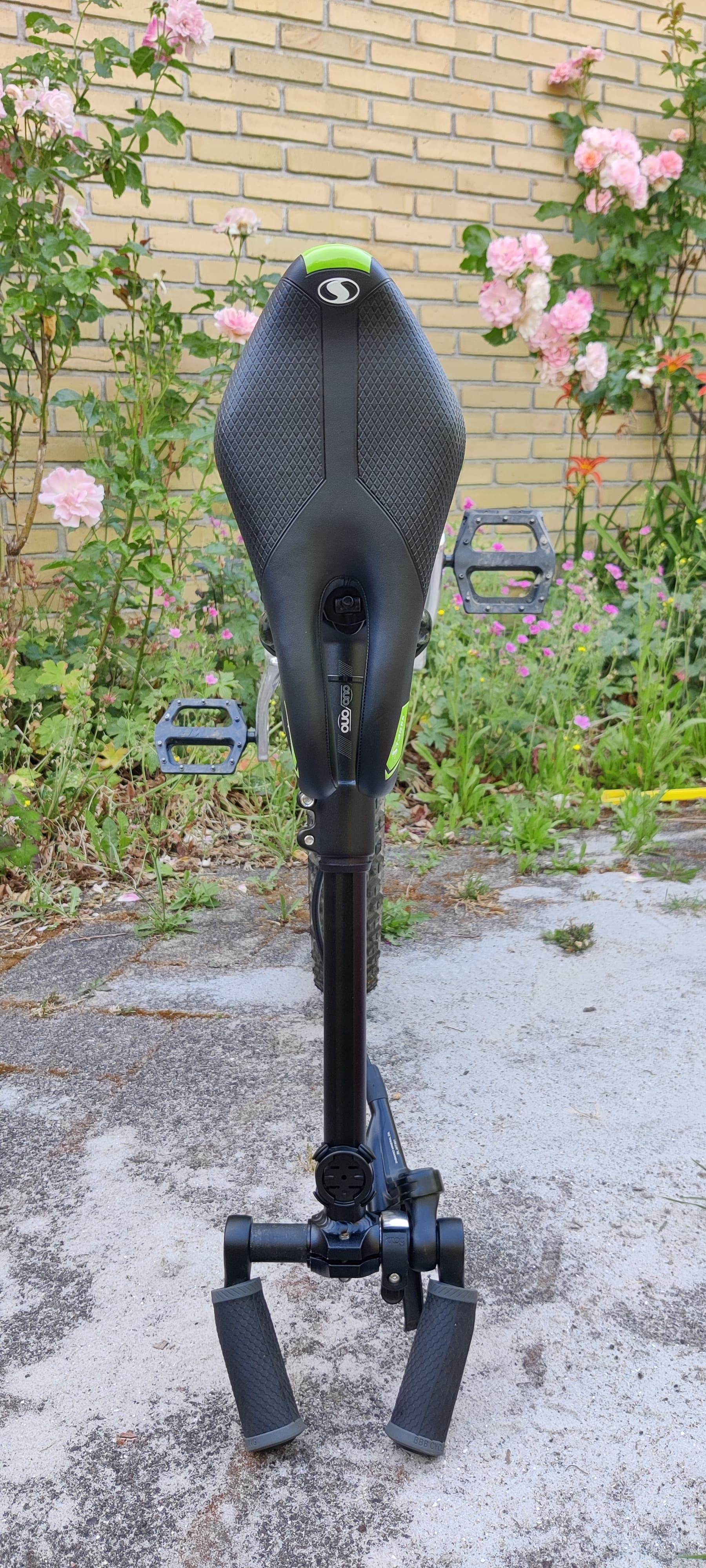

Nice setup!
Those stems you found look perfect for low fabrication diy handlebar builds :slight_smile:
Nice DIY build indeed !
Seeing the picture, I wonder how does it feel riding? Does it feel like you need to reach down (aero-like) or is it just the picture giving this false impression ?
It feels like I have to reach slightly downwards when riding but I believe physics/balance makes it slightly less aggressive than it looks like in the first picture I posted.
I think it rides similar to the angle pictured here but unfortunately I don’t have a picture in motion…

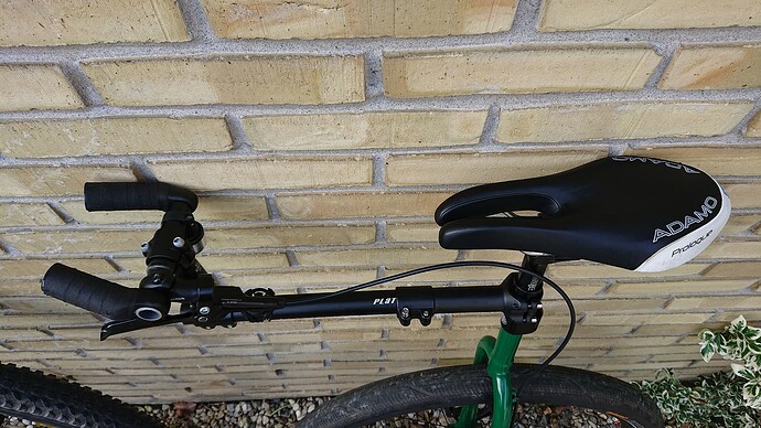

Also a “cockpit” view. If you look closely you can see the “clamping screws” on the 180 degree stem just in front of the nose of the saddle. I touch them slightly when riding and it’s the only minor issue I have with this DIY solution.
Btw if someone wants to tweak this setup with a different handlebar position I suggest getting a 28.6mm seat post and a regular 1 1/8"->25.4mm stem. It would obviously be possible also to use a stem with an adjustable angle for a flexible but a bit heavier setup.

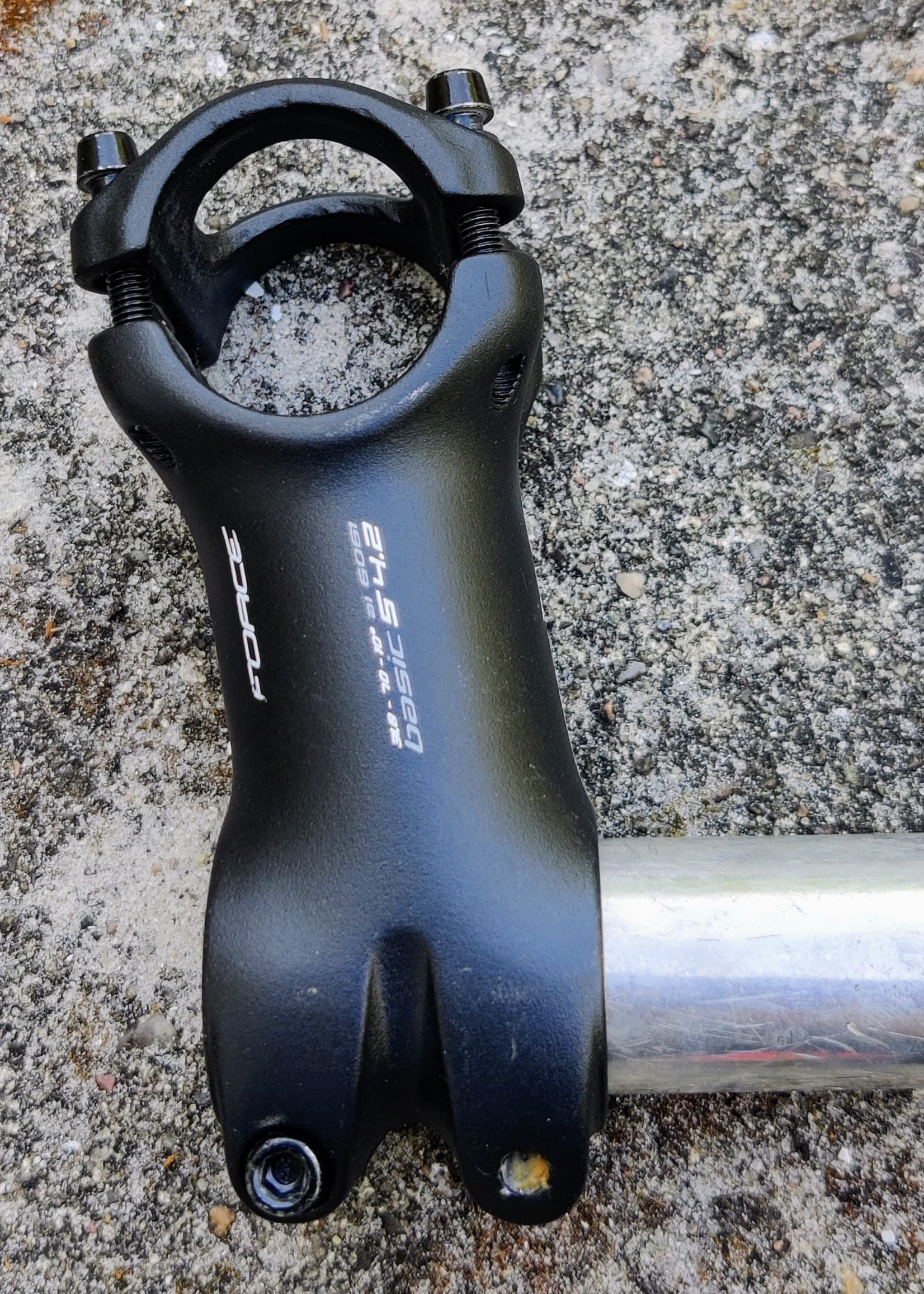

The important part in this setup is the 180 degree bike stem connecting the seat post to any tube of 28.6mm (or smaller with a shim). The rest is just about creativity.

Is the inner bore of the 180 stem 28.6mm throughout? Or only for the clamped section near the end?
Unfortunately a 28.6mm tube cannot be inserted further than the clamped section.

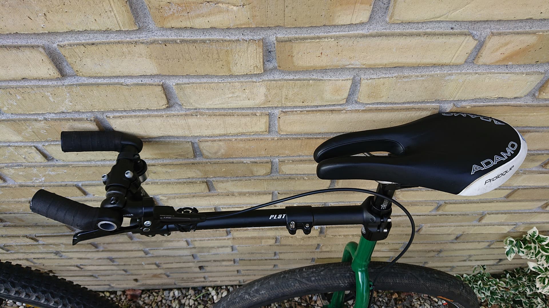

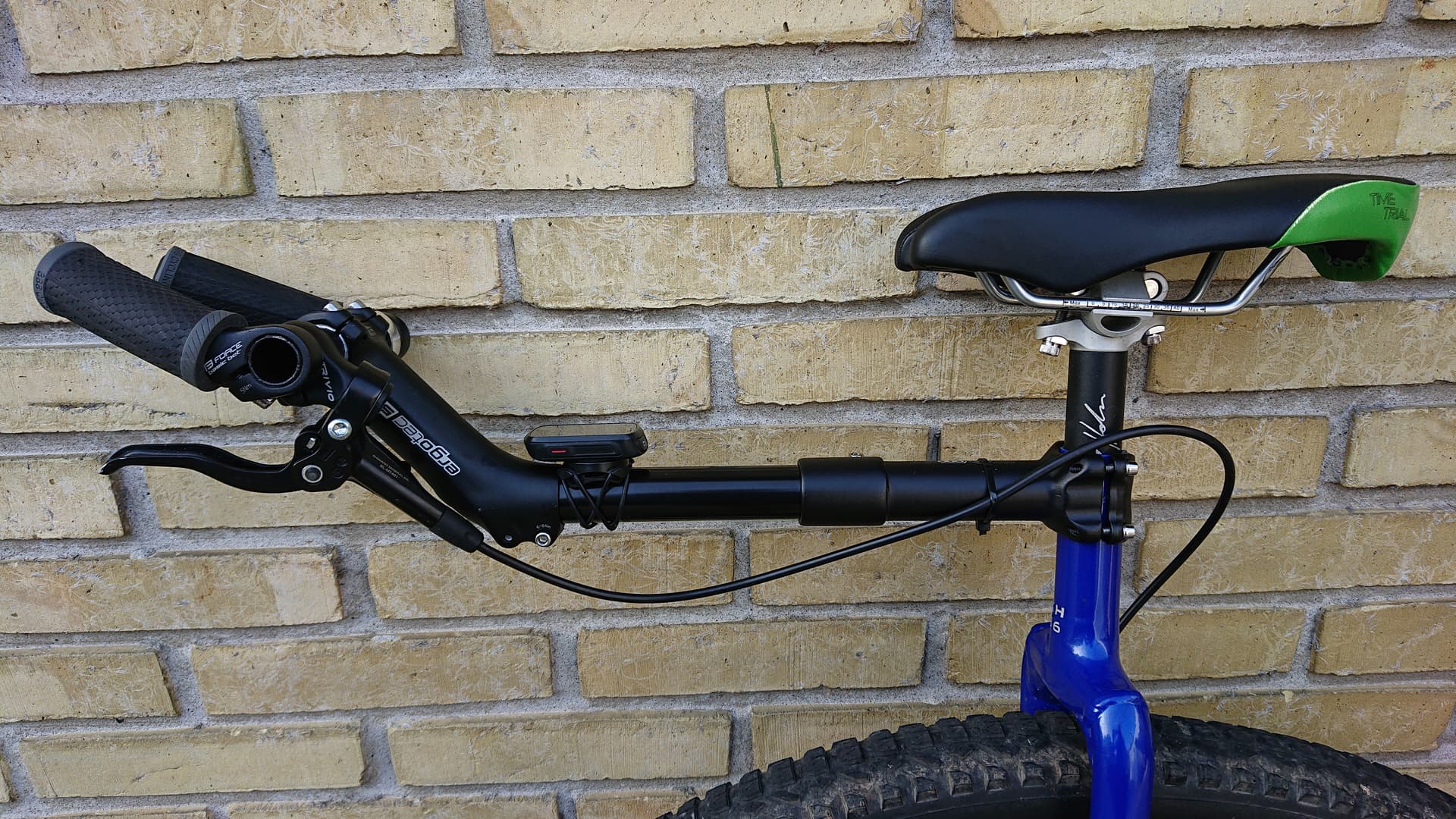

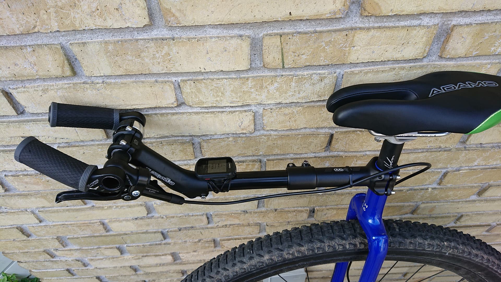

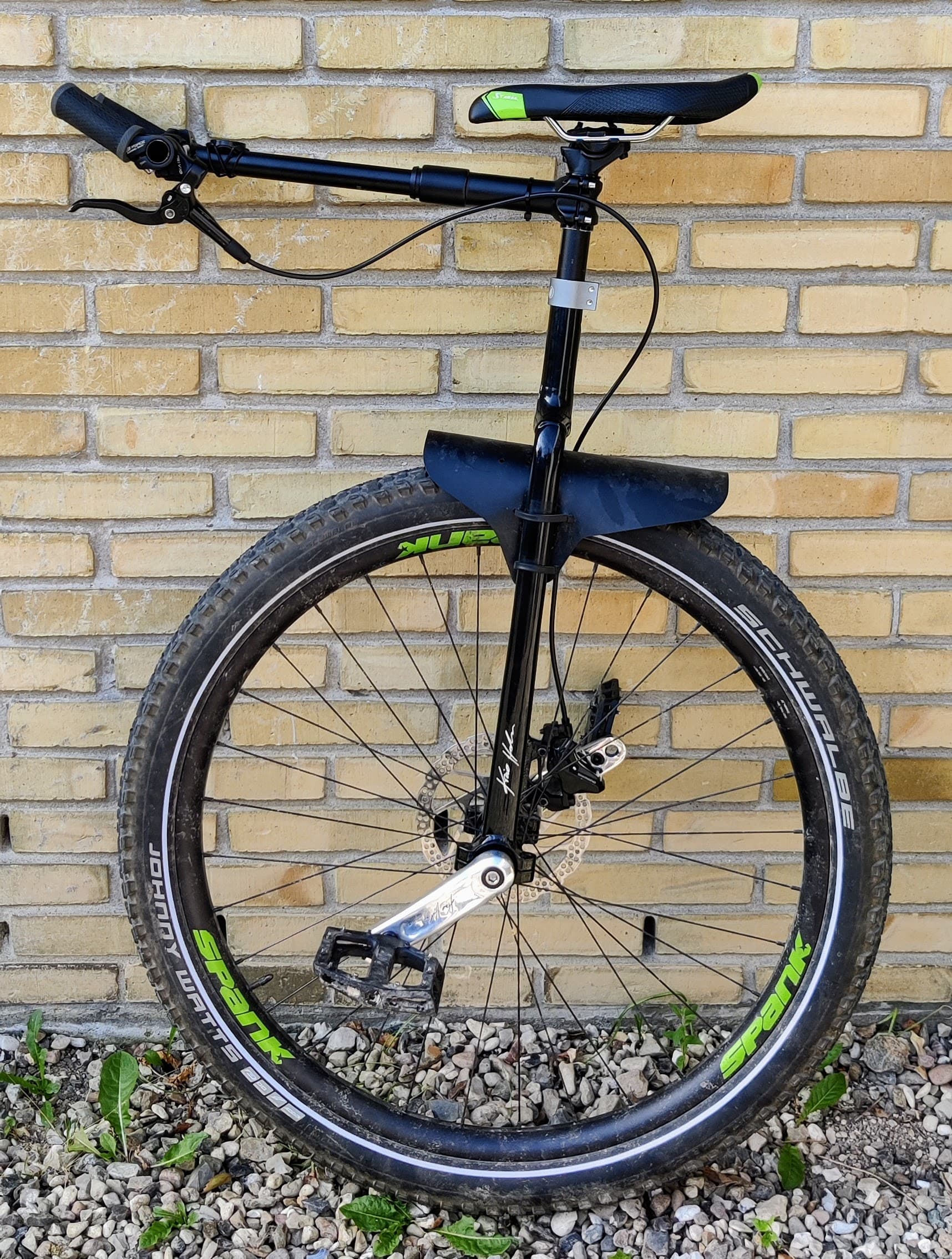

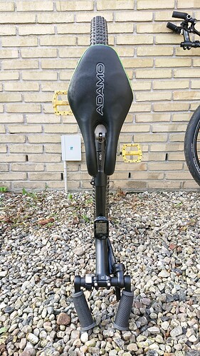

Just a few pictures of two other handlebar setups build using my previous ideas described a few posts above. They are slightly less aggressive than my first build and by moving the 180 degree bike stem downwards / away from the saddle I also experience less rubbing of the bar from my legs.
I love it!
Do you use a stem for 25.4mm handlebars, a 22.2/25.4 shimmer and a 22.2mm tube?
How do you feel your new setup compared to the old one with the M4O handlesaddle base?
I feel that the handlesaddle base, which is 7 cm wide in front of the saddle, can be a useful support with the thighs when mounting or idling. On the other hand, when riding, it’s a source of friction for the thighs.
