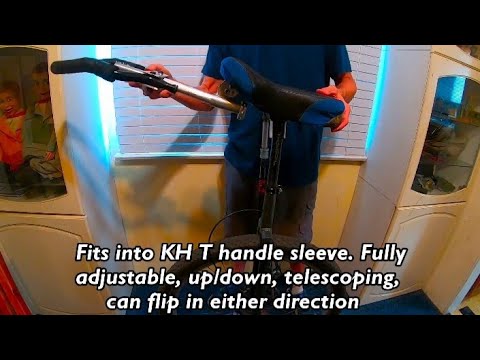

I just used some cheap aerobars like this:
I cut off 1 inch behind bolt holes, then made two aluminum plates 1/8in thick and 7/8" tubing to go between areobars and held in place with the plates. Then it simply slides into the existing KH T handle sleeve. Another option would be to leave the aerobar intact if you wanted a place to rest your elbows.
Innovation Terry, I love it. This is great!

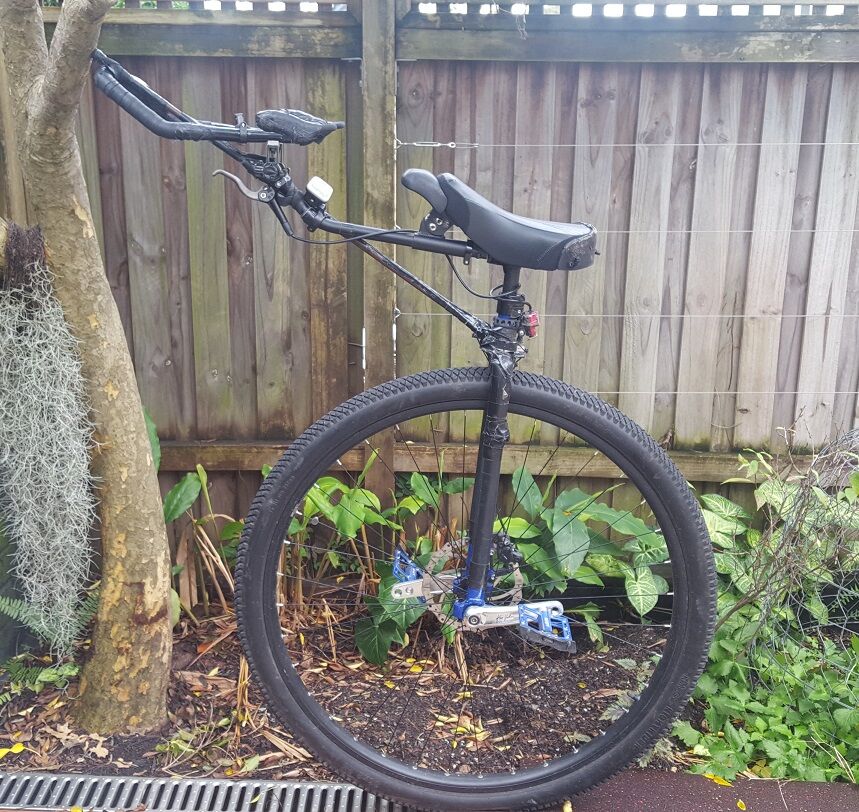

Thanks to Gockie, I got the same Aerobars and have had them on my KH36 from day one learning to ride it.
After a couple of months trying to commute to work, 13.5km (8 miles) away, I am now riding to work with 125mm cranks 3 times a week, working from home Tues and Thu. I couldn’t think of riding without the aerobars.
Notice the bike computer which is in a place I cant read the screen because the cable to the sensor is too short. If I could read it, I would know my RPM.
Because I always wear Leatt 3DF body protector with elbow pads, I found I could get rid of the aerobar elbow rests, which gets my position lower and can adjust elbow location (for road camber). Eventually, I’ll get the Profile T2s, but they are a bit pricey.
Apologies, the tape, rubber and cable ties is not pretty, I’m still looking for a support bar and connection collar to the frame.

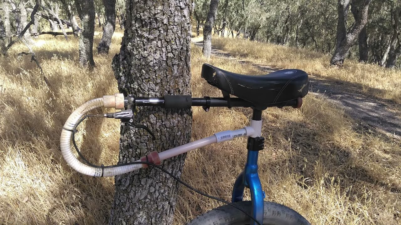

@Saintbroken and @Unigoof were asking me questions about my handle so I made a video about it to update this thread after the original discussion here from June to August 2018:

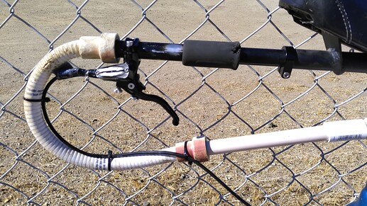

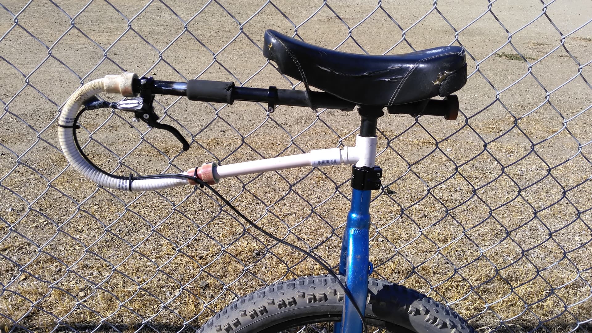

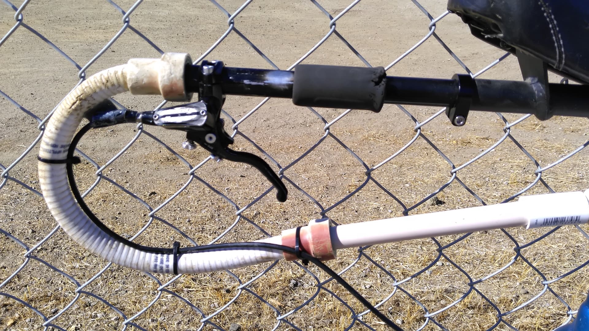

I wanted to post an update to this. On my first attempted ride this week I discovered I had forgotten to deflate the tire and it exploded in the back of my car. I replaced the tube and tire and then on my next ride my brake hose finally broke. I’m not sure if it was because the hose is too short and flexed too much or if it suffered from impacts (or a combination of both). For the adjustments I moved the handle to a different (Mad4One) frame. I added a little bit of length to the PVC pipe on the bottom. I realized the hose is actually the same length so I would have the same issue. Ideally it would be a few inches longer so I could run it up the frame better (without this necessary shortcut), but I added a couple zip ties to try to reduce the tension on where it connects to the brake lever. The housing for the hose is pulled away a bit so I added some Gorilla tape but I need to look up to see what would be better to protect the tube inside.

Hi Waaalrus,
I don’t know if this would be counter-productive, but try turning the brake lever around and placing the mount behind the grip and the lever facing forward, you might then have enough brake line. ? or just put a 90 degree brake fitting at the line coming out of the lever, anyway I like that frame, it is so well put together in your set up.
LobbyBopster
Do you know any 90° fittings that fit on shimano brake lines?

The reverse brake lever technique that everyone uses seems super weird to me. I don’t know how people get leverage to pull up on the handle or manage to not crush their fingers. The 90 degree fitting sounds interesting but I would rip out the cable inside a week. I have some pretty hard UPDs and the handle has a tendency to twist in loose terrain. I’ve hit my knee a bunch of times with my handle as minimal and narrow as it is. My new wheel is only a couple weeks old and I’ve already knocked it out of true and tension.
P.S. I figured I might as well link to part 2 of my handle video.
I have purchased mine at my local bike (unicycle part supply) store, and several off of ebay. I even got one to fit my old coda brake lever off ebay. It will help to know the threads on the existing fitting, but most are already waiting there for you.

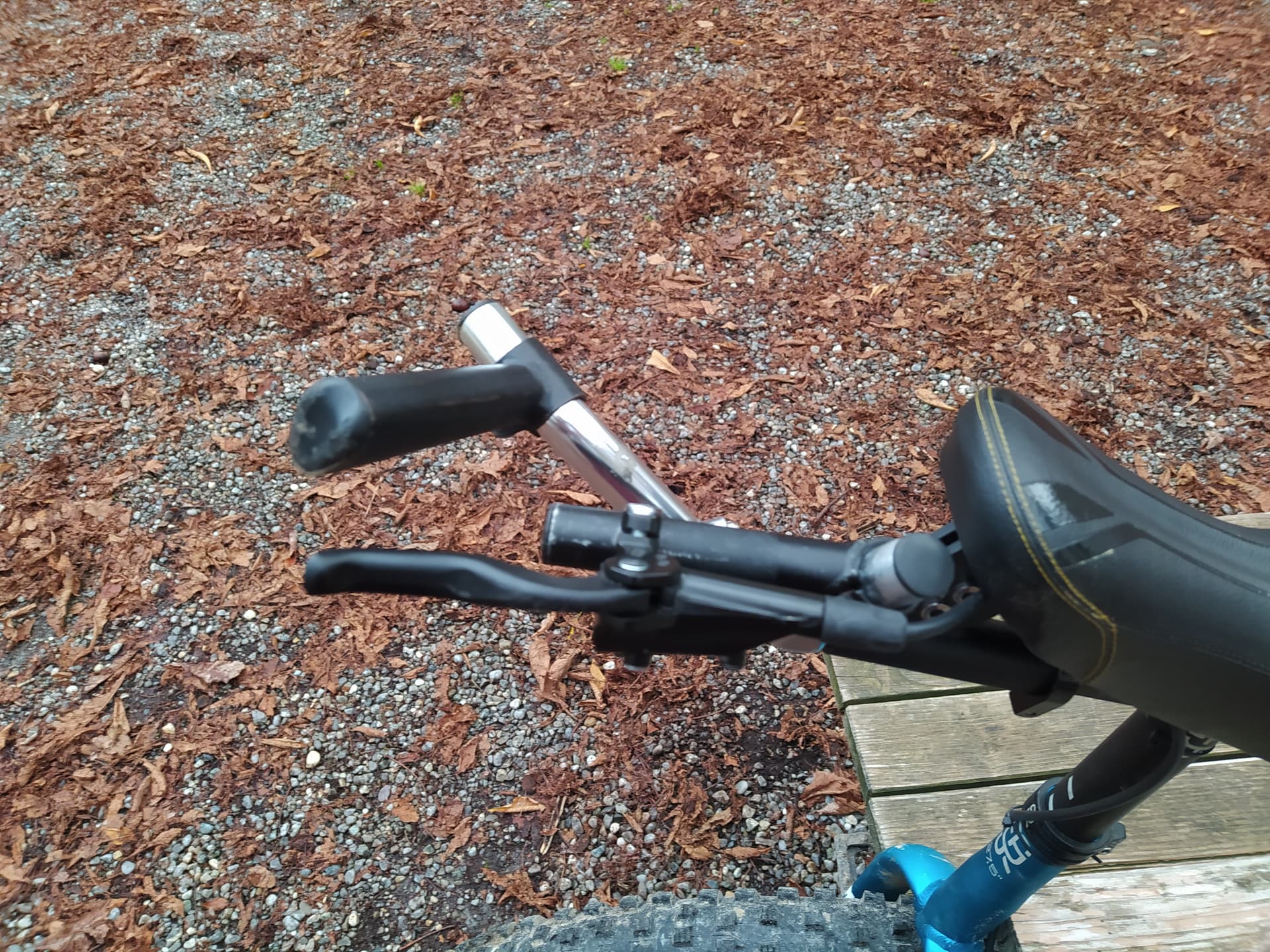

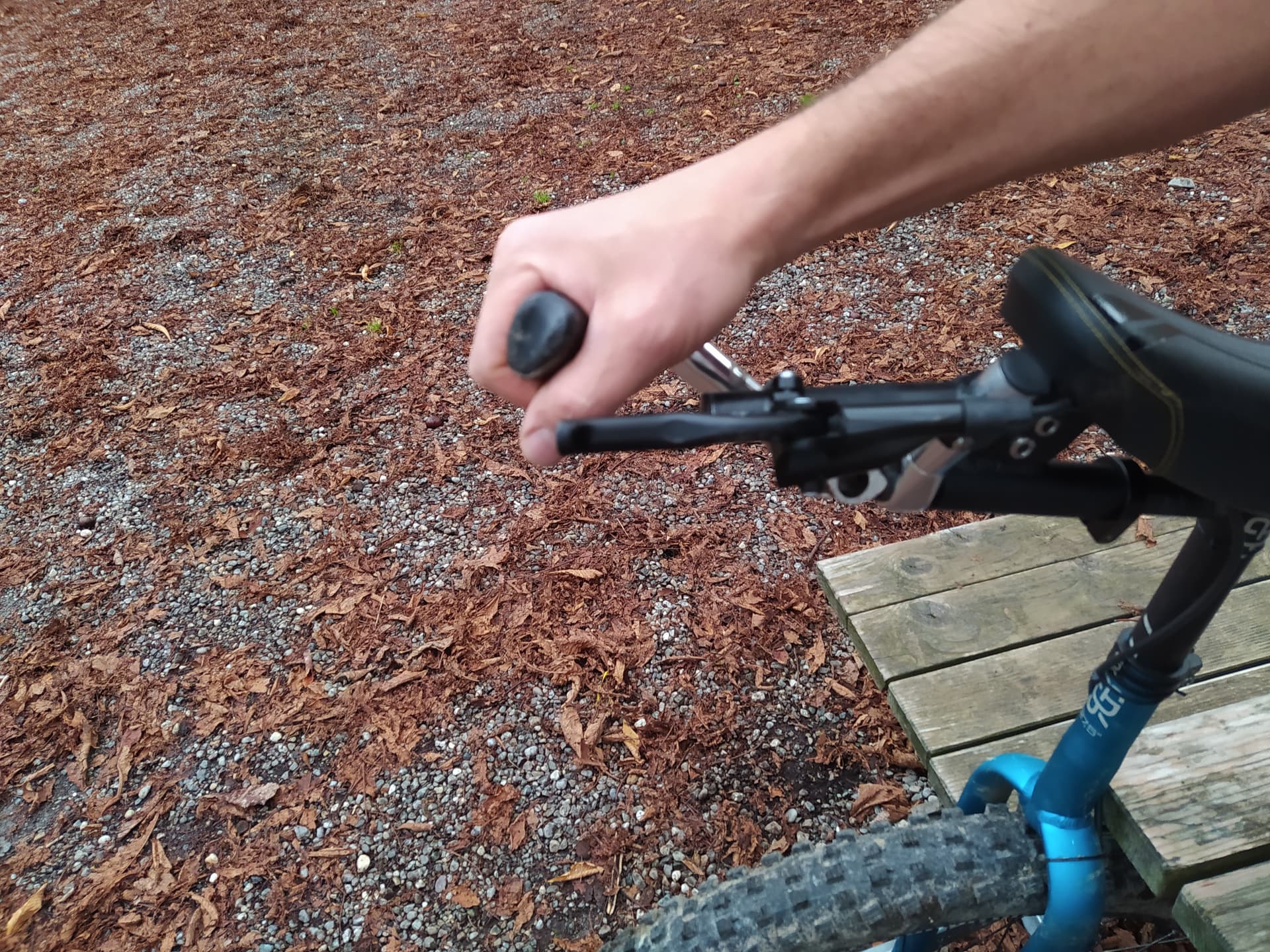

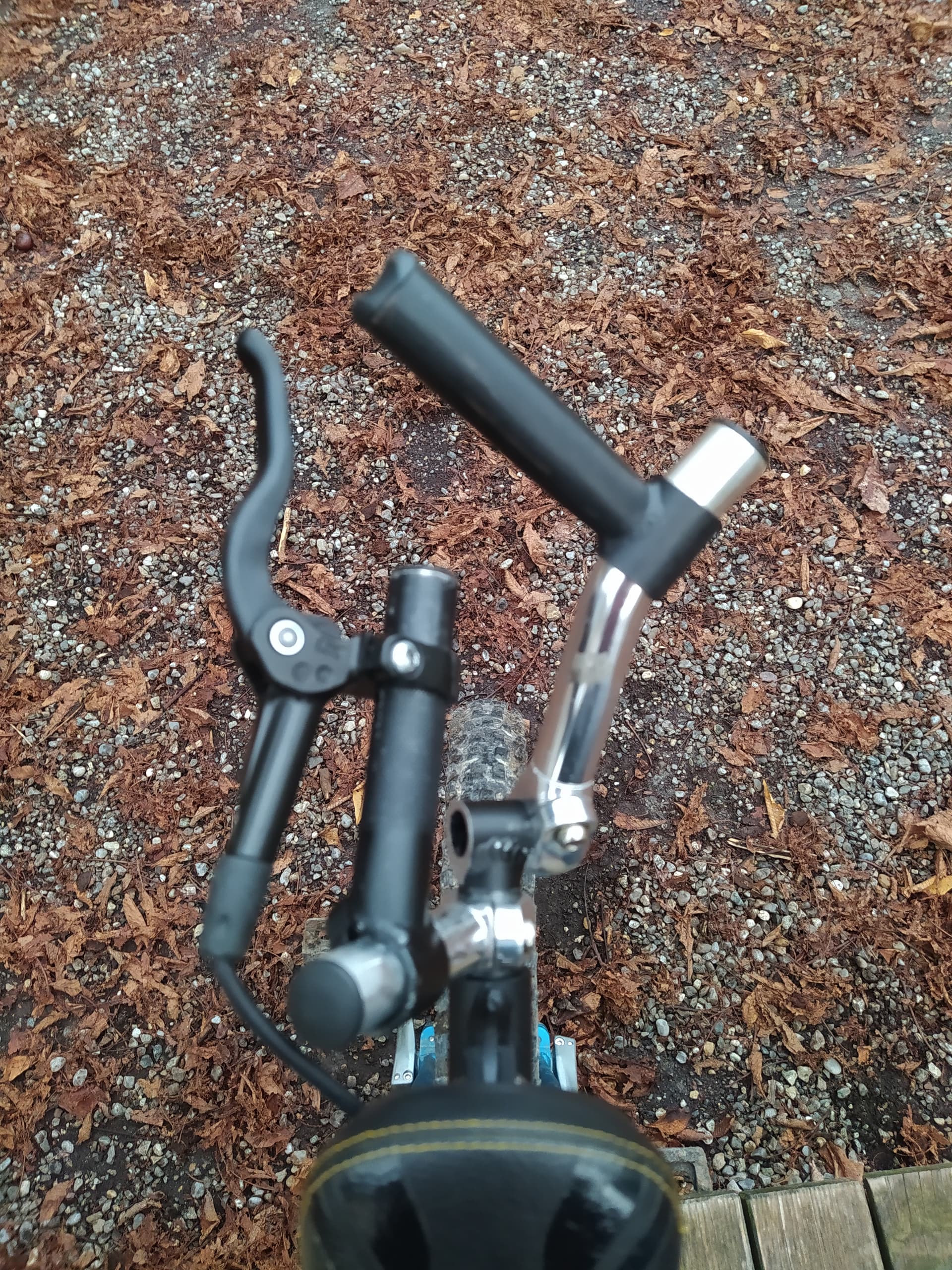

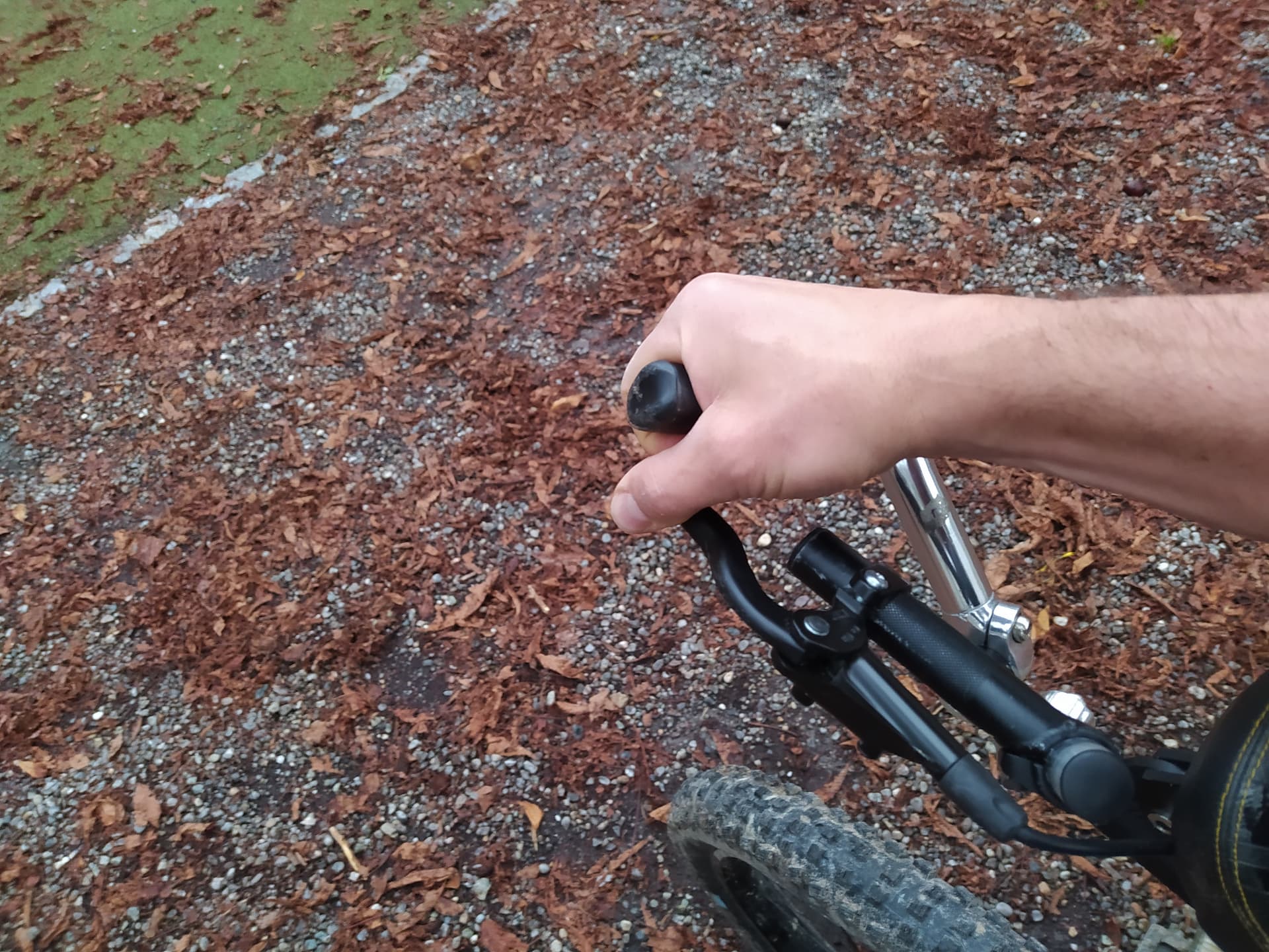

Update:

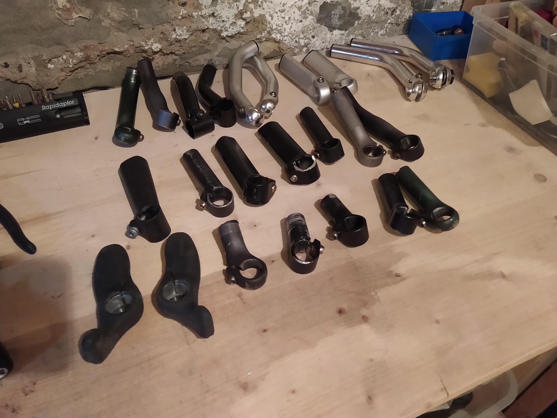

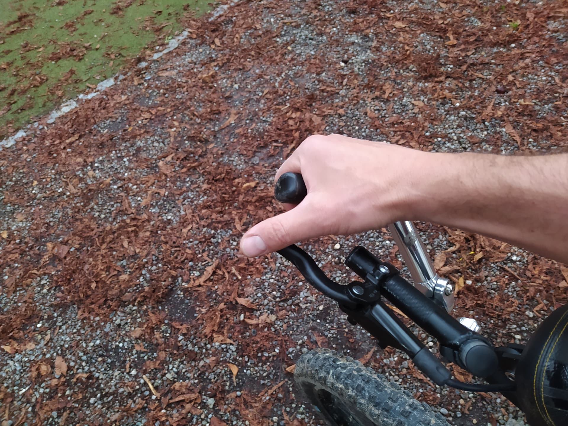

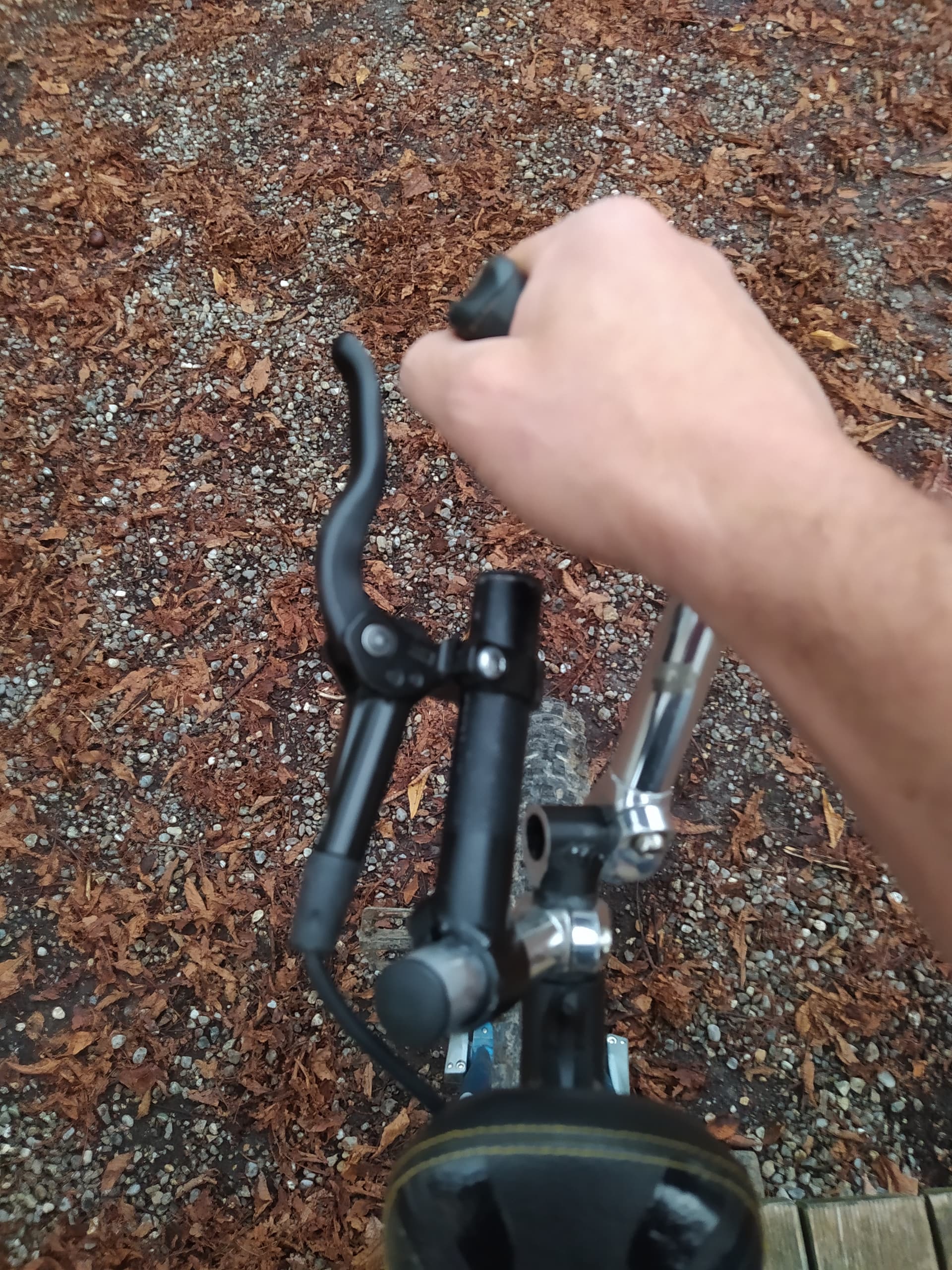

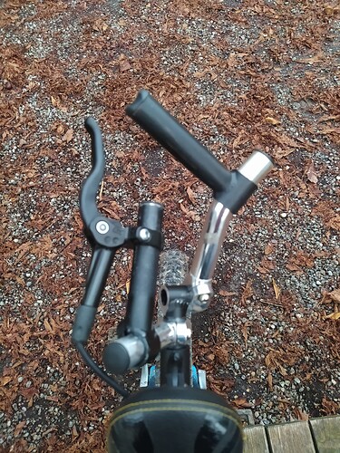

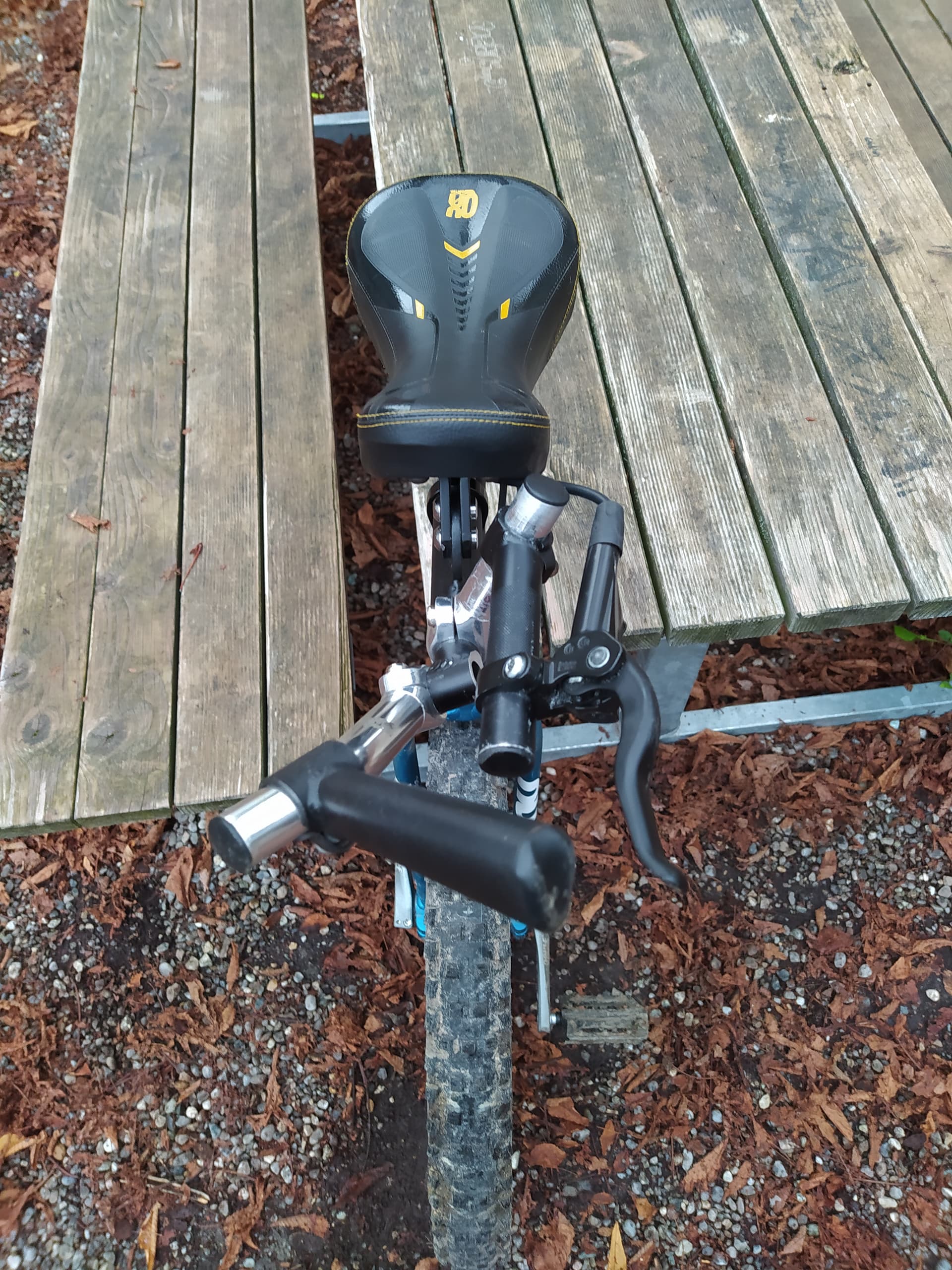

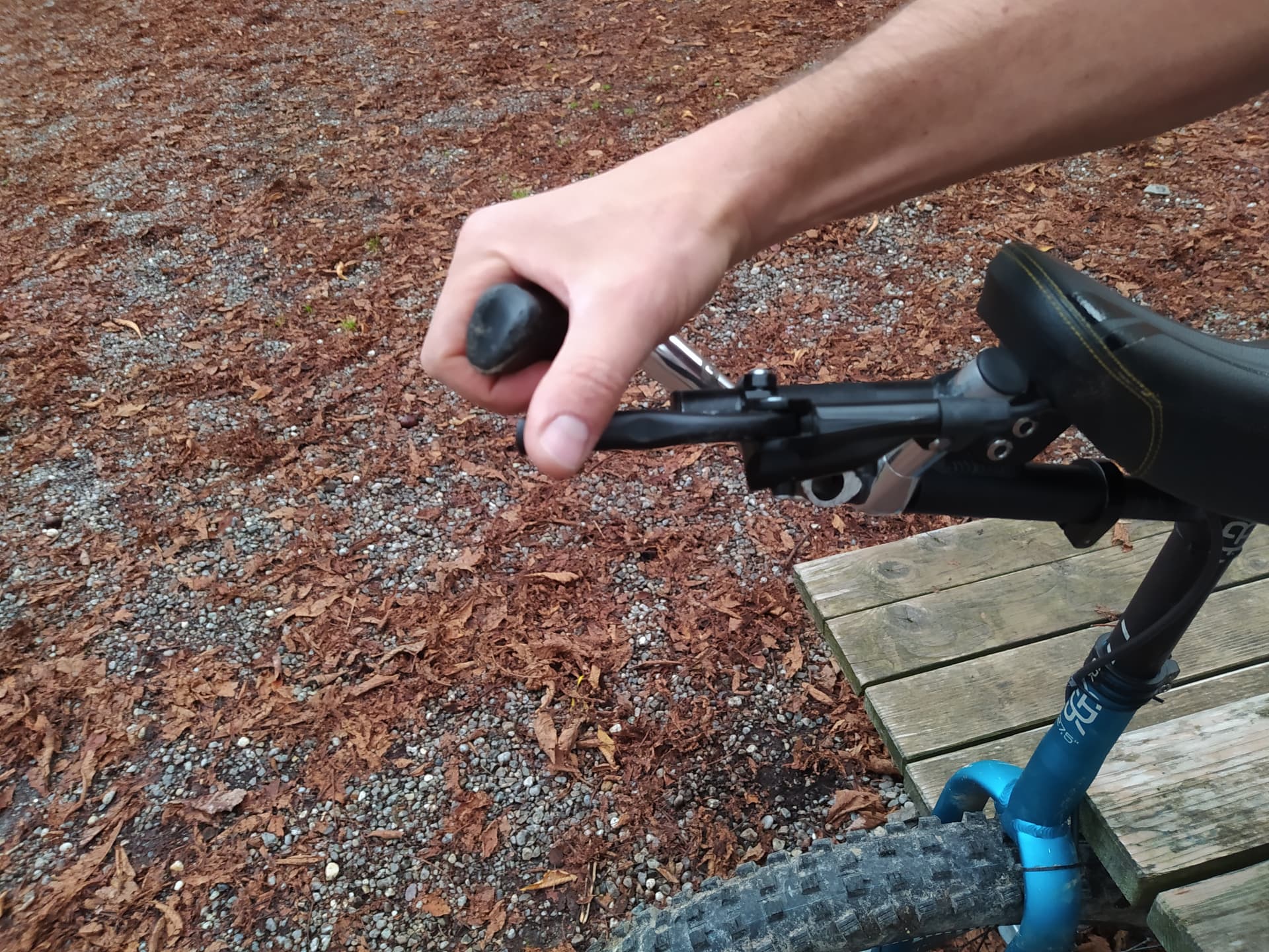

with a bunch of used bar ends and some cutting and readjusting I went today for my first ride with the brake in position for the thumb. I’m not yet satisfied with the setup, I need to visit the bike-shop for more material to experiment with, but in general it worked.
When I have a solution I’m ok with pictures will come.
My idea is to ride like this for maybe a month or two, so I will get used to this, and then change back to normal braking position to see what it will feel like in comparison.
I`m planning to move the grip closer to the saddle, but so far this is a setup I like to ride, with the material I have. It’s quite a puzzle with those bar ends and their odd angles and shapings to place things the way you want them to …

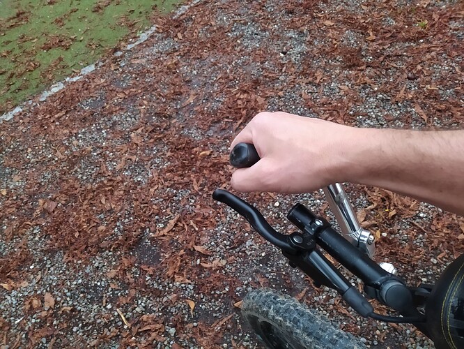

Odd looking but the picture showing you operating the brake makes sense
I wonder why you feel the need to use the “one” thumb that allows you to grip very solid to the handle instead of using one of the “four” (or more) fingers to operate the brake while your opposing thumb is left to do what it’s best at?
I can brake with any one or several of my four fingers with absolute control all while maintaining a solid grip on the handle.
While braking with your thumb, your grip is surely compromised.
I don’t get it.
Well, I’m not even near having absolute control, so I go for every help (or imagination of) I can find :smile:
Why I started this?
  • because I had the thought and wanted to know what it would be like
  • because at the moment for me it feels like gripping the bar for ride-control and working the lever with any of my 4 fingers for brake-control are conflicting activities. For the last months I felt somewhat stressed by this and found that for the practice I had the progress seemed little, so I would like to try a different approach.
Thanks for the comment about thumb braking and grip strength !
Made me think more into detail on that. To distinguish between base joint + the meaty part, wanting to optimise grip-design so this can maintain a firm hold on one side, and middle and distant joint to move for the brake lever. So I will keep that in mind when positioning the brake or thinking about other types of brake levers.
