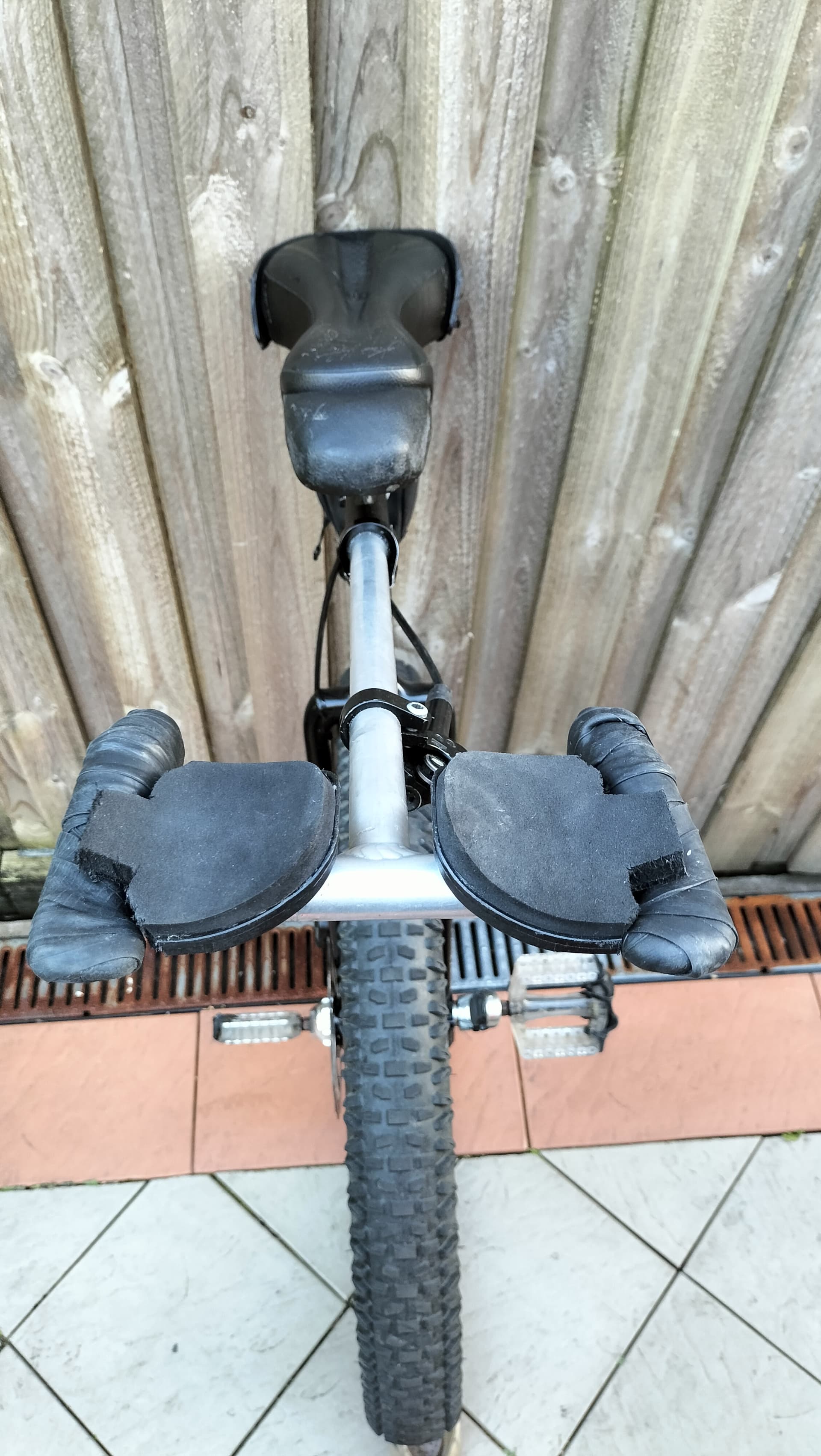

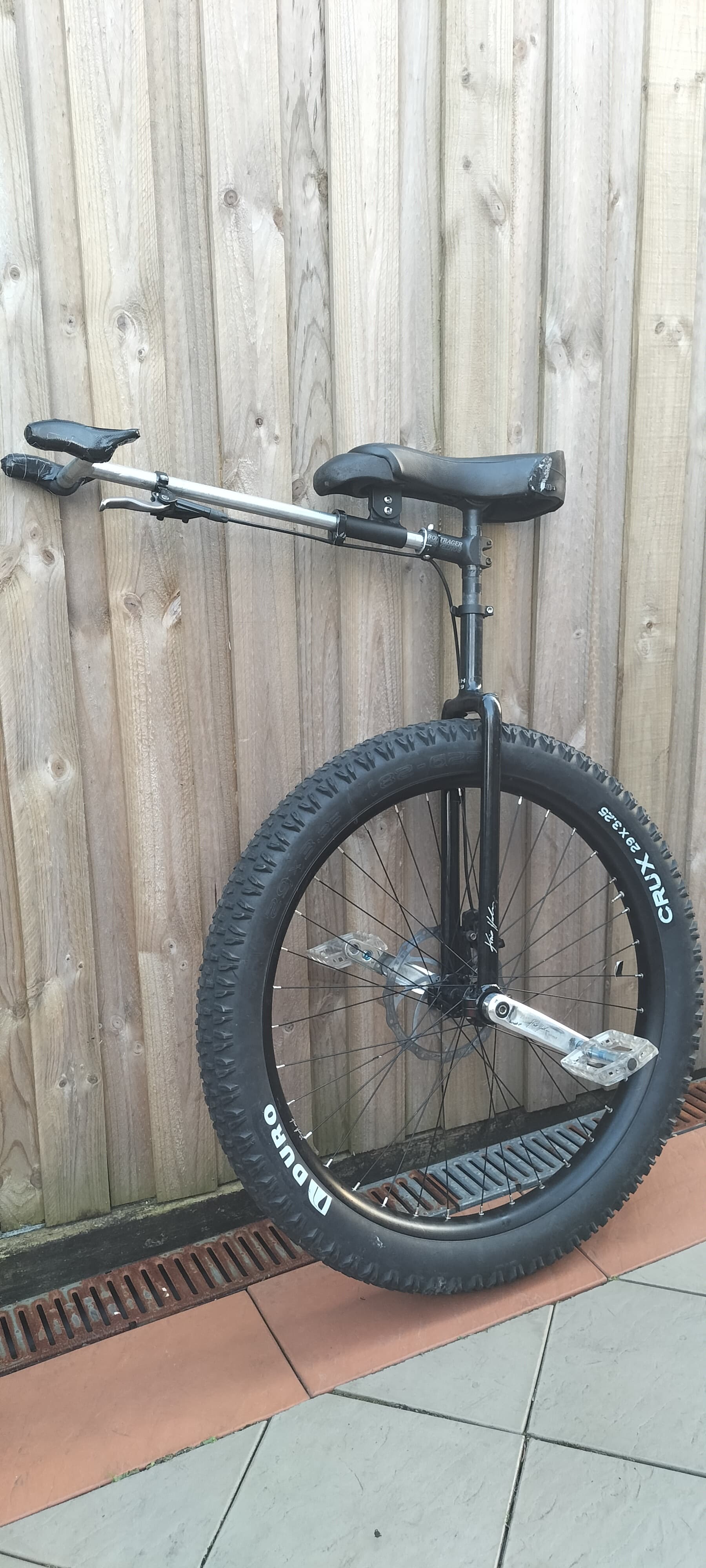

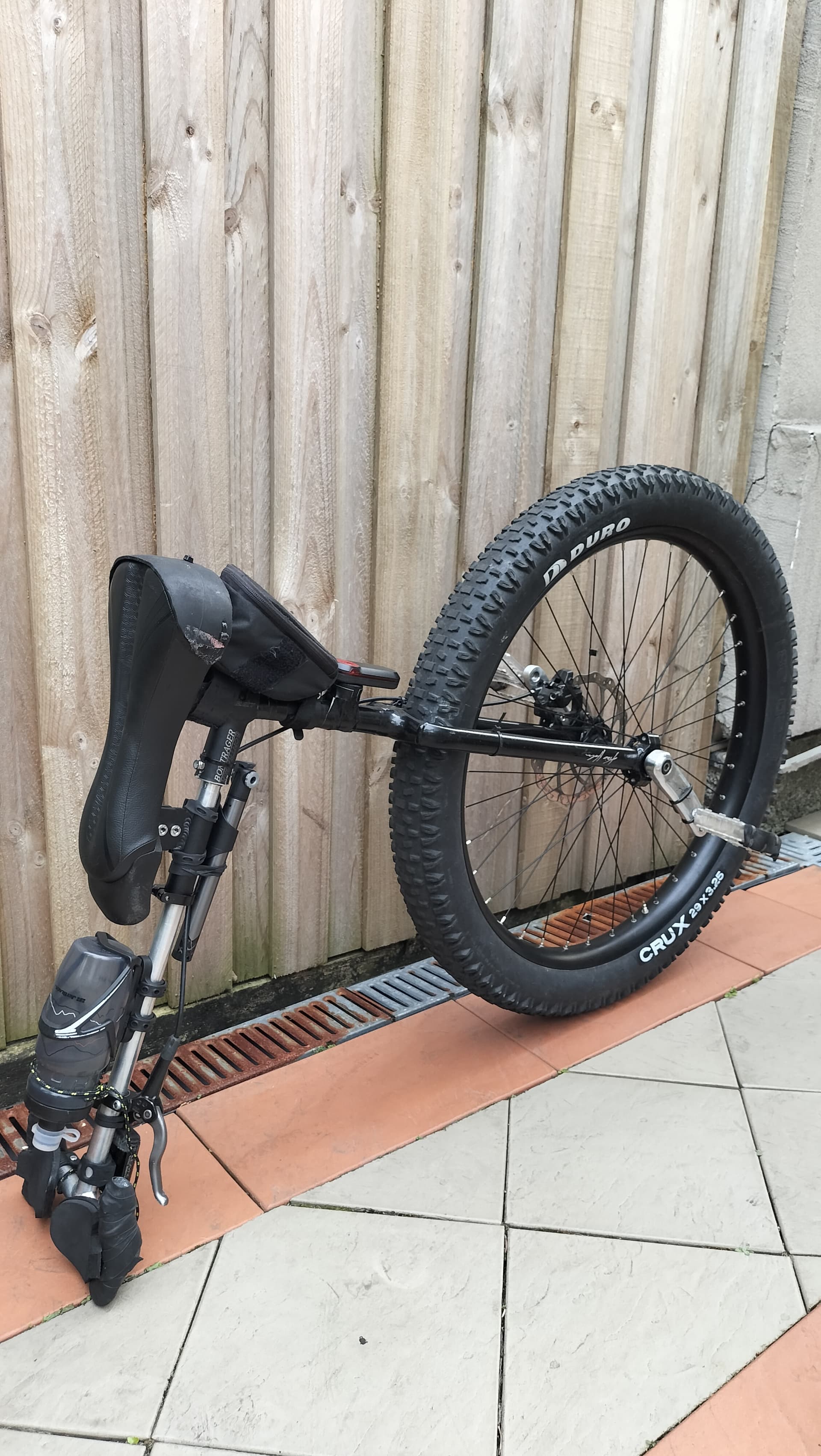

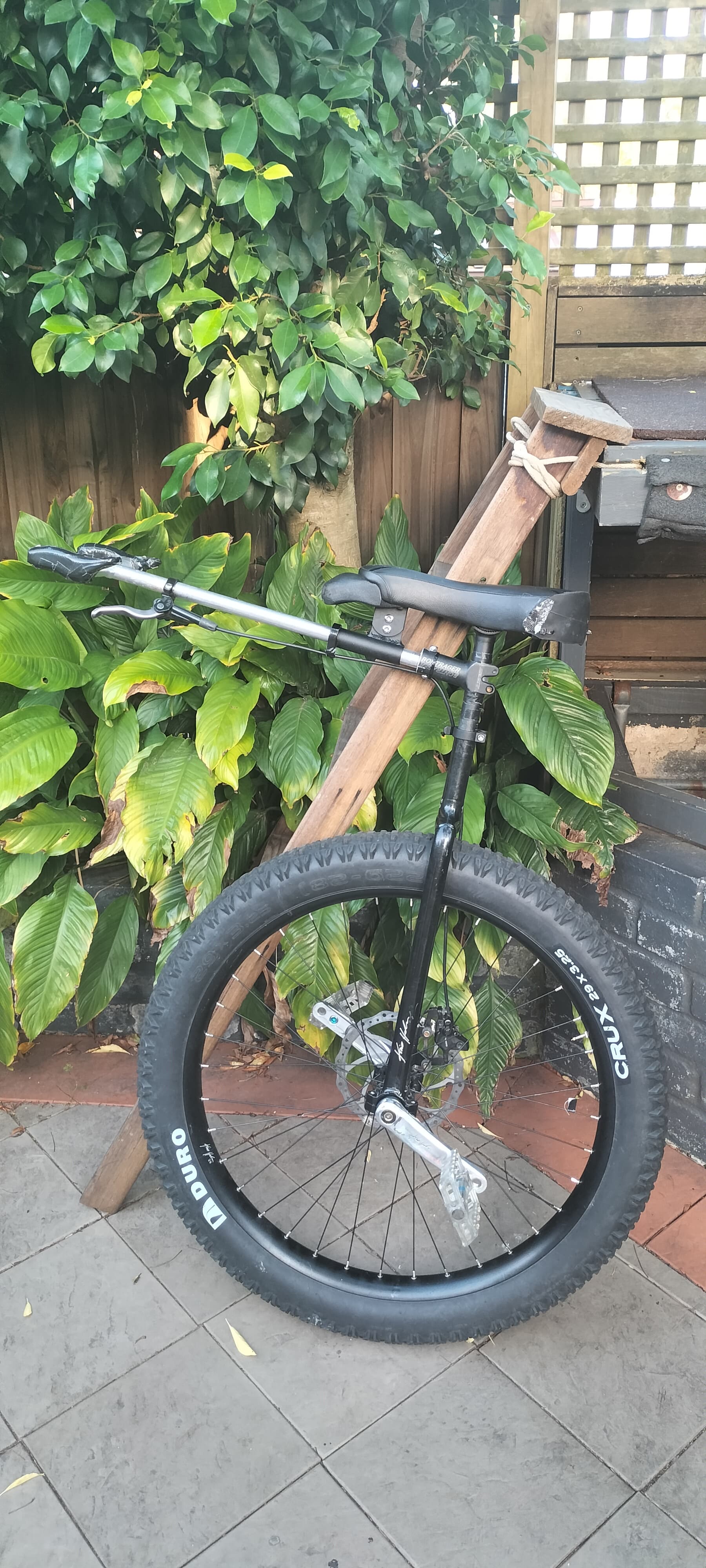

Anyways the T Bar I got custom made by Jakob of Flansberrium. 250mm X 520mm
The attachment to seatpost is home made from a MTB handlebar stem. The angle is just right.
I can also rest my padded elbows on the handles for aero position with hands out front. Not unlike what road cyclist do.
Man you’ve got some long arms.
Found an image of Unicyc. He does indeed have long arms.
I rest my forearms on the tee in normal riding position. It’s quite comfortable cruising, allowing minimal weight on the seat.
And am trialling the end handles in helping to hill climb. Helps with the lean forwards. I found it enables a nice sustainable position on 5% hill. Might turn the handles 180° to be a bit closer for the hills over 5%.

Another pic of Handle Bars
I find them really effective for hill climbing.

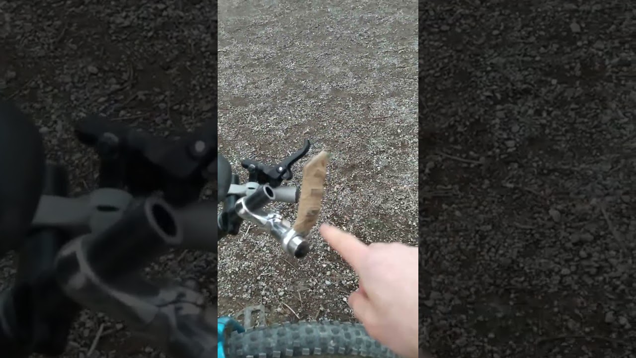

I worked out a setup to brake with my thumb
