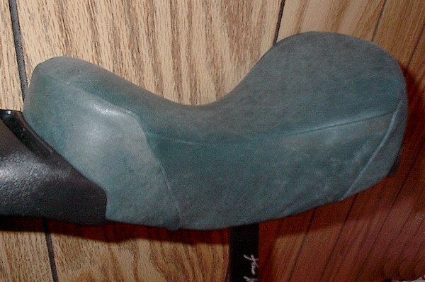

Leather coat, a lot of time, and creativity = A durable saddle cover.

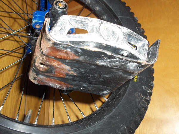

scrap metal, 5 minutes of hammering, 2 minutes of drilling = A easy grind plate

Customizing your seat is a good place to start experimenting with upgrades. Assuming that you are not happy with the available stock seats.

A simple alluminum grind plate:

an easy way to get the pattern for a seat cover is to take of your cover, rip the seams, trace onto some other fabric, cut and sew.
