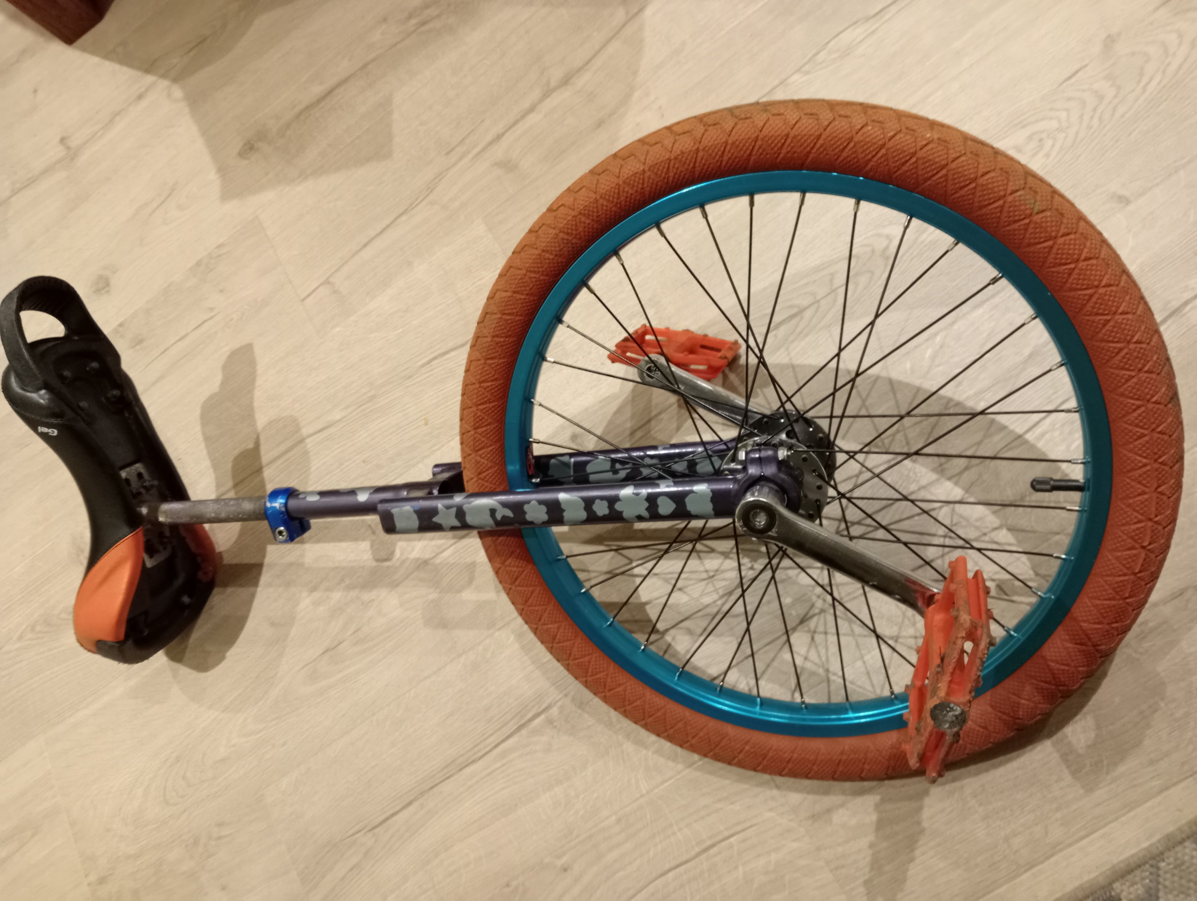

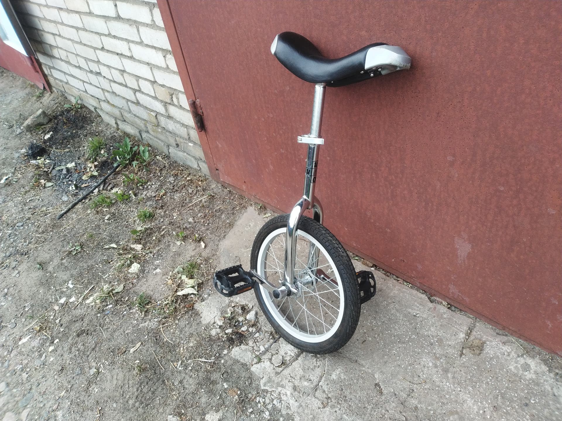

CL find

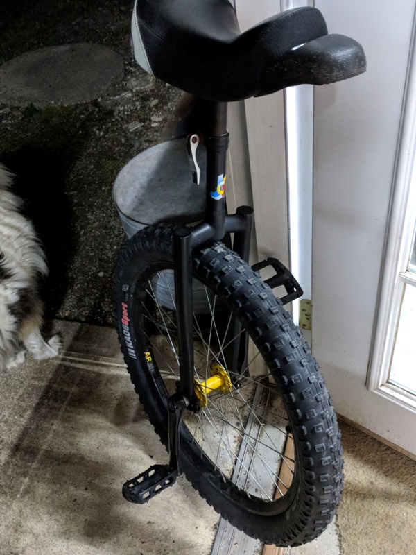

new tire and pedals on 24" of unknown origin. has isis 170mm cranks.
total noob here BTW.
What is it like without the handle? Dont you need the whider seat to keep control? (or controll?..naa, control looks more common.. :smiley: )

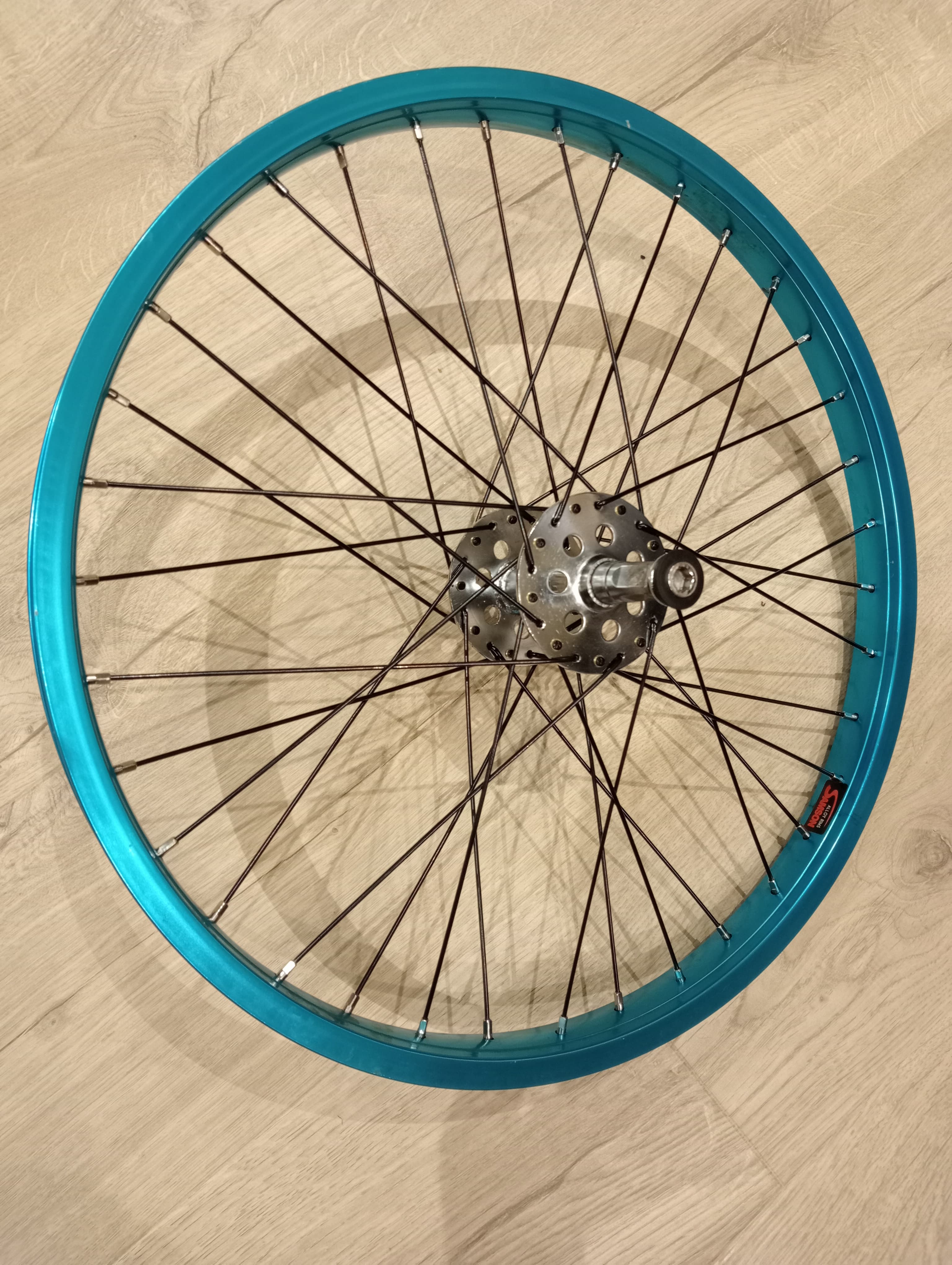

laced a wheel!
was easier than expected. used guide on Brit UDC website.

Just curious, what are you intending to do with this unicycle? The cranks say Flatland, but the tire says Freestyle..
nothing special. built from parts off ebay and UDC. wanted to learn to build
wheels for my super motard.
Fatty Disc
With Surly Nate 26x 3.8
I think the control goes through pedals, meanwhile slim saddle gives more possibility for stiring unicycle between legs and you will value it if you try. The handle make the mount easier and lets to stay on legs in moving, but is not mandarory for common riding. This is video example, where I use bicycle saddle without any addition handle and without problems.

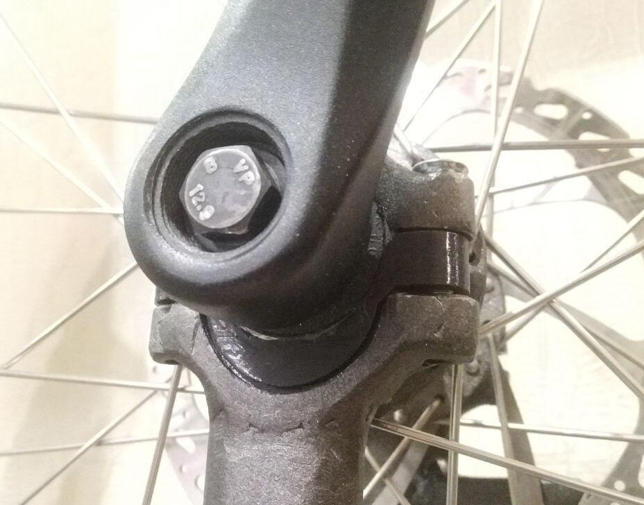

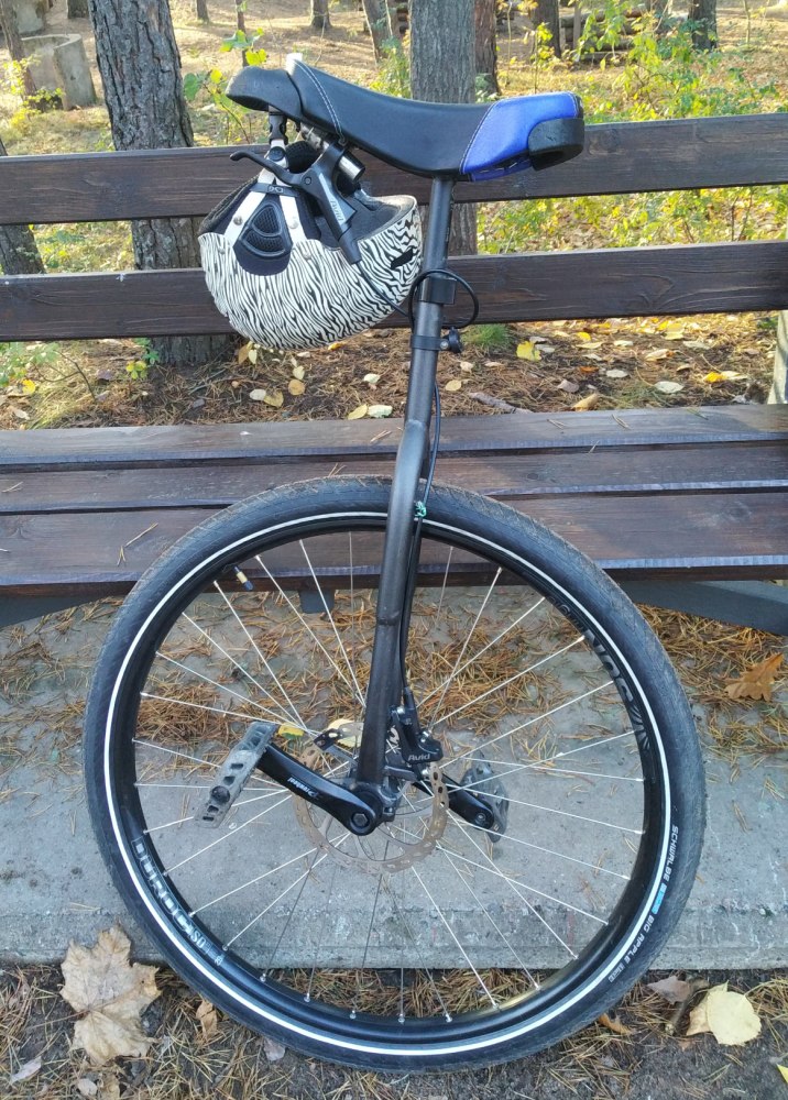

Started this project before i learned how to riding. Finished after half a year, after buying 3 unicycles, after learning. Handmade:
frame, seatpost, brake handle holder made of old bicycle
hub made of fatbike bracket.

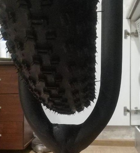

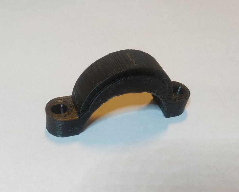

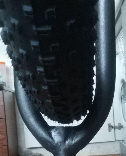

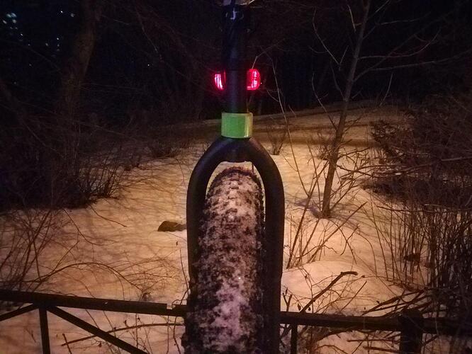

Bought new 28x3" tire. It didnt fit to my frame.
Modeled and 3dprinted 10mm spacer. Now it fits!
Unfortunately it is not possible to use the brake, but i can ride snow!

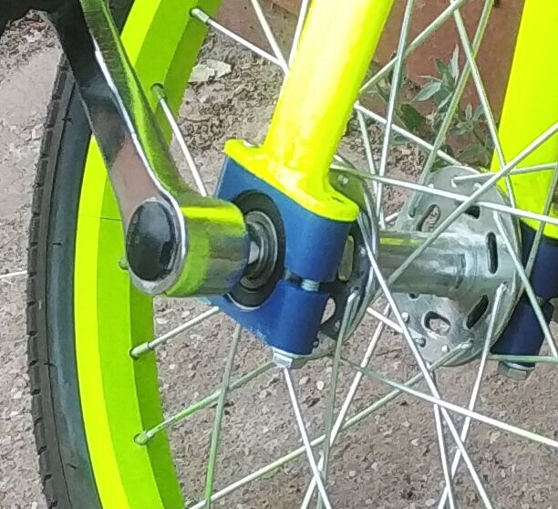

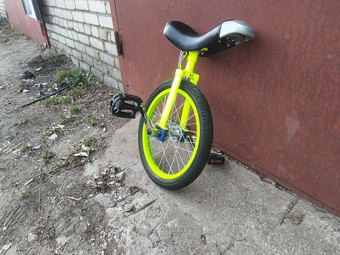

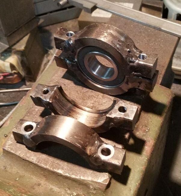

My 4 year old son said that he want ride unicycle too. Smallest uni i have is 16 “. And its too big for him. I spent a day to build new frame for 16” wheel. Hope son will be able learn uni using this.
Idea of 3d printed bearing holders was taken from video.
This is great I applaud you in this project with your son!
Great little frame! And nice colour too, for a boy of 4 - did you simply paint the rim and the new frame? Now I wish him perseverance.
Thanks. After welding, the new frame was sanded and primed. I protected the tire and the spokes with paper tape and just painted it all using an old can of paint. Looks good enough if you don’t get too close.

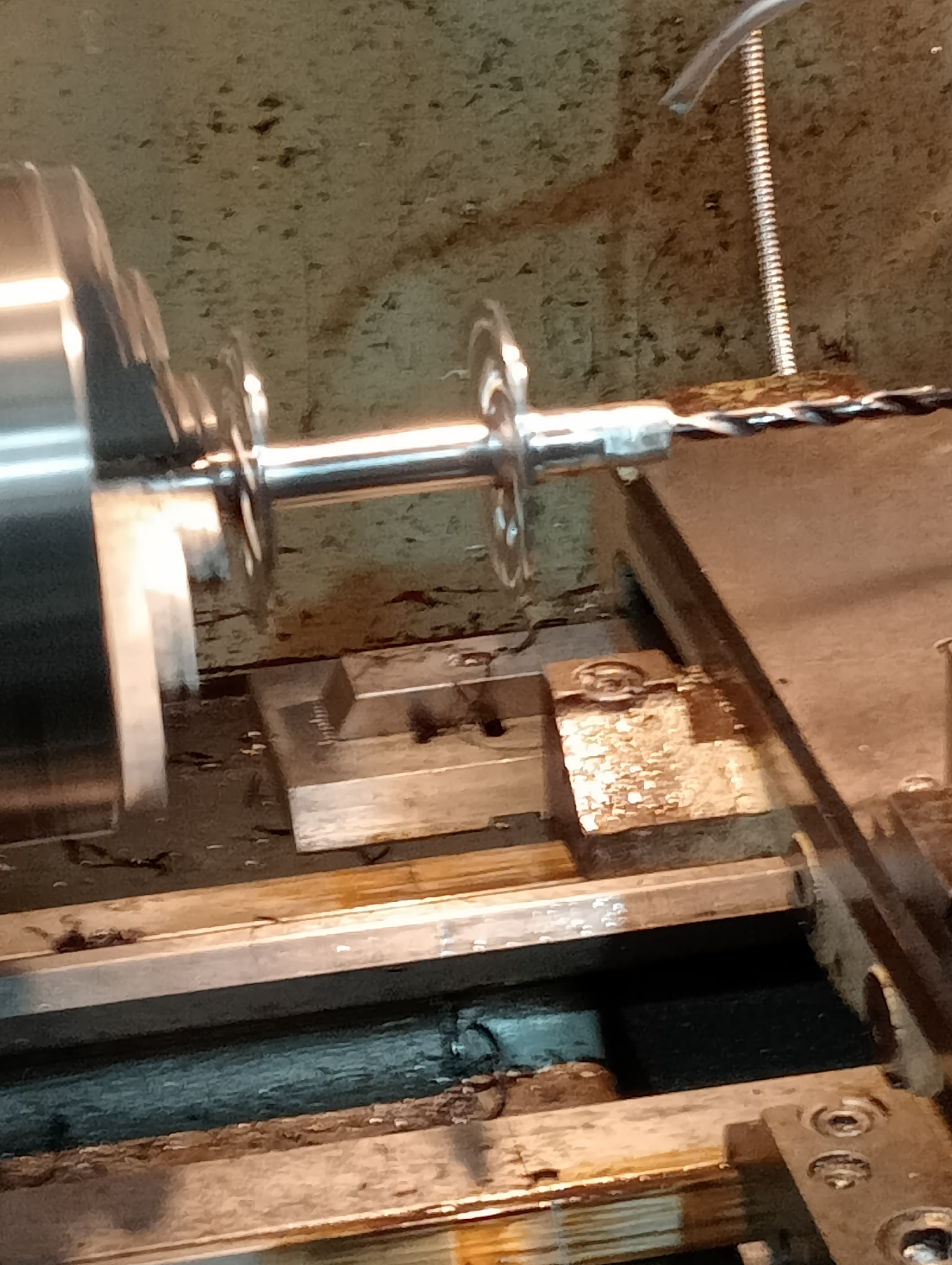

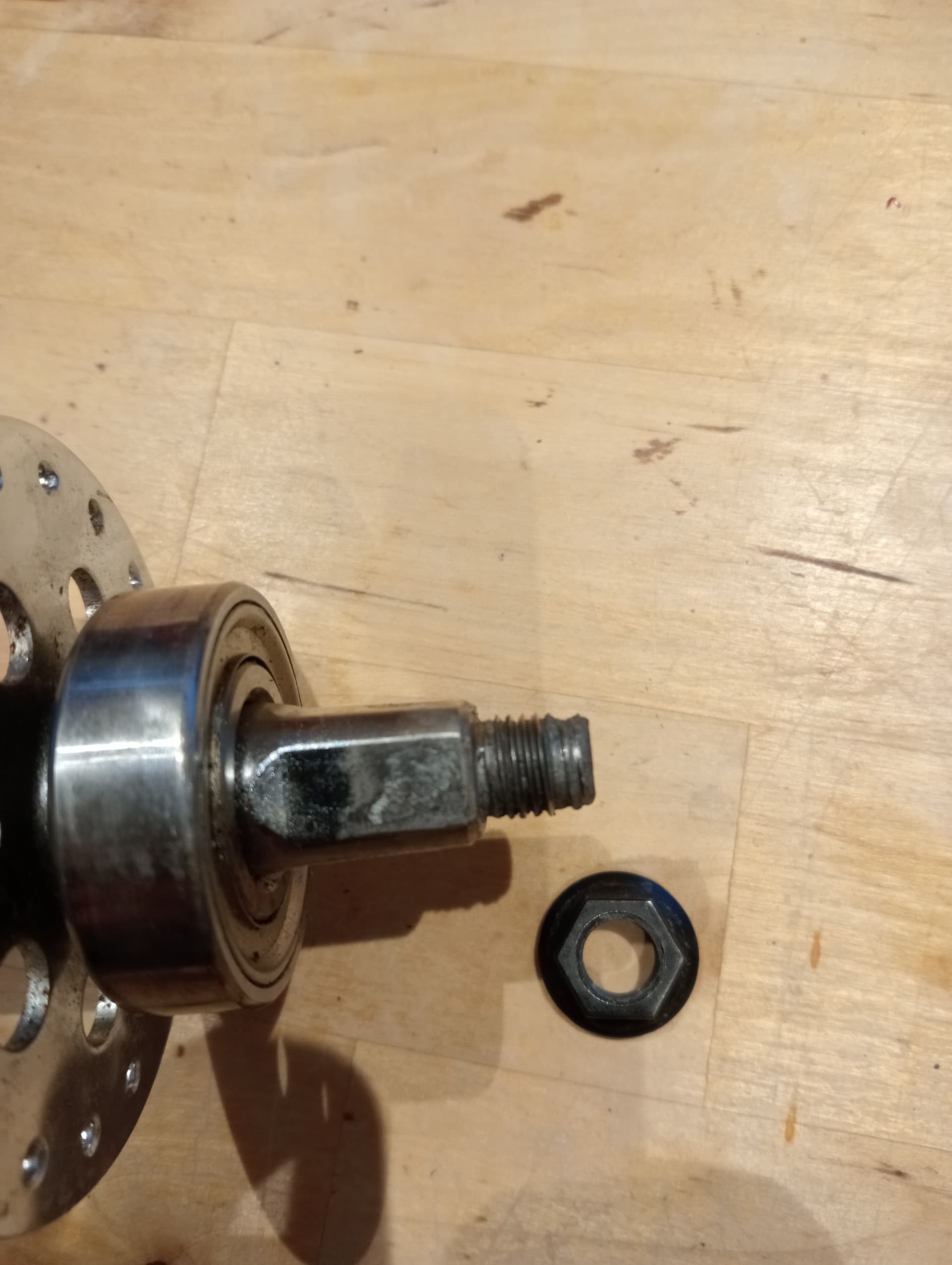

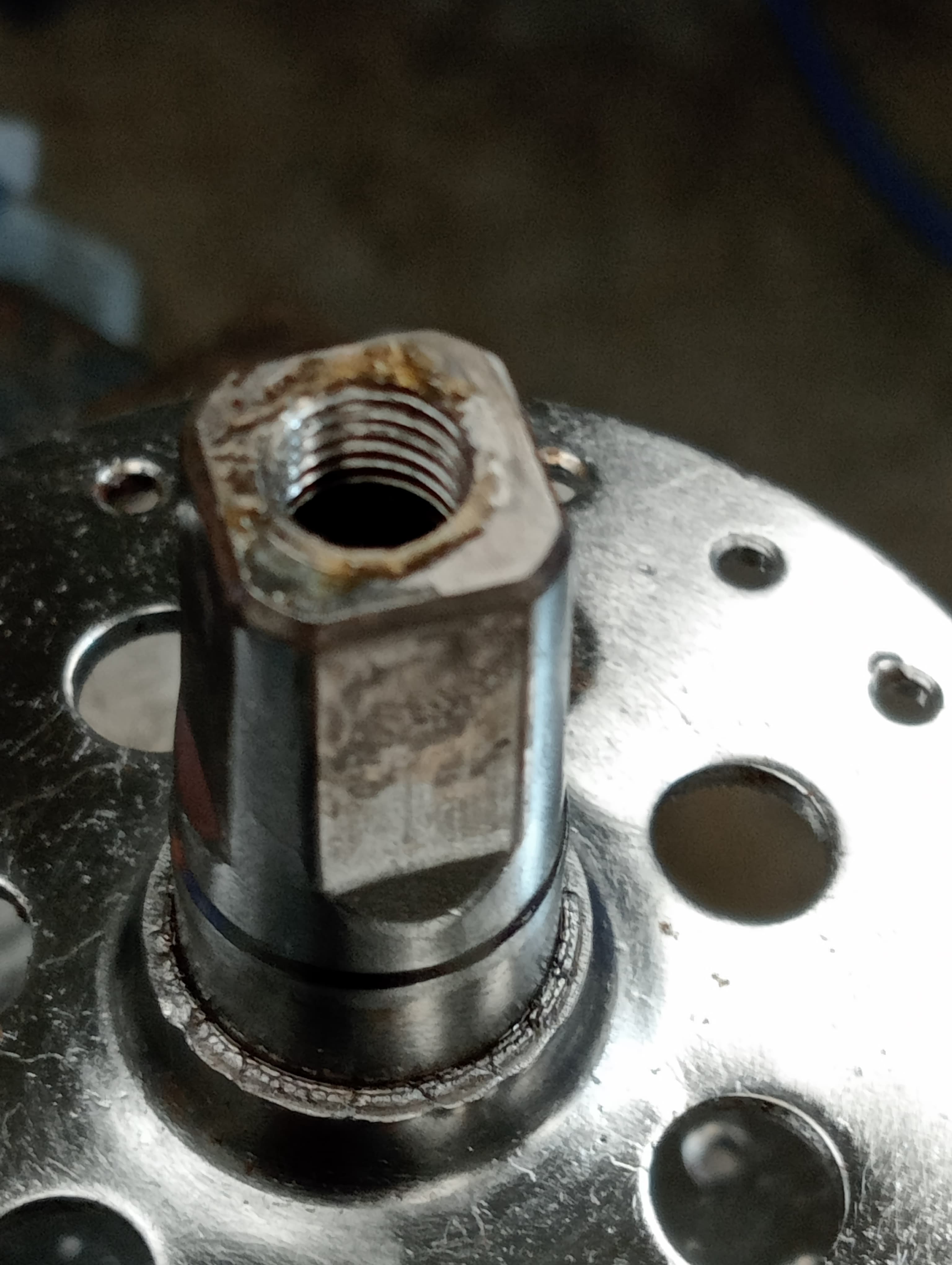

Just before Christmas I was the grateful recipient of this lovely classic Suzue hub from Uni2ONE2.
But I was concerned about the condition of the threads for the crank nut on one side. It probably would have just about pulled up but I didn’t want to store up problems for the future.
Luckily I have a friend with a fully equipped machine shop, so I decided to take the offending external threads off and drill and tap the axle internally to accept standard M8 crank bolts.
On the lathe:
Partially threaded:
Anyway, yesterday I finally completed the build. The spokes I had previously ordered to rebuild the wheel (I had been planning to clean and paint the old rusty hub) were slightly too long, so I went to town with both ferrules at the hub flange and washers under the nipples to make up the difference. This did the trick and should make for a bomb proof wheel.

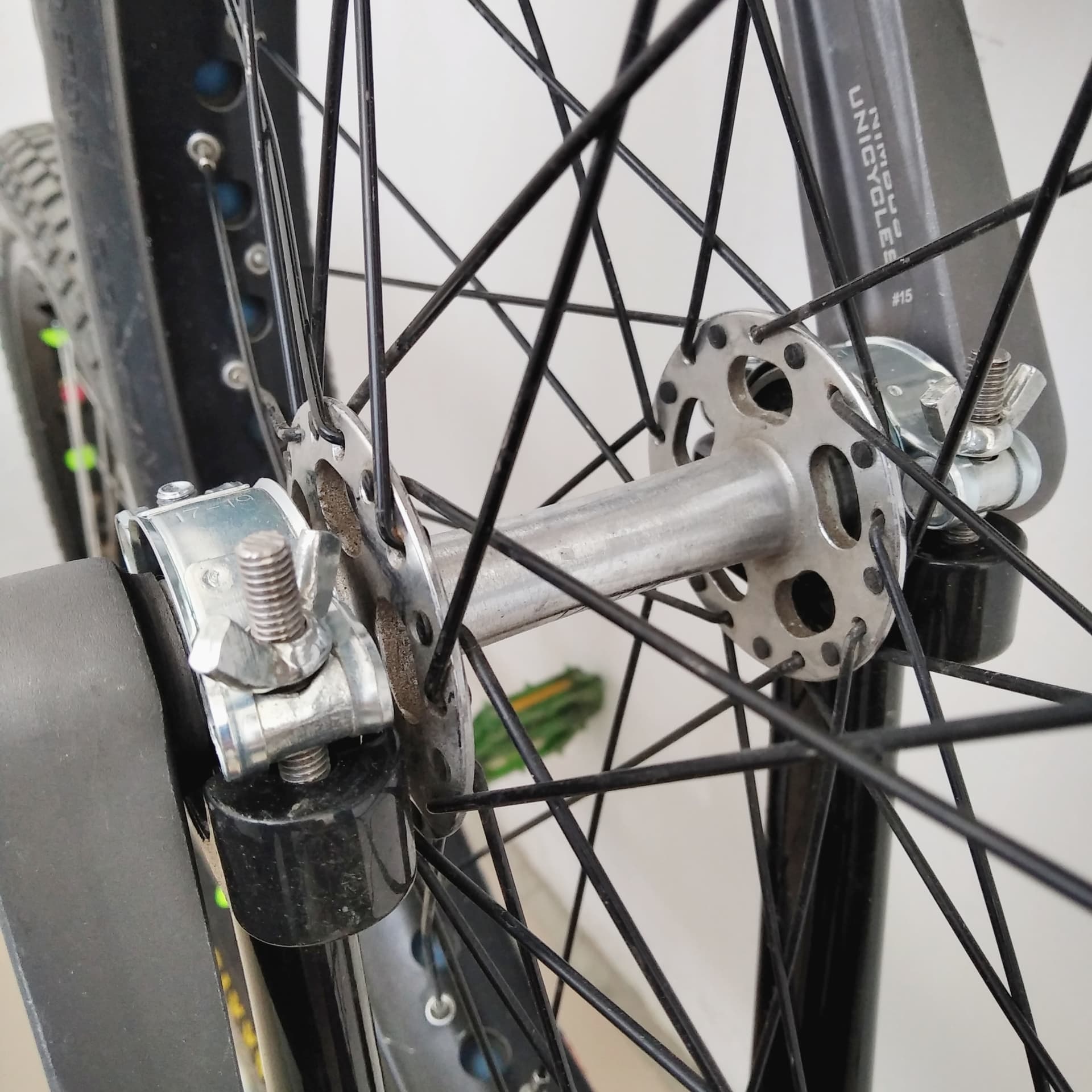

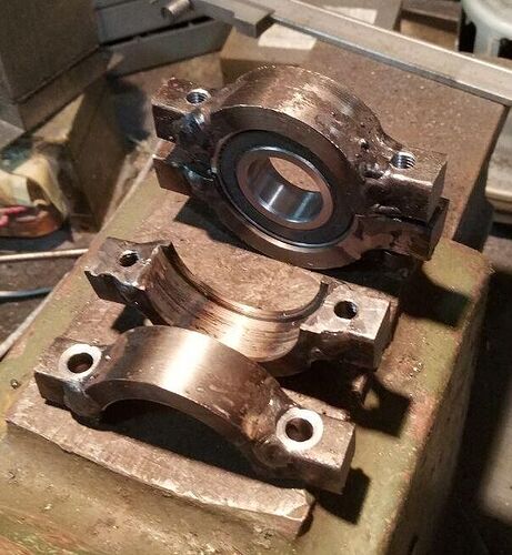

The Zivit bearing clamps.
100km tested now.
Cost below 5€ for couple
1 minute for changing wheels
