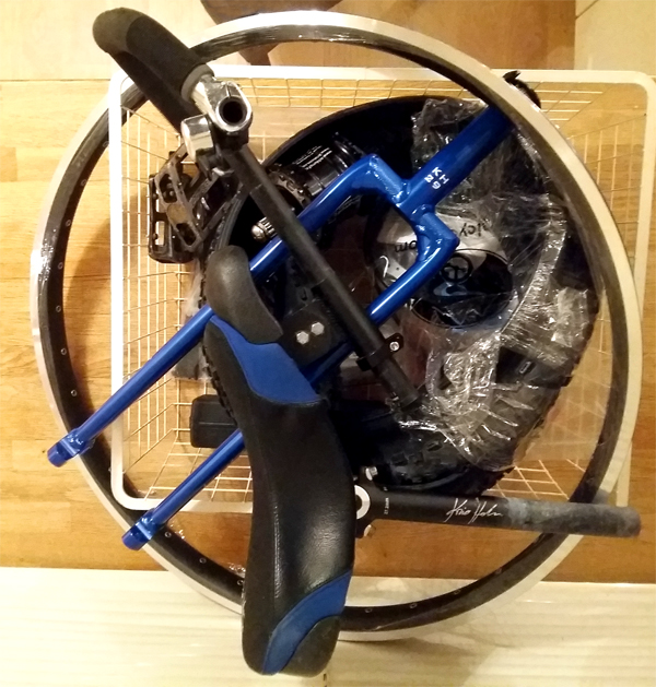

Hopefully I have all the parts for a 29" Guni.

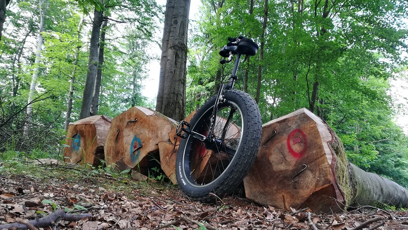

Ok, aint much of a project.
But its a fine surly cunundrum 26’ setup - collectors version :sunglasses:
Schlumpf Hub, LM Rim and 26x4.8 Larry, 150mm cranks and KH One saddle.
an all steel xc cruiser - heavy as f… :roll_eyes: :slight_smile:
Beautiful! Those good old Surly are beasts and they are sooooo nicely made!

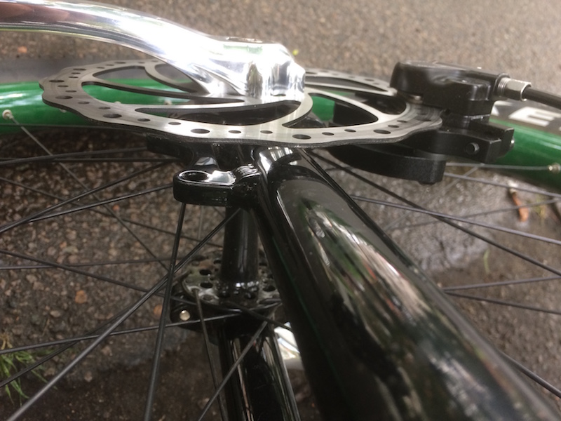

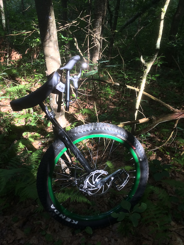

Thought I’d share some recent upgrades to my Nimbus 27.5 Green Monster. Probably not that unique but I’m pretty fired up about it! I added a KH T-bar, some KH cranks, Shimano brakes, and Chromag Scarab pedals.
I rode for a few days with just the T-bar before adding the brake and I love the power position in which it puts your upper body. Really has improved my control of the uni. Also love the stance provided by the flared KH cranks. And no creaking! Damn. I didn’t think silence would make such a difference.
The brake has obvious benefit, but it vibrates during fast descents when it’s working hard. I flipped the Nimbus frame (but not the direction of the wheel) so the welded caliper mount is on the same side as the D-Brake. I think I’ll use it to attach a support for the D-Brake, but haven’t decided the best way how… Overall I think she looks pretty damn good :o

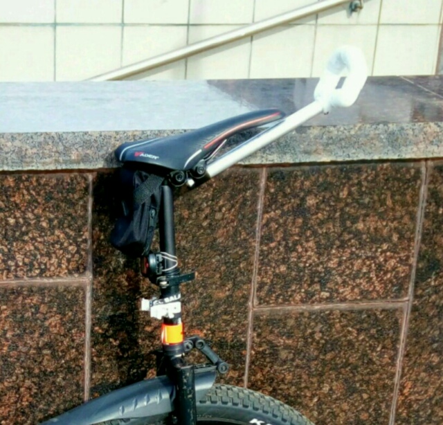

Bicycle sport saddle project
During an year try my idea about using standart bicycle seat on the unicycle.
Have a good result, particulary on long distance, where comfort is most important. My system is cheapest, has light weight (saddle+seatpost+handlebar=950g.) and enough strong, to be not crashing by fault down.
Paint the handlebar black! How does it feel compared to other saddles you own? I’m using a rail seatpost and I was wondering about your idea too… can you descibe better if you feel it better, as good as or worse than a common flat uni saddle or a Ushape uni saddle?

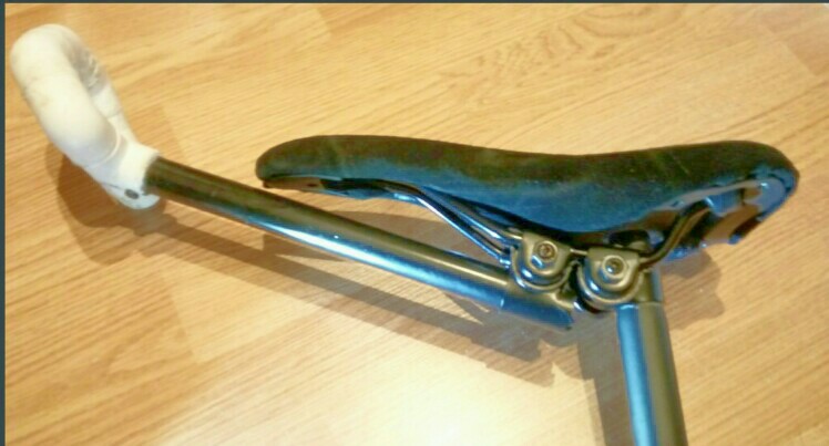

The handle itself is made from PP pipe fittins, it is extremaly strong and very cheap, but available in light colors only.
Bicycle sporting saddles made to be maximum comfortable for long dictance, but you need some time for adaptation and finding optimal position for your seat. All uni saddles have too wide front part, I don’t understand why. Bicycle saddle has slim front part and your legs don’t tach it even if you don’t take knees as wide as possible. So your legs and knees are in optimal position. Secondly, here is better ventilation, those men’s parts feel free and easy without pressing and with good airation. Of corse sport saddle is not so soft as most of unicycle one, so you should to lift up your seat if the road has obsticles.
I took about tree hundred kilometers and don’t want to return to common saddle for city transortations. Cheap bicycle saddles have too weak PU cover, that will be weared out by falls, so I made new cover from nature leather, taken from old wife’s bag.
This is photo
Great idea to attach the handle! I’ll use it as soon as I can build it!
