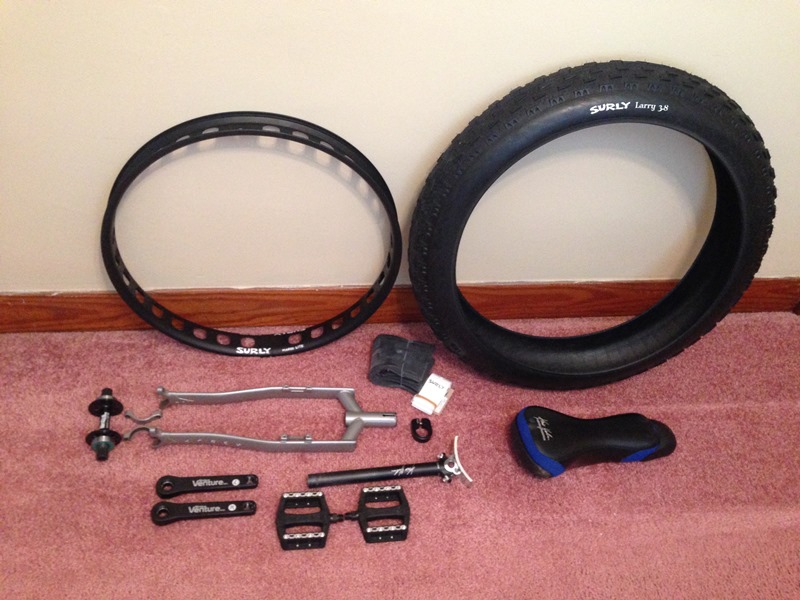

I have one of both rims and one of all three tyres to test out what setup is best.

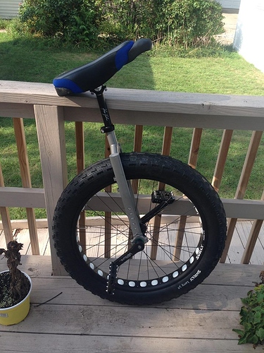

Probably swapping out the tire for a Nate at some point, but my brother graciously donated the new tire from an old pugsley. He swapped it out for something else.
Just a leaner, meaner Conundrum. Always wanted one.
Spokes arrive today!

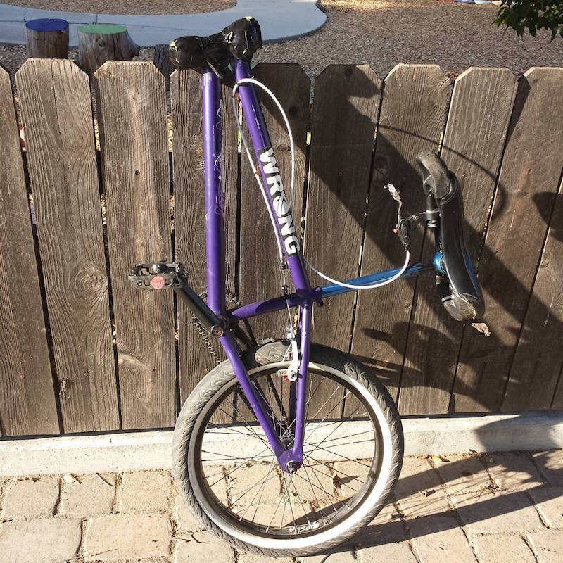

I want to know if it’s feasible to coast on a freewheel unicycle with the pedals/cranks outside the wheel. A purely vertical design (giraffe/penguin) seems too high to me. So there’s either (1) the cutoff bike style as in Frumpet’s video, (2) something based on the front end of a FWD (front wheel drive) recumbent bike, or (3) something completely custom (like Corbin’s). Before I go too far down this path I converted my own BMX bike (not cutting it at this stage) to test out the ride-ability:
I couldn’t get the saddle at the right angle so I ordered some Kee Klamp parts to get it there and I’ll see how it goes.

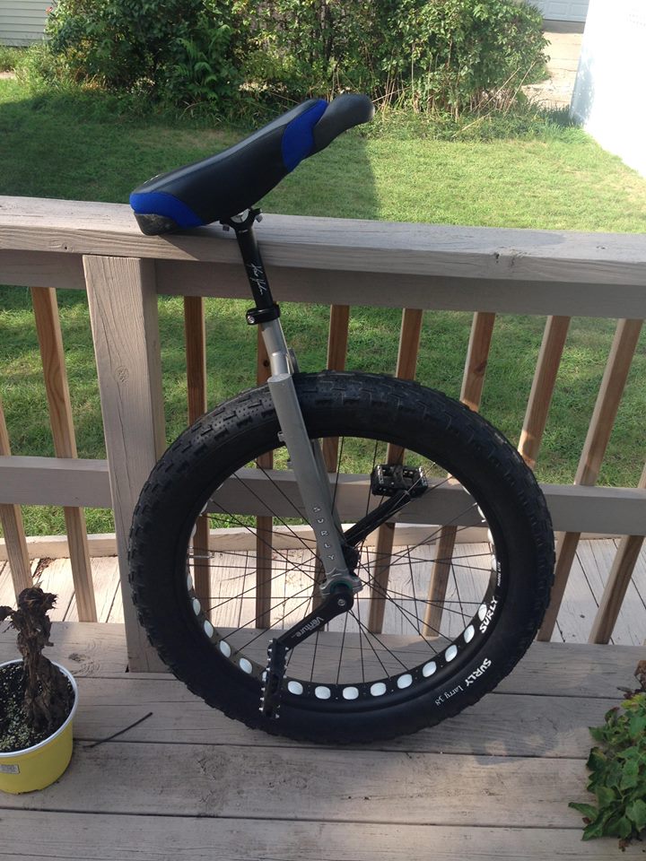

This was before and during its first ride. I gave it a pretty good beating, and the wheel held up. I’m pretty proud of my first build! I was deathly afraid it would taco at the first bump.
That is seriously so awesome. Unicycles like yours really make me want to get into muni (and I’ve always really hated mountain biking and dirtbiking). Two weeks ago my girlfriend and I went hiking up around Bogus Basin and seeing all the trails might have given me the bug. Yours is definitely one of the best fat-tire munis I’ve ever seen. Not sure if I’ll ever be able to find a Surly, but a Nimbus Oregon would be a close second in my book.
Thanks :slight_smile: the fat tire definitely makes things easier. The biggest thing I noticed on the ride was how much less fatigue I had. It allowed me to blast over the sections in the back of the trails I usually struggle with. The Oregon will actually fit a 5" tire as well. They are supposed to be making a few updates to the frame. Hopefully they fix some of the frame breaking issues, though admittedly I think people that broke frames were doing big drops on them.
I really love the Surly. It being rare is definitely part of the charm. It also fits a standard size hub rather than the super-wide hub that the Oregon has. There is no feasible way to have a brake on it now though, because they don’t make the large marge rim anymore. I was fine with that. Brakes are for the weak. : P
Muni is definitely a different experience than mountain biking. I’ve found that I seek out the hardest sections I can find on a uni. Typically they are easier on a unicycle than a bike. You don’t have to worry about the handlebars being too wide, and have a lot more maneuverability.

No feasible way to add a brake? I can think of a few ways but if i were to add one to a conundrum i would definitely consider going with a crank mounted disk. If you wanted to use maguras there are off the shelf adaptors to move the pads further out for wider rims.
I guess you could do a d brake adapter with a crank mounted brake, or Weld a mount on. The Marge lite rim doesn’t have any way to use a rim brake. I’m cool with how it is right now though. : ) so far I haven’t used brakes off-road.
