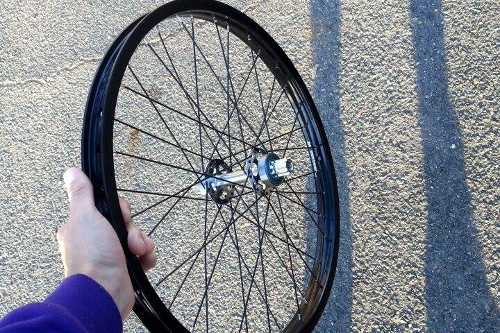

22" wheel for Unicycle Hockey. Has been the biggest bitch of a build.
Is that the new KH Spirit hub?

It is the new spirit hub. I bought two of them and built two 22" wheels from it. Unfortunately the left hand side of both the hubs appears to have been threaded too shallow so the bolt is screwed into both hubs and stuck so tight it feels like it is welded in. In talks about getting a replacement as it appears to be a manufacture fault or something.
They aren’t common which is why it was such a bitch to build. Aside from only two companies making the 22" rim/tyre (and costing a lot to get it to Australia) it requires custom length spokes that in Australia cost $100 for 36 spokes.
Ive been able to ride the completed wheel for hockey 3 times using 100 and 114mm cranks and it appears to work very well. Unfortunately I cant change the crank now because of the hub issue so I am back to dismantling the wheel again. :frowning:
Or you find a thread cutter and recut the thread on your own.
One of my LBSs has a thread rolling device and makes me spokes of any length if I need replacement spokes. But I don’t know how much I would pay for 36 spokes. Last time it was 10€ for 2 replacement spokes and truing the wheel.
