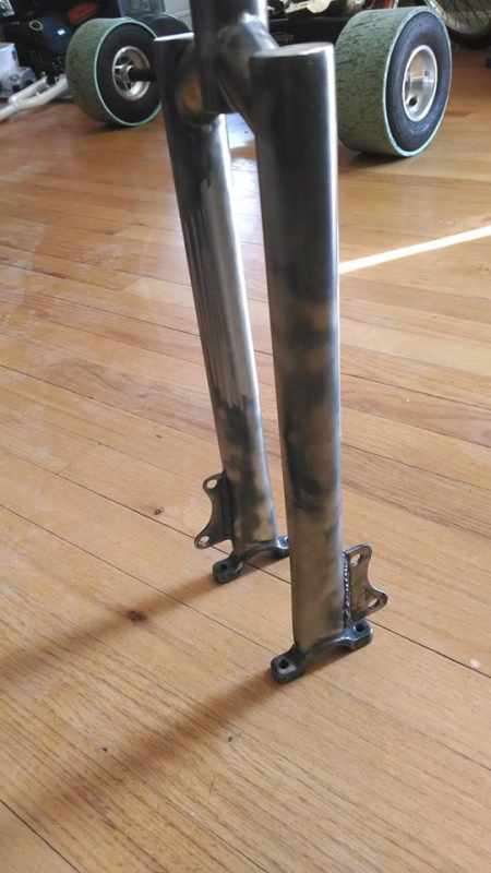

I’m working on a couple freewheel projects I thought I’d mention here in case anyone has feedback or constructive criticism.
[LIST=1]

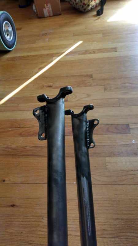

  • Reversible frame. I'm having two disc tabs welded to a Nimbus 26" muni frame, spaced for a 203mm rotor on the front and 160mm on the back. I'm doing this to try out a larger rotor but still have a fallback if it doesn't work out or for different wheelsets. I've determined that aluminum frames don't give me the stiffness I need for braking and the combination of a steel frame plus an aluminum D'Brake mixed with the near-constant braking requirements of a freewheel is a recipe for eventual equipment failure.
  • Fat freewheel. I bought [this 24" Surly Conundrum frame](/t/surly-conundrum-frame-large-marge-rim-iowa/122159/1) from the Trading Post. I'm planning to see if it will fit a 24x4" tire like the Vee Rubber Mission tire. I'm also going to have a disc tab welded to the frame once I determine if a 203mm rotor is viable for me. I haven't seen a 24" Conundrum with a 4" tire and I'm curious if anyone else has one or has seen one. On-One is releasing a 24" version of their Floater tire in a couple months so that may be another possibility. [/LIST]

    Yes, it seems the Baby Fatty was delayed a bit but I found it in the wild recently. That one has the Vee Rubber Mission tire but the 24x4" On-One Floater is supposed to come out in the next couple months. Thanks for reminding me about maggies! They don’t give me a sufficient braking environment on my 36" freewheel and I expect the result to be the same on the Conundrum but it’s certainly worth a try. On my 26" freewheel unicycle I currently have a 160mm rotor mounted on a D’Brake. On steep, paved descents I have to be careful of my speed because I can go faster than I can control easily with the brake. When I’m getting to that point I have to yank extra hard on the brake in pulses instead of the continuous modulation I prefer. I want to compare my current setup in that scenario against a 203mm rotor mounted on a steel disc tab (and a 160mm rotor mounted on a steel disc tab if that ends up being too much). I run sintered disc pads so can drop down to semi-metallic, too.

    Thanks! Since I busted my 24" freewheel I’ve been riding my 26" and think I’m used to the difference now although it has a narrower rim (35mm vs. 42mm). The extra height was really noticeable at first and it’s taken time to get the maneuvering down. My reversible frame is in the mail and I’m really curious to hop back on the 24" to see what it feels like. I like to take small steps so a fat 24" seems like a great configuration to try next. I’m bringing the parts to the bike shop this afternoon.

    The specs turned out slightly different from what I planned. I got a 24" Nimbus muni frame and the disc tab is sized 160mm on the normal side and 180mm on the reverse side. I’m using an adapter to run a 203mm rotor on the normal side. I presume there’s a 160 to 180 adapter that I could have used as well and avoided the disc tab on the reverse side altogether. I found that the 203mm rotor together with semi-metallic disc pads was a little too grabby at the low end. I switched back to sintered pads and the combination seems like a winner for me, not too grabby but plenty of power for steep or long descents.
