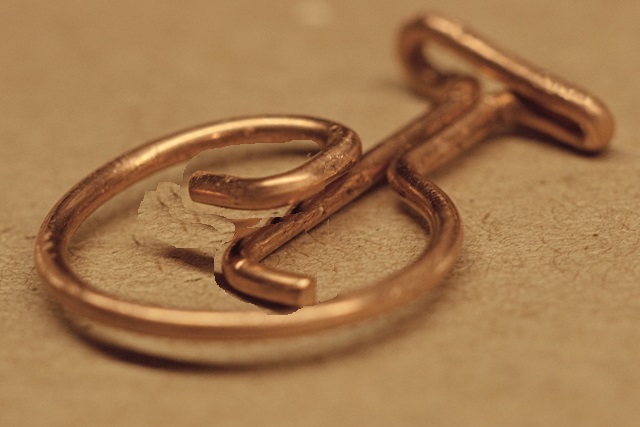

Ok, it’s not the same scale as the DIY-Rex above, but still unicycle related. It’s my attempt at copper wire jewelry.
I’m going to tarnish it with some heat & throw it in the rock tumbler for a few days.
Very nice. I would only suggest to make the ends in different length:

Thanks Ernst,
The picture doesn’t show it well but the pedals are level and from the centre - like hands at 9 & 3 on the clock. It seems the simplest & most natural. I tried to hammer the them flat like pedals but in the end I didn’t like the way it looked so I left them cut & filed.

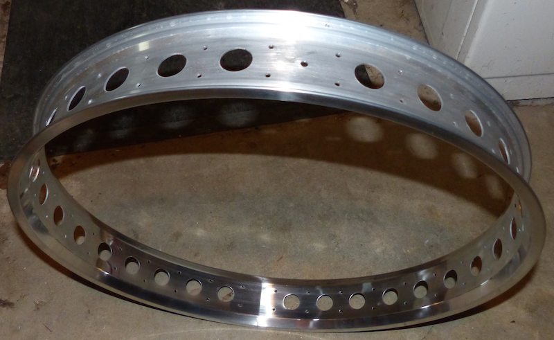

I received this beauty yesterday and just managed a global pic and a width check (82mm all right with 25mm diameter cut-outs).
Still have to weight it to confirms how close is the manufacturer’s announced weight (850g) from reality.
Stay tuned :wink:
Wow, that rim is fat! I was looking into Surly rims for my fatty muni project, but that looks much better. If only it came in 29".
For what I know, in 29" the biggest available is the Surly Rabbit Hole rim (50mm) which is barely wider than a KH rim.
There isn’t any oversized tire in 29". The biggest available is the Surly Knard 29x3.0 and it is plenty big already =)

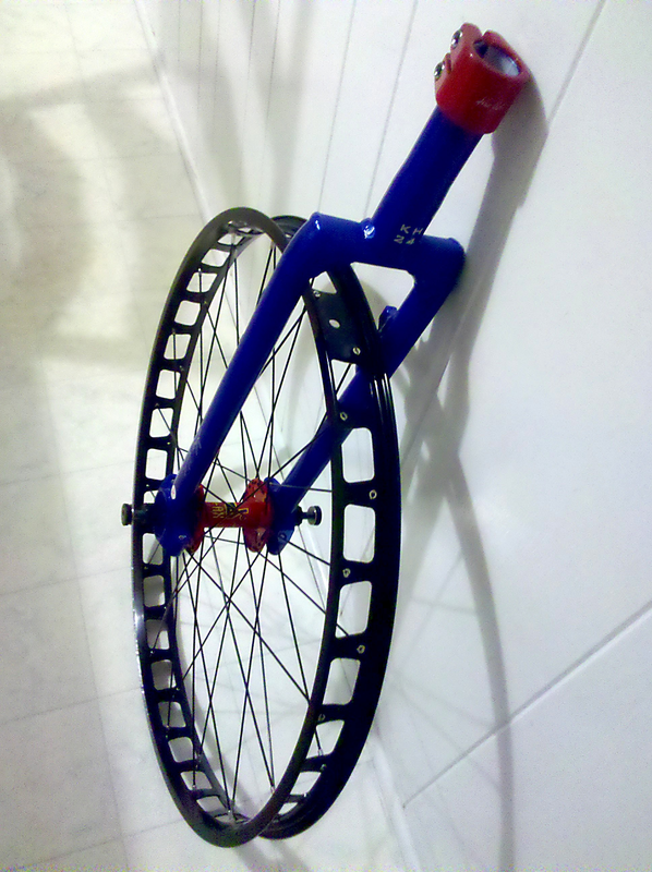

Work in progress, Rockman trials rim on Qu-Ax hub, 32 on 48…
Nice wheel, but I have a question:
That large spoke offset in the rim, doesn’t that make the wheel very flexy in sideways direction?
Looking in riding direction, shouldn’t there be a triangular shape in the spokes, from left flange, to rim, to right flange, to make it stiff, sideways? With this offset in the rim, it is more looking like parallellogram. Triangular constructions are stiffer than parallograms.
I see this more often in these wide rims, can anyone tell me why?
