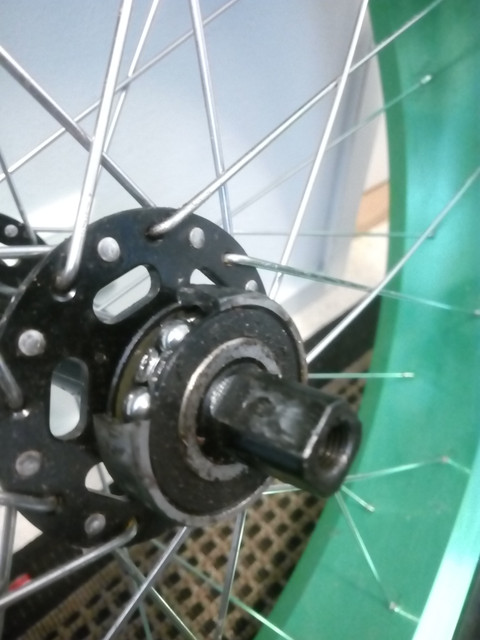

Got a surprise today! Loud banging started coming from the bearing during intense uphill training session. :smiley: Wheel kept turning fine and when took it off at home, I found this:
Got a pair of new bearings and changed the working one. I have a problem with the broken one though… Can’t pull from the bigger ring because the ring slips off and can’t get my bearing puller to hold onto the smaller ring. :angry:
Does someone happen to have a suggestion to easily remove the broken bearing?
Tough one! I guess I would start by pulling out every tool that I could imagine possibly using as a puller or a drift and seeing if I could get any purchase on it with any of them. If not, I would try to remove the balls and retainer and shields, then heat the inner ring with a torch until it started to show some color change and see if I could slide or pry it off then.
The absolute worst case is having to buy another hub and rebuild the wheel, which isn’t the end of the world. It’s a chance to upgrade to an ISIS hub if one was inclined, with the usual caveats about frame bearing holders.
Where it mine, I’d see if I could find a puller that might fit the inner race after the balls and outer race are pulled off. A cheap three arm puller may be able to do this.
If that didn’t work, I’d carefully take a grinding or cutting wheel to the inner race and see if I could split it. I’d use that much heat as a last resort, and only after un lacing the wheel.

Unhelpfully, I was looking at your picture thinking I don’t even have a suggestion to easily remove a perfectly intact bearing. I just got an old Miyata bearing off an old Miyata hub but my “fat” Craftsman 2-armed gear puller is too thick to even get behind the bearing without first working it off a bit. Then you have to protect the threaded end of the axle (it uses cotterless crank nuts). So I got a pipe cap that fit. But then I had to drill a hole in the middle of that, because the gear puller wouldn’t stay in place. Then I had to improvise a vice, since I don’t have a workbench… Basically, it helps to have the proper tools!
My thought also would be to try a dremel or a small grinder if you have it. Not much clearance around the flange, but if you can cut part of it, you might be able to then wedge something in there and break it the rest of the way or something.
I’ve never seen a bearing break like that. I wonder what caused it?
How about attaching a hose clamp around what is left of the outer bearing race. With the clamp tightened down tightly against the balls, you should then be able to use the bearing puller against what is left of the broken other race. Failing that, you’re going to have strip the bearing down so you are left with only the inner race, and pull that off on its own.
Thanks for advice everyone! Ended up “dremeling” the inner race and that helped to get it off:
