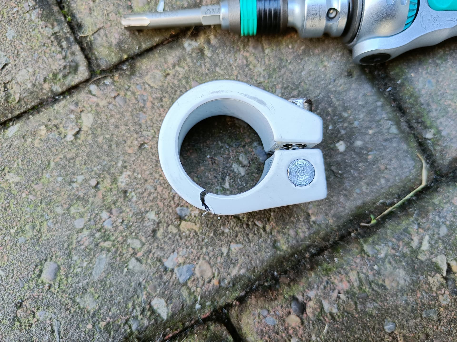

Got a surprise 2 weeks ago when I found my muni crippled in the basement:
This pic was taken after I remove all the loose spokes (where the flanges broke) leaving 2 spokes on one side and 12 on the other (it is a 36 spokes hub/rim).
To be fair @MAD4ONE documents clearly that this hub is not meant for extreme use, should be built with Sapim Strong spokes in 4 cross pattern.
I had the wheel built by a pro but the Siamese wheels workshop forgot the 4 cross (or found it overkill?).
It lasted a good 4 years as I am far from being a muni grandmaster ![]()
I was having some creaking noises for a while and thought it was a spoke tension issue. But the workshop guy checked and everything was good so he told me it might be spokes rubbing at the crossings (never was keen on greasing the spokes at the crossings as he suggested if I really wanted to get rid of the noise).
I am in the slow process of pulling the last spokes and realizing I am missing a few tools (some I never bought like bearings puller and some I have lost like a spoke wrench). But numbers seems to look encouraging for rebuilding with a KH hub I have and these spokes (that’s some silver lining). To be continued in the “lastest build” thread hopefully ![]()
