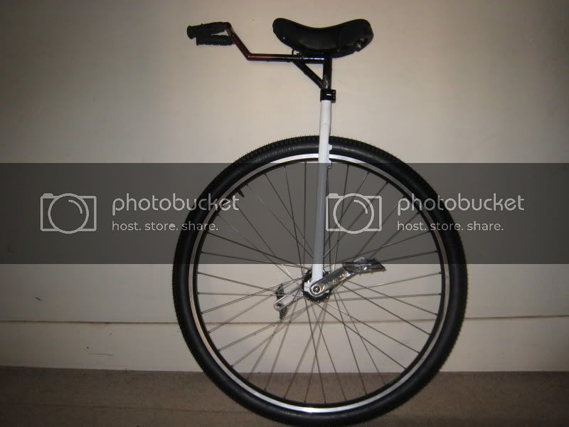

I have just finished putting my new 36er together.
Specs:
KH36 frame
T7 welded to steel seat post
CF seatbase with KH foam and cover
Oury grips
Nightrider tyre
150 mm Moment cranks
Straitline pedals
KH/Schlumpf hub
Spokes tied
Green anodized spoke nipples
Normal 36" tube
I will be changing a few things when I get the time or when the parts arrive. Hopefully some new twenty6 Prerunner pedals, All City stars grips and a proper paint job for the frame and handle. Not sure yet if I will get a brake.
I like the white frame.
I was considering getting my chrome/steel Qu-ax frame powdercoated black but it would be cheaper to get a new frame such as a nightrider but I would need to bend the frame to make it fit onto the narrow hub. I know how to do that but my concern is that the bearing holders would be misaligned…

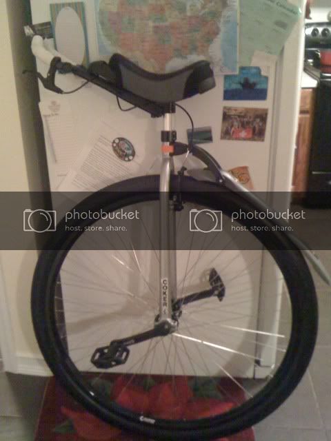

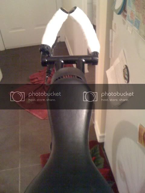

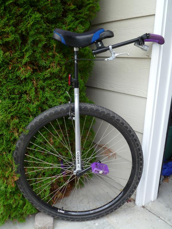

Here’s my baby
Coker Big One
Coker Pi Bar

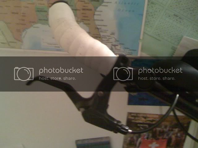

Tekro Vbrake

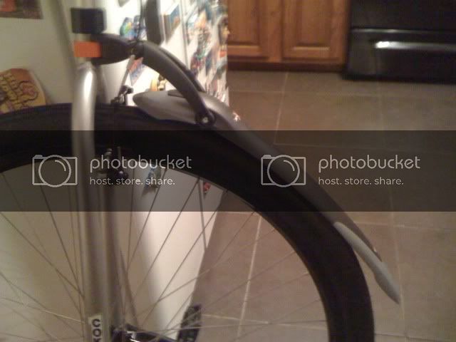

Eaton handle bar wrap
SKS xblade rear fender

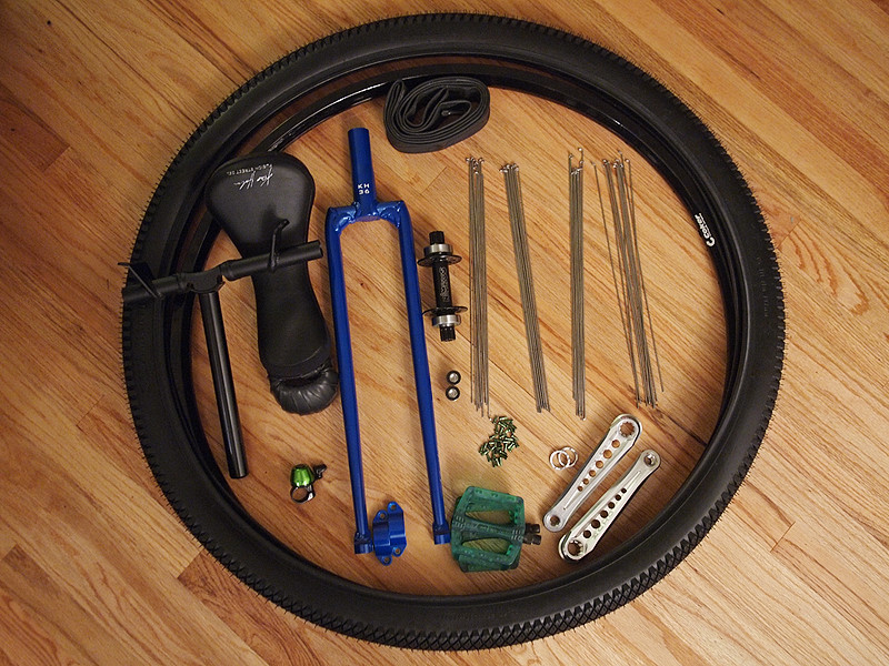

With apologies to One on One, here is my new 36er:
Frame: KH
Seat: KH Fusion Street
Seatpost: Atomlab pivotal
Seatpost clamp: 31.8mm adjustable, green*
Handle: Nimbus Shadow*
Brake: V-brake with friction shifter lever*
Bell: Sunlite Candy mini bell, green
Tire: Nimbus Nightrider
Tube: Kenda 29x2.3
Rim: Coker Double walled aluminum
Spokes: Coker 14g Stainless with green alloy nipples
Hub: Nimbus ISIS 48h
Cranks: Echo SL 160mm (will probably end up with 165/137 Moments)
Pedals: Wellego PC, green
*Not pictured
The photo was taken after I took apart the Coker wheel to swap the hub. I laced the wheel last night and will spend some more time tensioning and truing (and tensioning and truing…) before putting it all together.
Thanks to Saskatchewanian for the idea of using the Nimbus hub with the Coker rim in the KH frame and to Brycer1968 for thinking a little outside of the box.

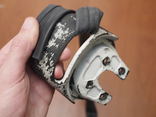

what did you do to the kh handle on the seat.
thanks zipper
It’s wrapped with an old tube. I do this on all my handles and really like how it feels when gripping them. This is why I was a bit bummed about the new 2011 KH handle design without the hole; I guess I’ll have to buy a few spares while I still can.
could you show how you did it. it looks really cool.
thanks zipper

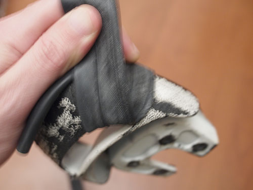

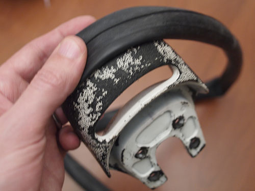

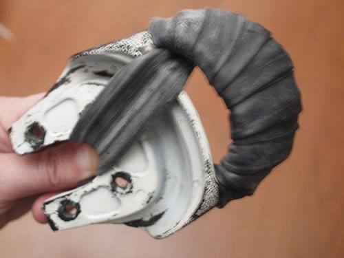

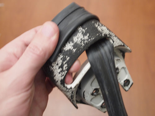

Wrapping a handle
The attached pictures follow the steps below (this wrap is really sloppy due to basically doing it one handed so I could photograph the steps):
  1. Cut about half the length off old tube; take the handle off the saddle.
  2. Lay the end of the tube across the front of the handle (the left/right orientation doesn’t matter).
  3. Loop the long end of the tube up and through the hole in the handle pulling it tight the whole time.
  4. Loop the end back down over the handle.
  5. Again loop the long end up, through, and over, overlapping the previous loop by about half the width of the tube. Repeat until the handle is covered.
  6. When you get to the end of the handle, rather than looping back down over the front of the handle send it to the back. Hold this tight while bolting the handle back onto the saddle, which will hold everything in place. You can then trim any extra bit that might be sticking out from under the handle.
It’s really simple; the main trick is to pull the tube tight and keep it that way.

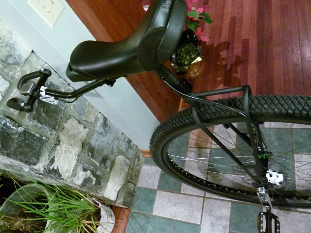

My 36er has a KH saddle that I trimmed slightly for width. Here’s a picture, to avoid the thread-jack factor :slight_smile: (previously shown with full specs at post #166 (top of page 12) Post Your 36er Here).

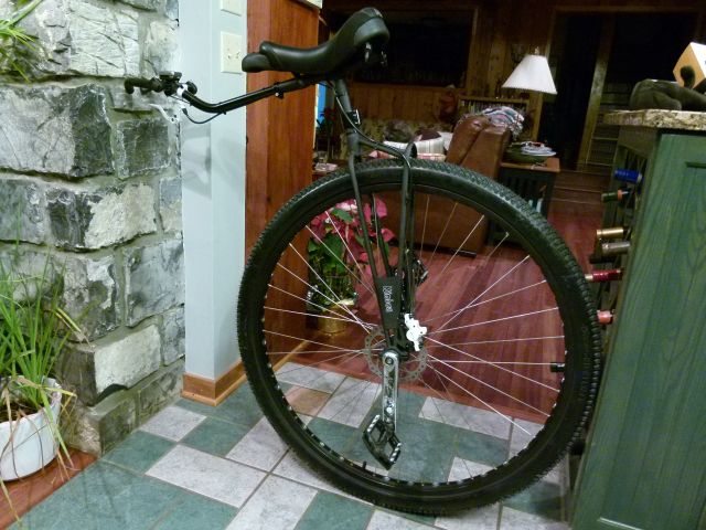

Here is my new Nimbus Impulse that I got today. All stock except that I upgraded the cranks to KH 135/165 and added a Planet Bike Protege 8.0 computer.
