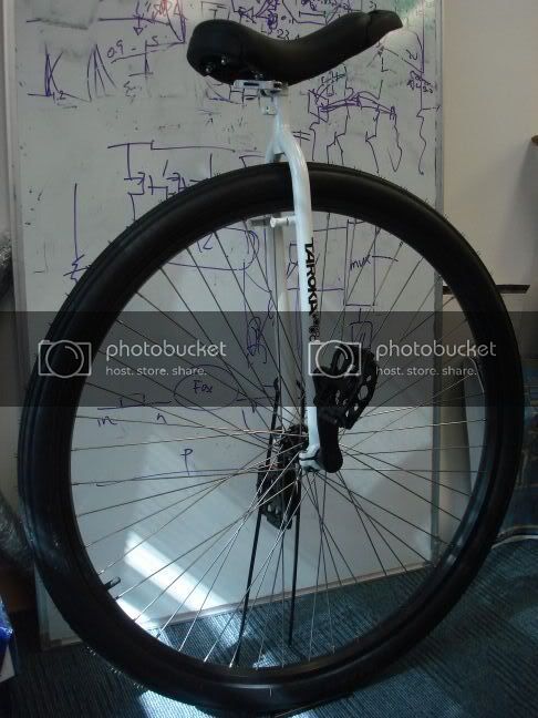

Tell us more about your new 36er. It looks like a Coker with white paint?

My 36er is directly from Taiwanese Factory (Taroka) with a very affordable price. I don’t know where Taroka’s unicycles are sold. Maybe Japan’s bike shops. Seat post is 22mm, thus I don’t think it is any 36er sold in unicycle.com. Its 36er is only released for 1 month.
I just got an email from Taroka - $196 for their 36" uni !! If only I lived in Taiwan. I will see how much shipping might be.
Taroka sells the unicycles with this low price to Taiwanese individuals and schools because Taroka’s boss wants to promote this sports locally.

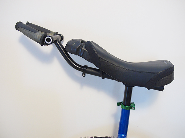

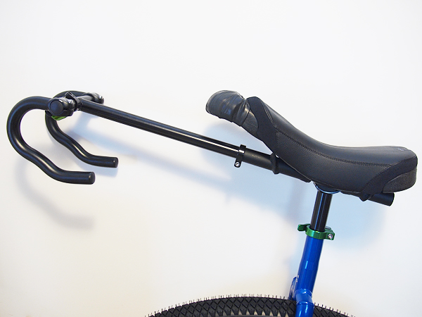

I got around to putting the handle on my 36er. The Nimbus Shadow bar set comes with two T-bars to give you some options when setting it up.
I left the straight bar uncut and added some Origin8 drop-bar ends to give me multiple positions when riding long distances on the road. I’ve only taken short rides around the neighborhood but this seems to work very well and feels almost like the handlebar on my road bike.

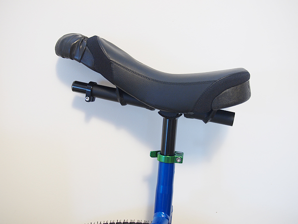

For shorter and/or rougher rides where a long handlebar isn’t wanted I cut down the curved bar and narrowed the ends of the “T” to have a close handle that allows a brake to be mounted near the saddle.
The piece of the curved bar that was cut off can also be used to mount a brake if I ever want to ride with no handle at all.

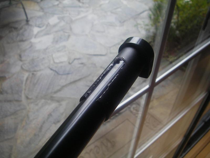

It sucks though, because my T-bar just broke, again! It’s all good though because Kris is going to replace it free of charge. Thanks Kris!

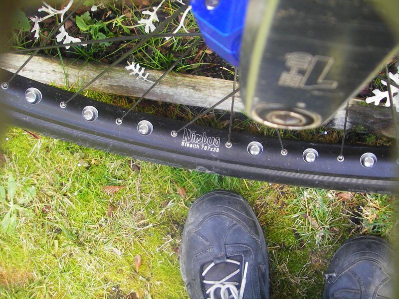

Rimstrip-Chrome duct tape (Yayuh!)
Rim-Nimbus Impulse Stealth

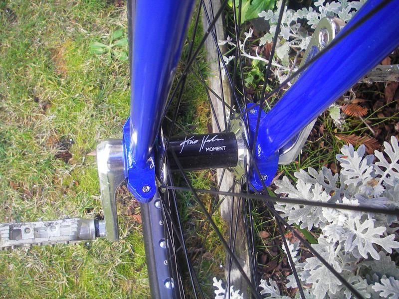

Hub-KH Moment 2010
Cranks-QU-AX 125mm ISIS (Crazy light)
Pedals-MG-1s
Frame-KH

Nice! I like the rim strip - I had to back my KH rim strip with tape after it dimpled excessively (although admittedly partly my fault due to leaving the uni in the truck on a hot summmer day). I think your pure tape idea could be catchy. A stipped frame would also look really good with the silver accents on the wheel.
