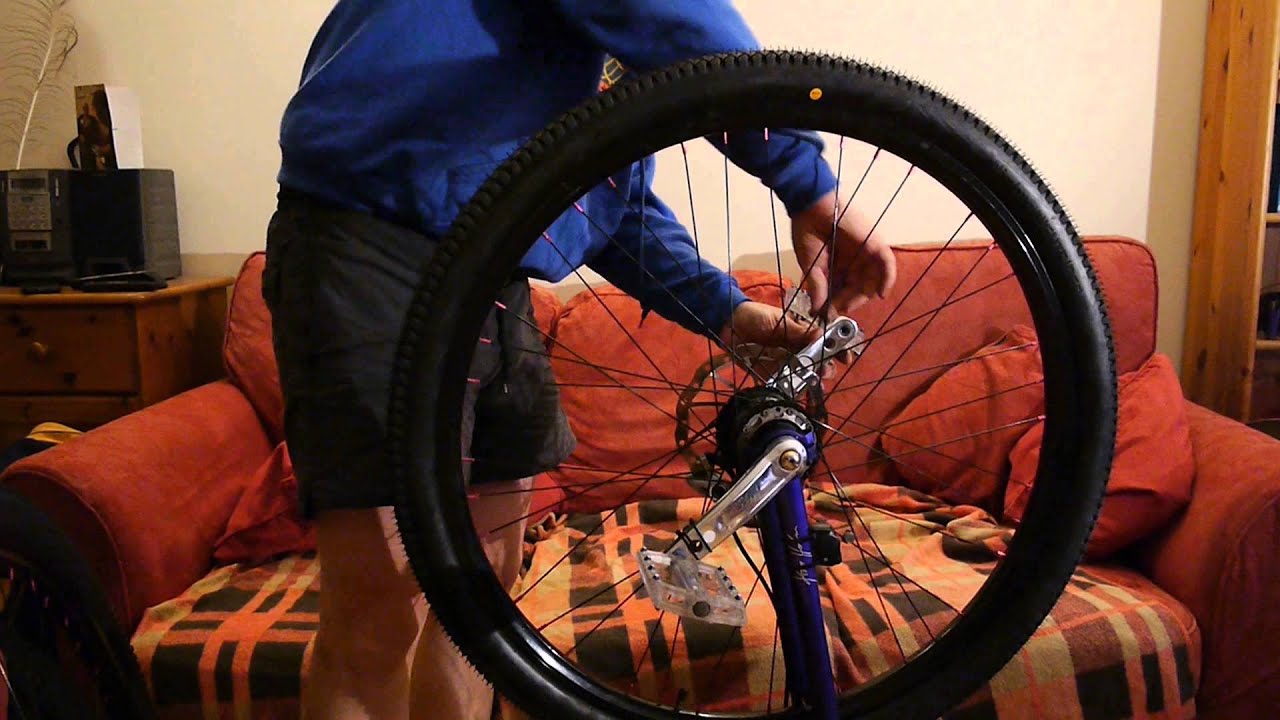

New 32 tyre tested
Finally got round to putting a video together of testing the new Nimbus 32
What’s the actual outside diameter of a 32’’ wheel? Might need a faster commuter that isn’t as huge as a 36’’ :stuck_out_tongue:
I’ve measured my 32’s rolling circumference at 2500mm, so approximately 800mm diameter.
The Nimbus is 32" diameter, but the Kent is only 31 1/2". The tire is a little narrower than the Nightrider, also. The biggest difference is the cost. It costs about $75 for the whole wheel/tire combo shipped from Kent in New Jersey. If you already have a 48-hole hub, this may be worth looking into. (I’ve read elsewhere that the stock spokes fit the new application, but I haven’t personally tried this.)
Cheers!
To clarify, my measurements were for the Nimbus rim and original Nimbus Nightrider tyre (the new lite version is slightly larger as I understand it).
800mm is basically 31.5". I do run it with relatively low pressures though so pumped up hard you’d probably get a rolling circumference of 32", especially with the new tyre.
The Kent wheel works with the original spokes in a 4 cross pattern with the Qu-Ax 48 hole ISIS hub.
I’d recommend anyone thinking about getting a 32" to ignore the Kent wheel now though. The rim, spokes, and tyre are all pretty crap compared to the Nimbus offering.

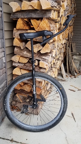

New to 32 big wheel
Having put together my 32, there is a sense of accomplishment in doing something I seriously doubted I could do. Now the next step is increasing my capacity to ride and enjoy the beauty.
The seat was flattened, which made it amazingly comfortable for local riding. I’m considering now sanding the Kent tire, as mentioned in an earlier post, to improve the handling. It is definitely a new experience riding this as compared to the 20 and 24 inch unicycle. Maybe its the tire’s mass. Maybe its the intrinsic mass of the whole 32, but the sensation of riding this feels like 'cruising. (either an ocean liner or driving one of those larger mid century classic cars) First impressions, which are feeling more normal now, were, I was mounted and riding on power. ..power to amplify my effort more than any of my other unis.
frame - KH 36
tire, spokes and tube- Kent 32
hub - 48 hole Nimbus hub
crank arms - KH 125/150
cheapo plastic pedals
cheapo unicycle seat flattened
seat post - udc aluminum
