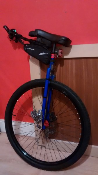

Monsterous Ride
Nice little ride on the G32 this morning :smiley:

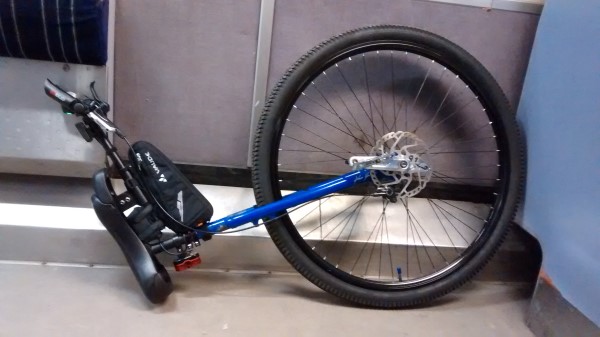

My new 32
Built up over Christmas…
Kent bicycles rim, tube & tyre
Nimbus 48h ISIS hub
Spokes are 36er stainless spokes cut down to length by UDC UK :slight_smile:
Laced 5-cross over-over-over-under-over by yours truly :slight_smile:
Nimbus Impulse 36er frame (125mm, bent in to 100mm)
KH dual-hole 110/137 cranks (for now)
Fairly ancient :slight_smile: Qu-ax magnesium pedals, for now
Nimbus gel saddle
Nimbus 300mm seatpost, single quick-release seatclamp

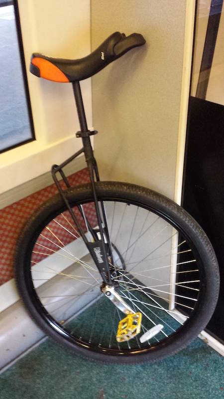

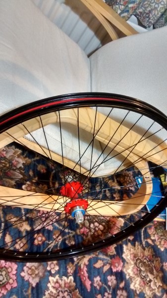

Here’s mine.
Until I get some more money, the wheel’s playing swapsies with my 36er.
That does however come with the advantage of having brake and bars set up ready.

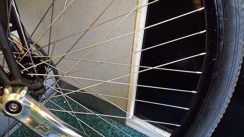

The wheel is using the standard spokes and nipples and a 48h red Qu-Ax ISIS hub. The larger flanges mean that 3 cross is way off for spoke length but 4 cross is spot on.
I estimated the rim ERD at ~650mm.
The stock b*ke hub measured up at 44.5mm PCD, 53mm spacing. This equates to 3 cross spoke length at ~309mm.
The Qu-Ax hub comes in at 63.7 PCD, 64.5mm spacing, giving ~300mm 3 cross or ~309mm 4 cross.
Actually measuring the spokes (in the wheel, I forgot when they were out) gives me more like 312 so I guess the rim ERD is actually closer to 654mm.
Anyway I hope that calculation helps someone out.
