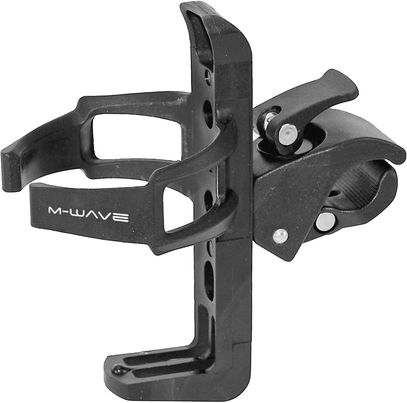

Then I took apart an M-Wave quick release bottle cage:
off the interlocking cross section and drilled a hole in the rack so I could screw the two together.
I needed to put some old inner tube around the frame to stop the clamp marking it and to ensure it wasn’t going to move but that’s it.
