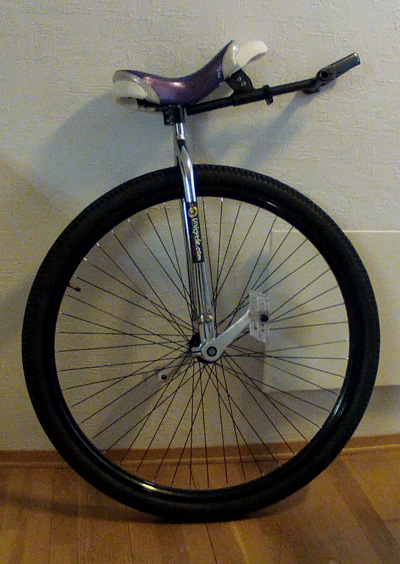

Here is Noras 32", doing road service:
Frame: 32" steel frame, chrome (28" Trainer Unicycle Frame, extended with a 20" Trainer Unicycle Frame (42mm))
Saddle: Nimbus Gel Unicycle Saddle, Purple/Silver
Handle: KH
Rim: Walmart 32 inch donated from a beach cruiser bike

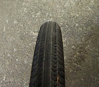

Tire: Walmart 32 inch, sanded down on the edges
Hub: Nimbus ISIS 48 hole
Brake: no
Disc: no
Cranks: Nimbus Venture ISIS 100mm
I sanded the tire on the edges. Now it is handeling corners pretty agressive.

If both the above 32" unicycles had donated rims from Walmart bikes, how come one has 36 spokes and the other has 48? Do the front and rear wheels on these bikes have different numbers of spokes? Or have you used a fancy lacing pattern, Alan, missing some of the spoke holes in the rim?
Because a schlumpf is 36 hole and the rim is 48
yup there was no real option on the lacing as the schlumpf has 36 holes so we just skipped every 4th hole and taped it over :slight_smile:
For my fixed wheel Roger had 1 48 hole nimbus hub with ISIS so we used that which looks pretty neat with the purple nipples and is a great finishing touch :slight_smile:

Pre-wallmart
My franken 32"
It’s on it’s 3rd tire now. Unfortunately the new tire is a tad to tall for the Triton frame.
