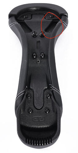

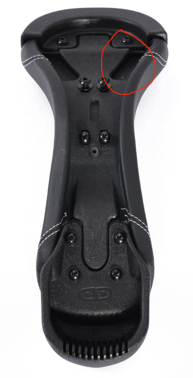

Some saddles are build for trial and have more space on the back for your fingers. Here is an example:
I would recommend those saddles because it allows comfort and is “easy” to use for seat out position (hand in the rear part of the saddle.
Trialists prefer thin foams to have a good grip (seat out)
The model in picture is the “Impact Athmos Unicycle Saddle” but you can also find a similar shape with the “Nimbus Flat Unicycle Saddle” (the foam is bigger on this model).
I tried the Athoms, the foam is very firm.

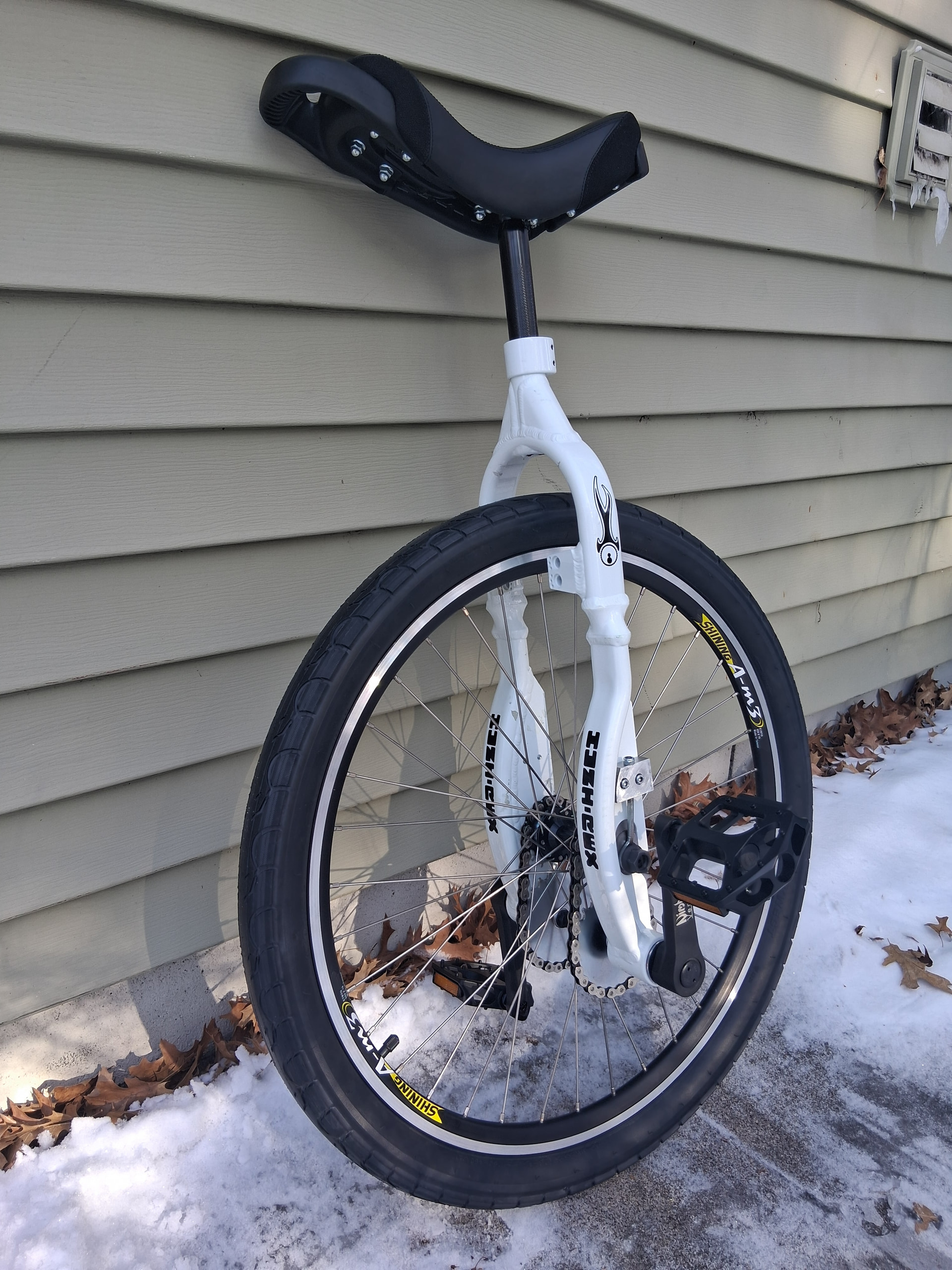

So I’ve recently added a new member to my unicycle family…
I ordered it off of the Huni Rex Facebook Group, and I’m pleased to report they delivered! :slightly_smiling_face: The ordering process is a little different than ordering off of, say, UDC or other sites, but I believe it’s legit.
Unfortunately I haven’t given it a test ride yet being that it’s snowy, icy, and firmly in the negative double-digit Fahrenheits here temp-wise :cold_face:
Feel free to ask any questions about it

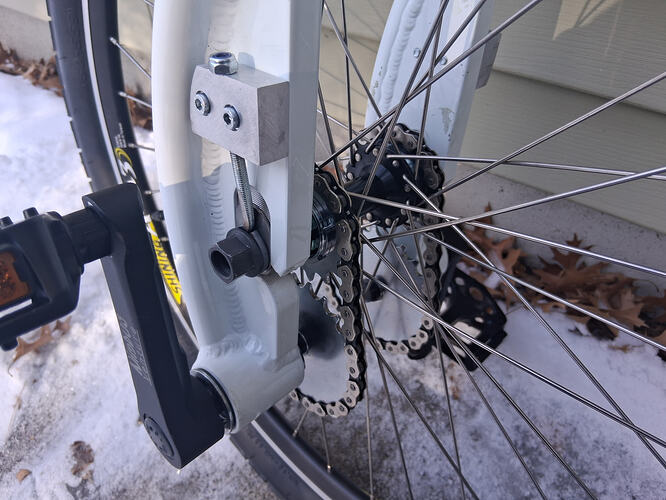

The thought of one of the chains snapping makes me think twice about trying to ride it very fast :sweat_smile: Not to mention there are two chains to worry about, compared to just one on a typical giraffe or a fixed gear bike. I’ll have to make it a point to inspect the chains frequently
Seems like the two chains are there to make the torque symmetric? I think you might still be able to ride it with only one chain installed … but busting a chain while riding would suck. Might be worth adding a chain checker to your maintenance toolbox and checking it every few months of riding, but chains are awfully hard to break. You would likely notice significant stretch on your chain before you ever had a break. Single speed b*kes that I’ve seen get very sloppy chain sag before they have trouble.
Each side is independent of each other, so if the chain breaks on one side that crank would kinda just flop around. It’s a KMC K1 1/8” single speed chain so I don’t see the likelihood of the chain snapping to be very high. :slightly_smiling_face: Also I’ve got a few bike specific tools lying around so thankfully I’ve got myself covered there
Haha, I had to check the photo again, and indeed they are independent. They HAVE to be, since they are off-center. Imagine having a bar thru the spokes :joy:
Well, you might be able to ride it one footed still? :sweat_smile:

I was worried at first that it would handle funny due to its non-standard design, but for me at least I find it rides pretty normally (Apart from being much closer to the ground than a 36er). Tight turns are still possible despite the lower pedal clearance, maybe just don’t try to make fast tight turns to keep the lean in check :sweat_smile: No pedal strikes so far!
In the other thread I also speculated that UPDs might be more risky being that it’s lower. After a few at-speed UPDs, I’m leaning towards it being not as much of an issue as I thought :thinking: I was still able to land on my feet and outrun them thankfully. I still expect the chances of having a UPD to be higher than riding my 36er, however, being it’s a smaller wheel size and thus more prone to road irregularities.
More generally, I’m really enjoying the Huni Rex so far despite it not quite being at it’s full potential yet :cowboy_hat_face: Biggest thing I still need is a longer seat post; I’ve strained my legs a bit riding it with the saddle a little too low. But once I get the longer post, a brake, and a bar on it, I think I’ll feel pretty comfortable doing some proper long rides on it.
What diameter of seatpost does the Hunirex requires? And how long would you need it to be?
Maybe somebody as an unused one in the garage for you :wink:
The Huni takes a 27.2mm post. I think the length of the post shipped with the uni is 150mm-175mm.
This was my first unicycle with a 27.2 post, most of the others use 25.4 posts so I have a bunch of them lying around. It wasn’t until I brought the unicycle with me 3 hours away to university that I remembered that I had a 25.4-27.2 shim in my parts bin :distorted_face: Being that I plan on using a Nimbus Shadow handle I will have to switch to a pivotal post at some point, so I’ll hold off on getting a new post until then. In the meantime, when spring break rolls around I’ll use a longer shimmed 25.4
