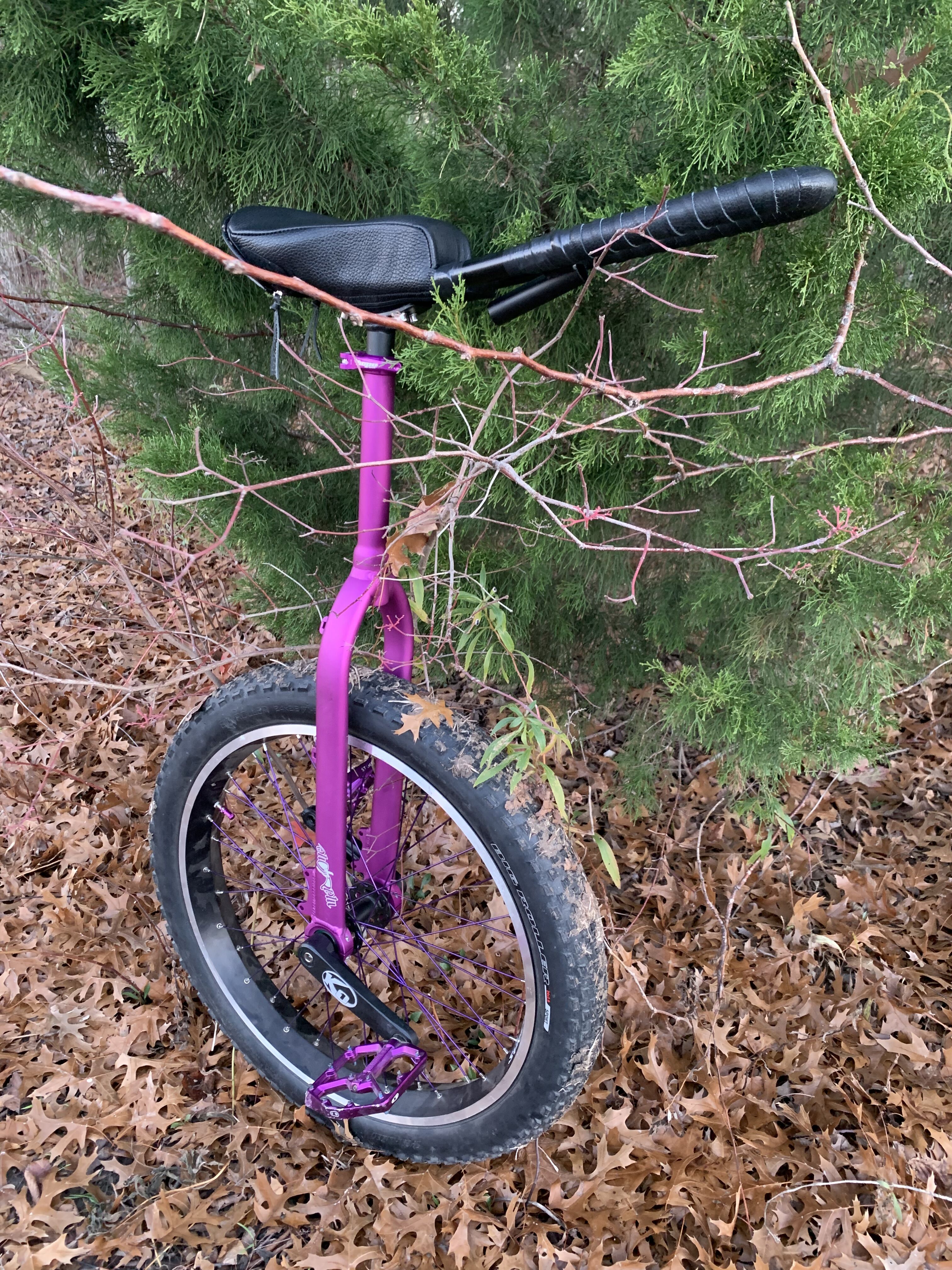

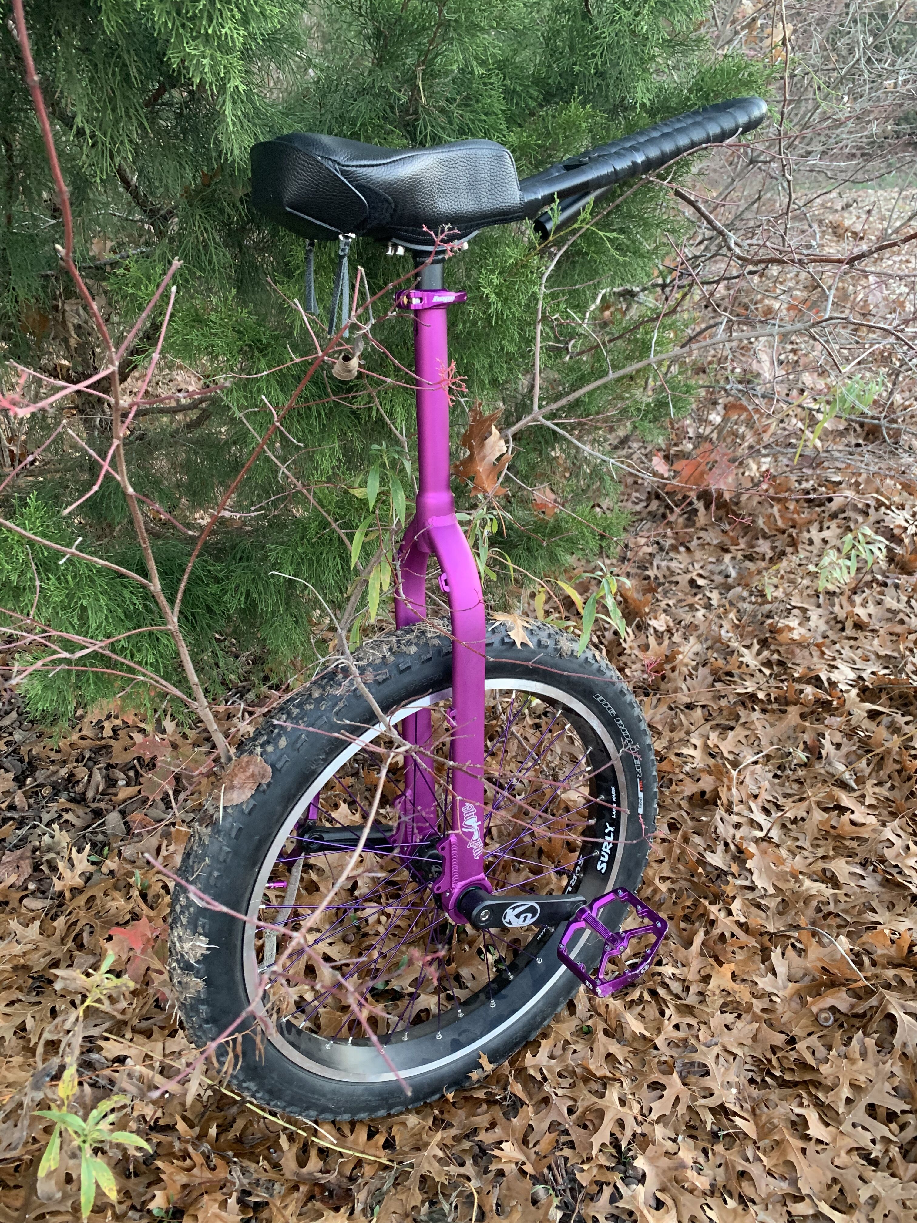

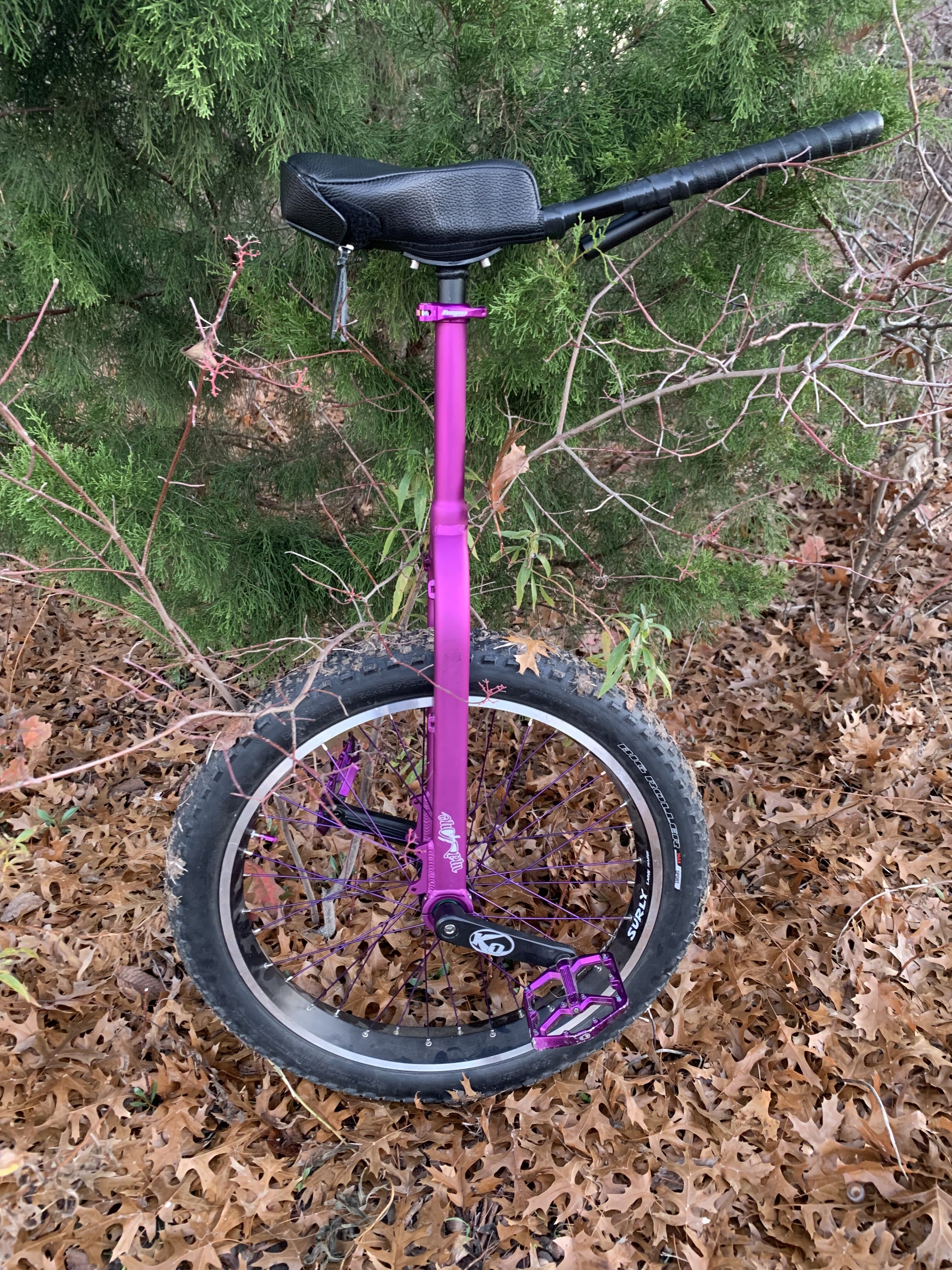

It took 15 months, but the Large Marge build is done.
I am very thankful to @authoritimmy , for donating the Surly Large Marge 24” rim for this project.
RIM
+Surly Large Marge 24” rim
From @authoritimmy
SPOKES
+Sapim Leader Candy Purple spokes
From prowheelbuilder.com
This was my first-ever wheel build, and it went very well, once I watched the necessary videos and read the necessary instructions via referral and via websites.
HUB
+Koxx/K1 (New, Old Stock) hub
From @Felgenbremse
CRANKS
+Koxx/K1 (New, Old Stock) 140mm cranks
From @Felgenbremse
PEDALS
+Crank Bros Stamp 7 purple pedals
From Amazon/Crank Bros
FRAME
+Mad4One Large Longneck Purple Muni frame
From Mad4One.com
SADDLE
+Mad4One Long Handle Saddle
From Mad4One.com
SEAT POST
+Koxx/TryAll seat post
The original seat post on my Koxx Track Monster, which was way too short. It’s perfect for this build.
SEAT POST CLAMP
+Hope purple QR seat post clamp
From Amazon/Hope UK
TIRE / TUBE
+Specialized Big Roller 24x2.8 (actually a full 3” wide)
From Specialized.com
+Maxxis Downhill tube
From Amazon/Maxxis

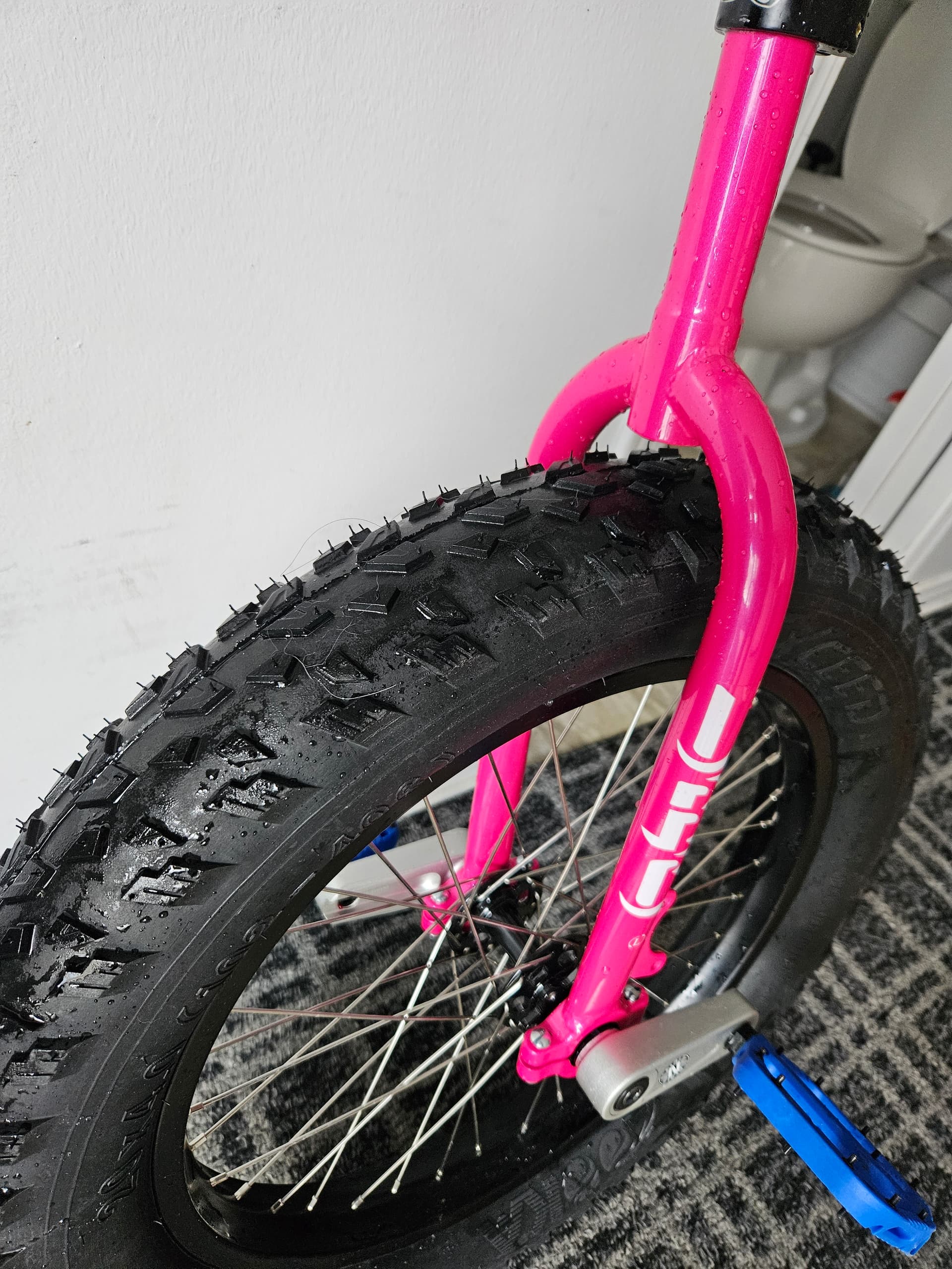

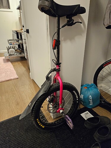

Fat tire 20" with 75mm cranks. It will be my travel uni/the one I use for strength training in the winter :slight_smile:
Because I love ridiculous builds, it will be give a disk brake and used for muni (small stuff)
I’m testing a theory that with a good brake, and riding short (75-100) cranks that are on my other unis it will control well downhill. The 4" tire rolls over everything, and the smaller wheel with tiny cranks means I can get a high cadence to ride through obstacles easy.
It’s hard to believe that a 20" x4" tire is even a thing. Who makes your tire?
Vee make such tyres. They make them for a few cargo bikes, kids fatbikes and also a handful of ebikes. I see a few such bikes here in Norway. Indeed one of my colleagues has one.
You can find a few 20x4 tyres here, though there are more than this
A lot of ebikes run fat 20" tires so there’s a few different manufacturers. You can get a few different tread patterns too. All of them are made well, but it’s difficult to find one that’s light weight.
I shall assume this is the tyre you have on it now?
FWIW the Mini Hatchet also has a tyre of that size and before that the Nimbus Purple monster.
[@Bug72 You even commented in that thread! :zany_face:]
Though that URC frame that @Sexy has would actually be a better option for an adult as discussed in the Mini Hatchet thread.
P.S. I actually have the same frame in the same colour myself (well… it is technically my daughter’s but…). I have yet to put a fat tyre on it. Perhaps I should? :thinking:
Check the rim Marco is selling. It’s a bit thinner from a true fat tire rim (I’d have to double check but it’s like 30-40 ID vs 60-80 for a 26" one.
The tire is still pretty wide though and I’m not expecting and trouble riding off road with it.
Took it for a ride to work yesterday and it can actually get some good speed on it, not as fast as my 26 or 29, but it was comparable to a 24" I’d say
In some ways that sort of makes sense. While the big tyre will be heavy, on such a small wheel it probably isn’t too bad, all things considered and the outer diameter must be getting close in size to a 24 anyway. In addition, you have such short cranks.
Might actually work quite well as a travel unicycle. I mean if you took it apart and deflated the tire I presume you could get it in a regular suitcase. :laughing:
Yeah, I had a 24" sold recently that was supposed to work for this but a 20" can fit diagonally in a carry on.
Though it is a 20" I find a fat tire is a good cheat code for traction, but have also had what I’d call similar results with a 2.8" as well. So if I do travel with it, I’ll probably look at a smaller tire.
I just have winter trails near me that require a 4" tire to ride and this will def be a work out

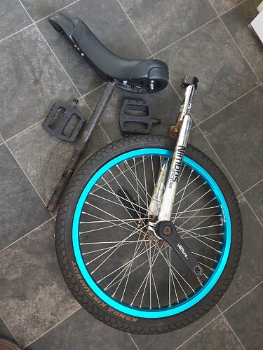

Today I picked up this beauty from FB Marketplace. The seller had the age old story of having bought it but never learnt to ride it, so to my benefit she was selling it way too cheap because she didn’t really know what she had. I paid R800 (or £33 at today’s exchange rate), which is a bit of a bargain.
It’s set up incorrectly, and I’ll sort that shortly, but for now I’m just chuffed to have a 24" in my collection.

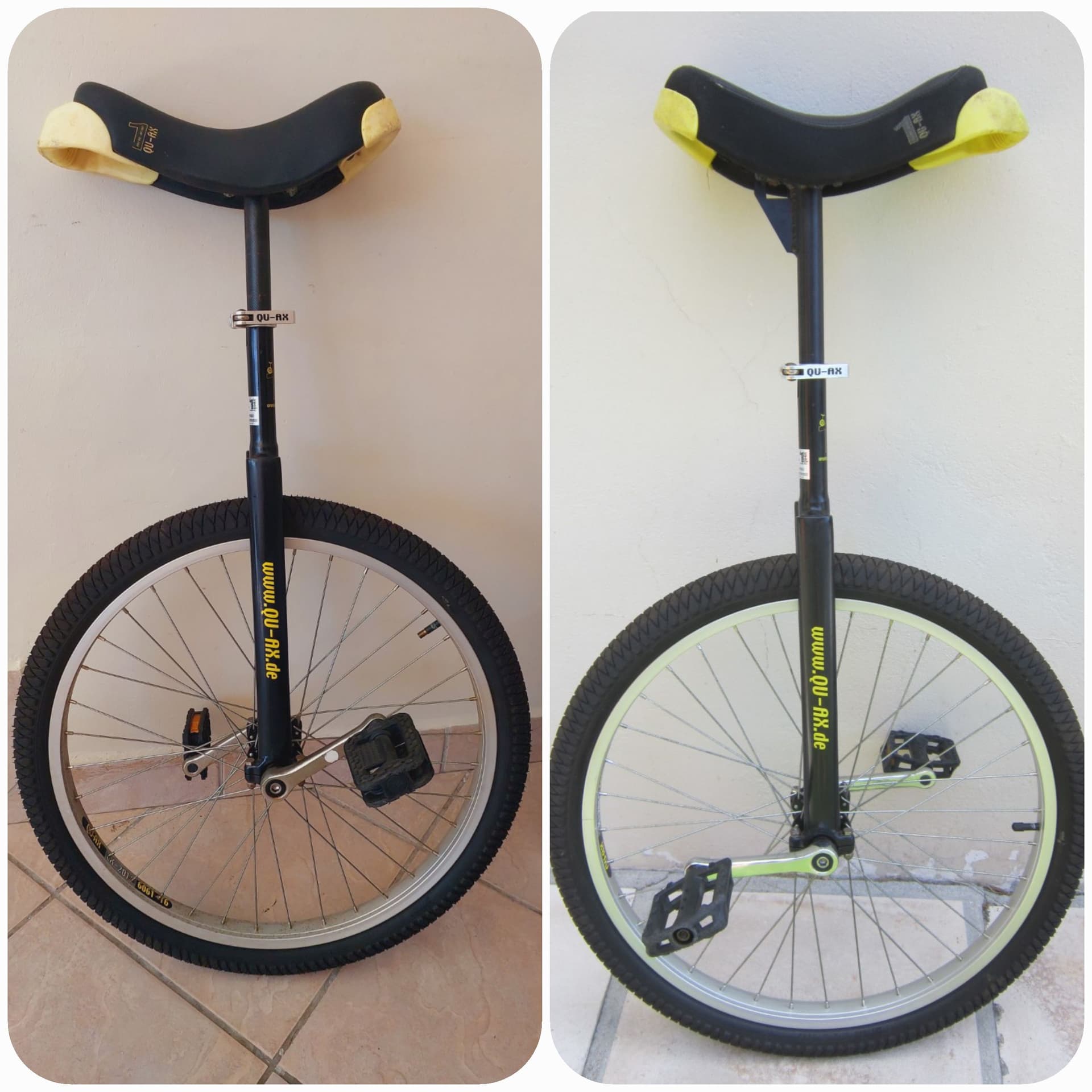

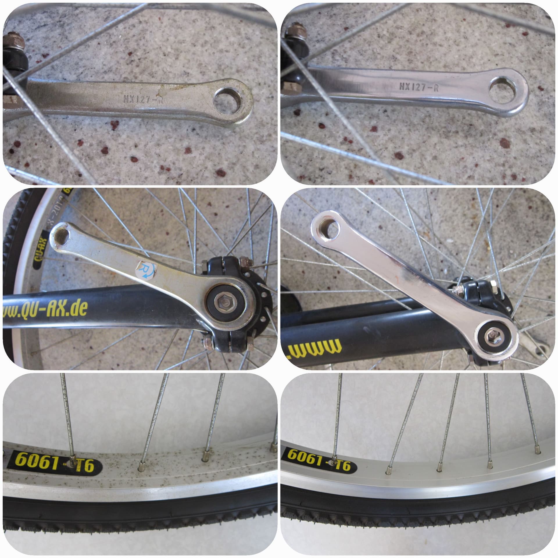

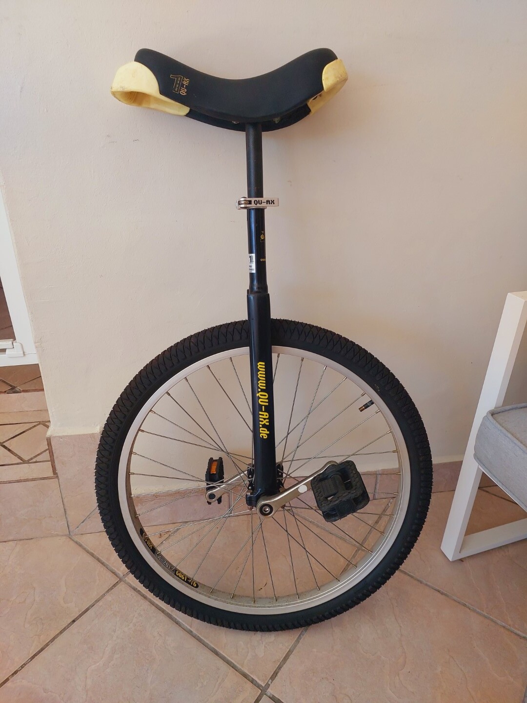

We had a prolonged power outage today, so I chose to use the time to clean up the 24" Qu-Ax I picked up the other day.
Firstly, I put on a longer seat post and made sure both the seat, and the wheel were facing forwards.
I also swapped the pedals for a pair of Wellgo I had laying around.
Next up, I broke out some metal polish to have a go at the cranks, and I’m very happy with the results. Finally, I used some engine de-greaser to clean the wheel.
Overall, I’m well pleased with the result.
Isn’t the new seat post facing backwards? As far as I remember, the reinforcement should be at the front.
I’ve seen some discussion previously on this, and came to the conclusion that it makes no difference.

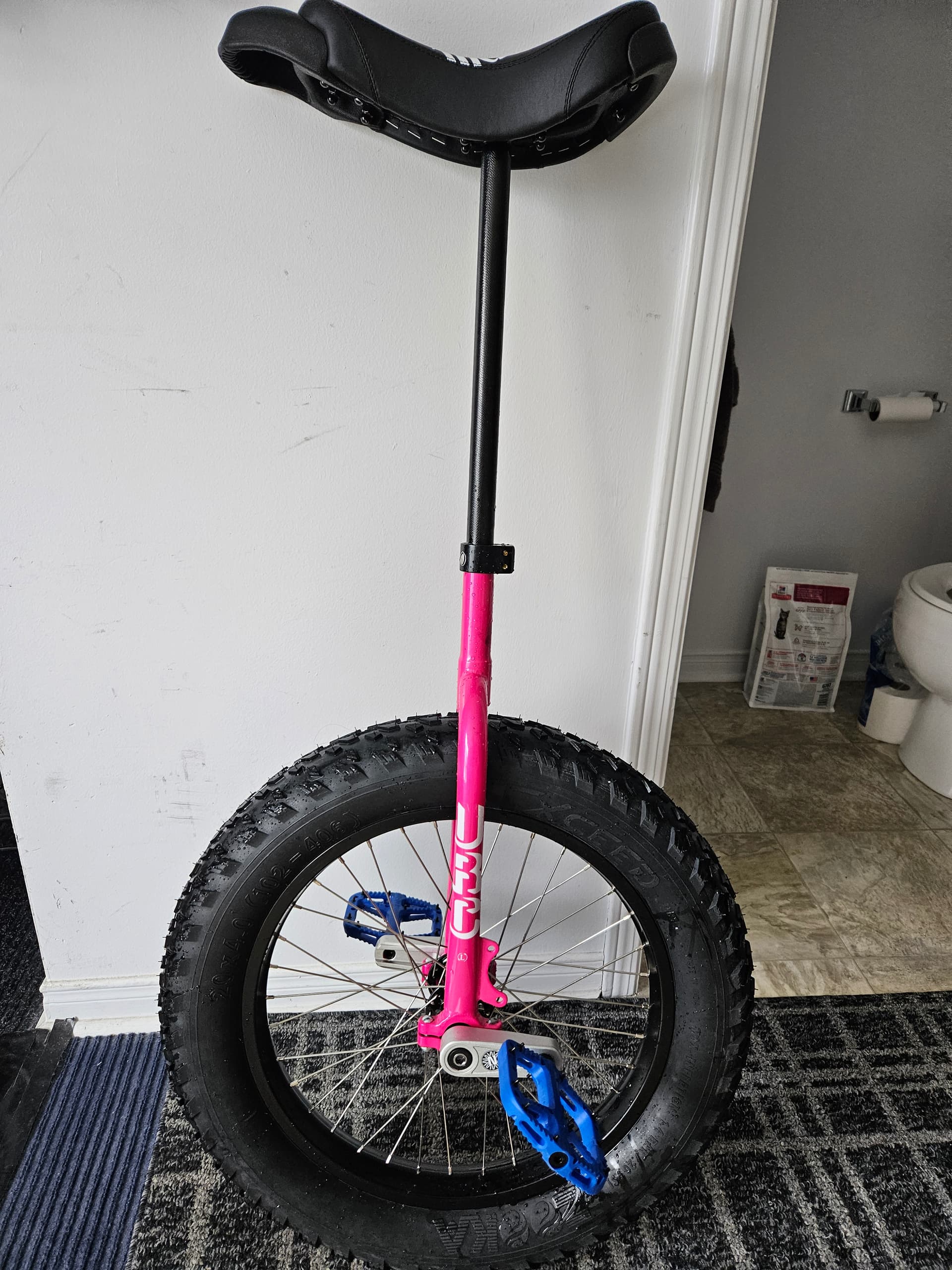

So for those who see my posts about my 29", you’ll know I love tiny cranks. I run 75mm on my 26", 100/75 on my 29", and recently I got a new 20" from Mad4one and put a set of 75mm cranks on it after selling a 24" wheel.
It currently is equipped with a 203mm rotor, basic dual piston Shimano brake, and a 2.4" Maxis DHF.
It was originally intended to be used for Muni (downhill specifically), but has started to be used as my around town uni. My 29" isn’t the best in winter conditions with snow so this was intended to help me practice riding above my usual 120rpm.
Well turns out if you spin fast enough you can get a 20" going 15kmh average. I’m calculating that I’m up to about 180-240 rpm now and have been loving this for transportation. It’s smaller and more easily transportable than my 26" but still of a good speed for getting around town.
I never though I’d be going back to a 20" after my learner but this has been a really fun uni to play around on.
Part of me loves when a stupid build comes together, and this is by far one of the best pay offs.
My only gripe is the paint Marco and the team used isn’t the most durable, but besides that the uni has been riding pretty well.
Planned upgrades are a new purple BMX rim to shave 200g off the rim and replace the fat tire tube that came with it. 20" fat tires are fun but I find the 2.4" at lower pressure rides really stable even in bad conditions.
