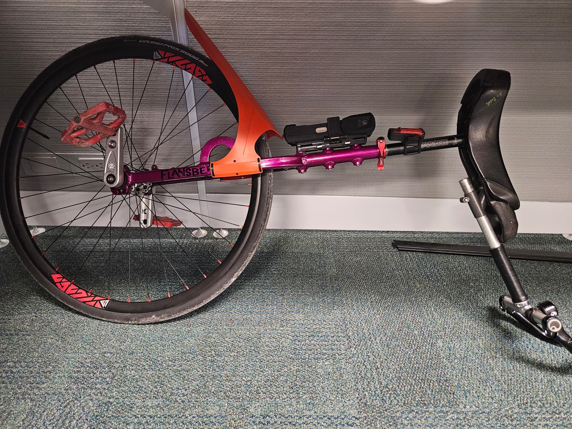

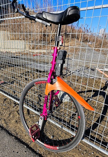

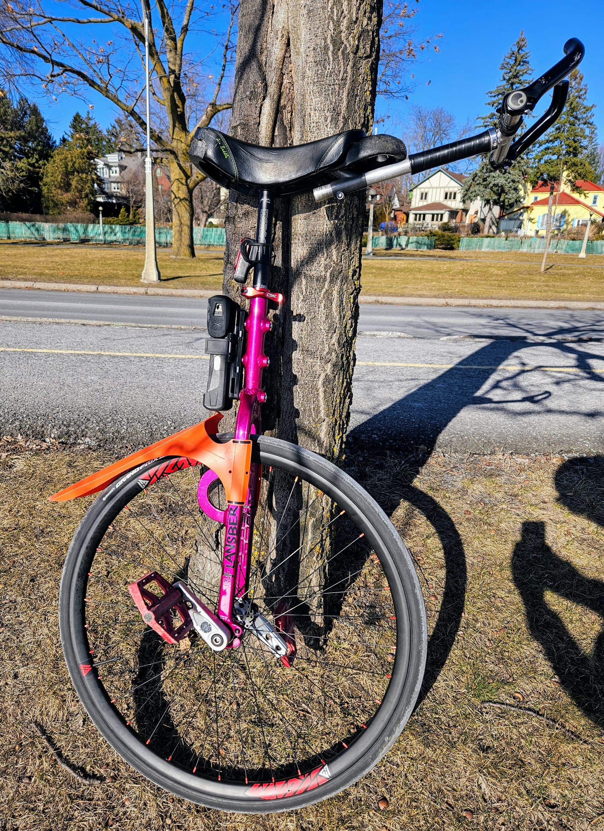

New-ish build
  1. Carbon 700c wheel, aluminum hub, 32c GP5000 tire
  2. Custom 100/75 mm cranks to go fast
  3. Red accents to make it faster (it’s science)
  4. Amazing new Flansberrium frame with a locking loop, amazing bearing holders, lovely colour, and 3 cage bottle mounts front and rear
  5. Nimbus Air saddle because I love them
  6. Custom Flansberrium handlebar.
Jakob did an amazing job with the whole build. Couldn’t have dreamed it better myself and it handles amazing while still be very light.
The whole uni with handlebar (minus the 4lbs lock) is under 4.5kg/10 lbs (9.84 lbs).
This is what I’m calling ā€œcity modeā€.
I haven’t posted about it but I’m currently also transitioning from a boy to being femme presenting non-binary. So I have been buying many pink things.
As such this build is being called Gender Affirming Care or GAC for short.
For unipacking I have a 45c tire and 2 cargo cages in hot red coming that will increase the functionality of this frame. But my first ride with the lock today felt super stable and it doesn’t change the forward/back balancing by very much.

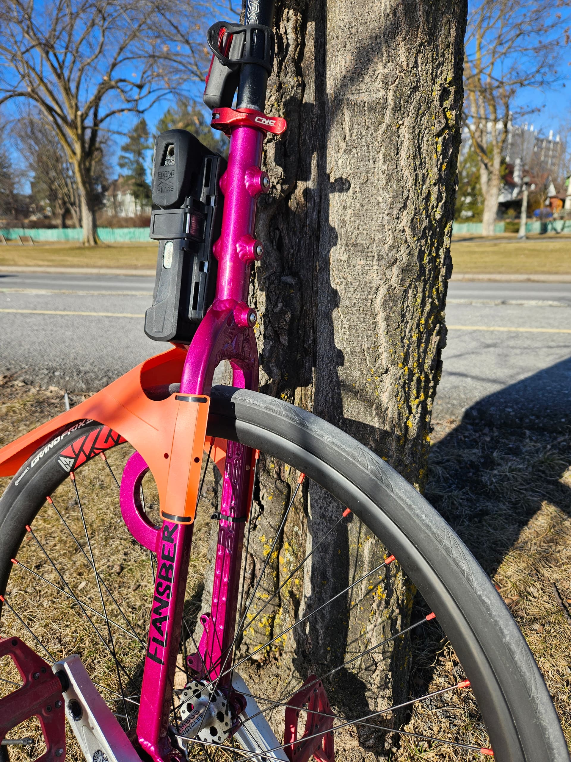

What is the semicircle on the fork intended for?
I couldn’t imagine riding this one on 75, must be clone to getting airborne :flight_departure:
:smile:
Locking up the wheel. I ride it as my main form of transportation and it can now be safely locked outside if needed.
Ok, makes sense. Nice uni!
Wow. This frame design is a really clever idea! I wish, unicycle frames came stock with bottle cage studs.
What is that fender?

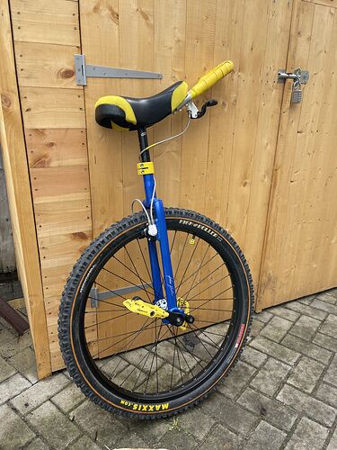

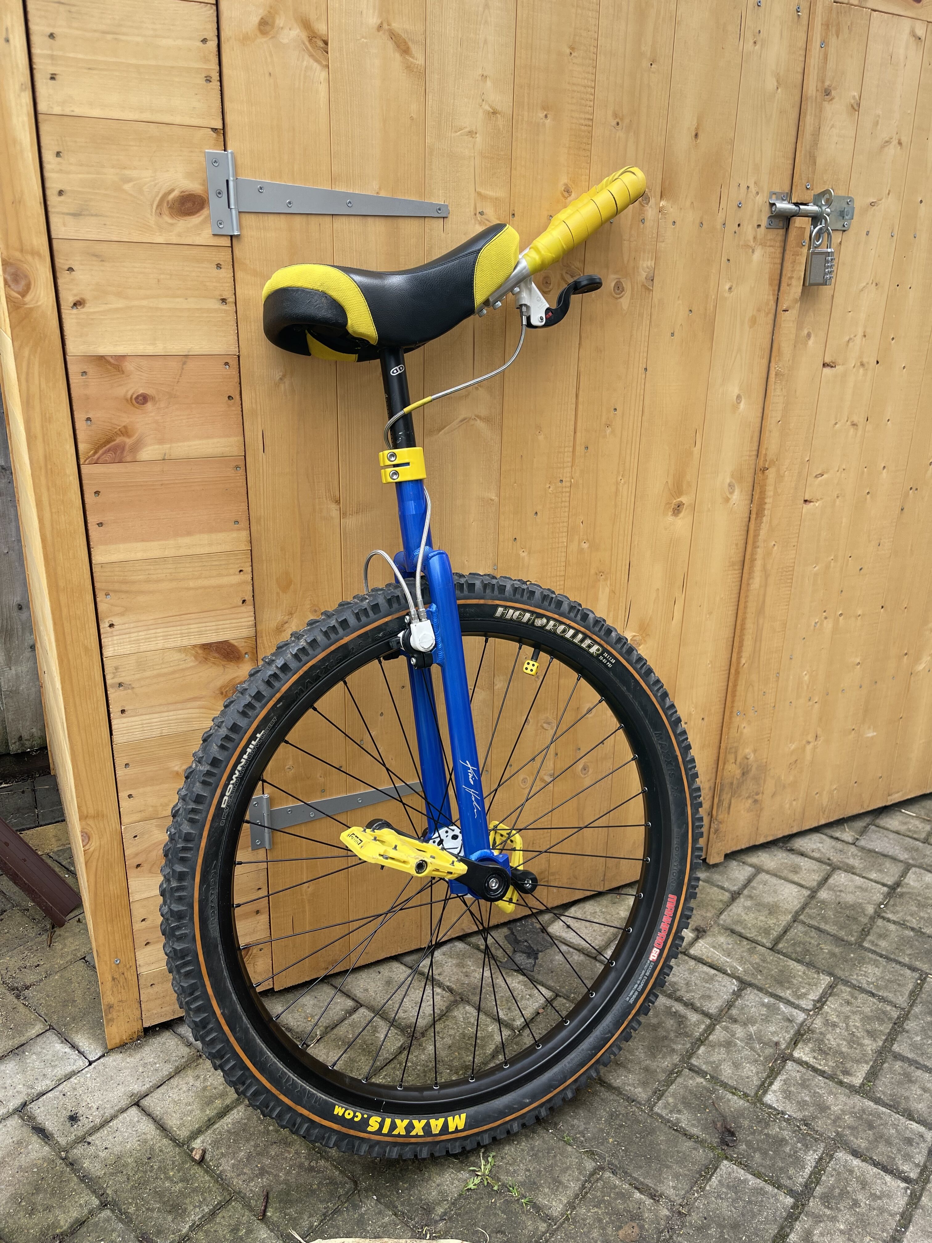

My KH G26er has changed and become a KH26er. I decided I had to experiment with the BrakeFast Schlumpf adapter but I couldn’t leave this frame / set up in bits so decided to test my wheel building skills again with this one.
Can’t say it is in any way advance - it’s not, but happily the nice Magura braided brake in white goes well with the Impact hub.
I’m so happy to have a knock about setup like this using the nice (IMHO) 26x2.5ā€ High Roller Red Line tyre. Yep I’m sticking with 26ā€ for a while I think as I got a few rare secondhand old skoll Maxxis tyres :face_savoring_food:

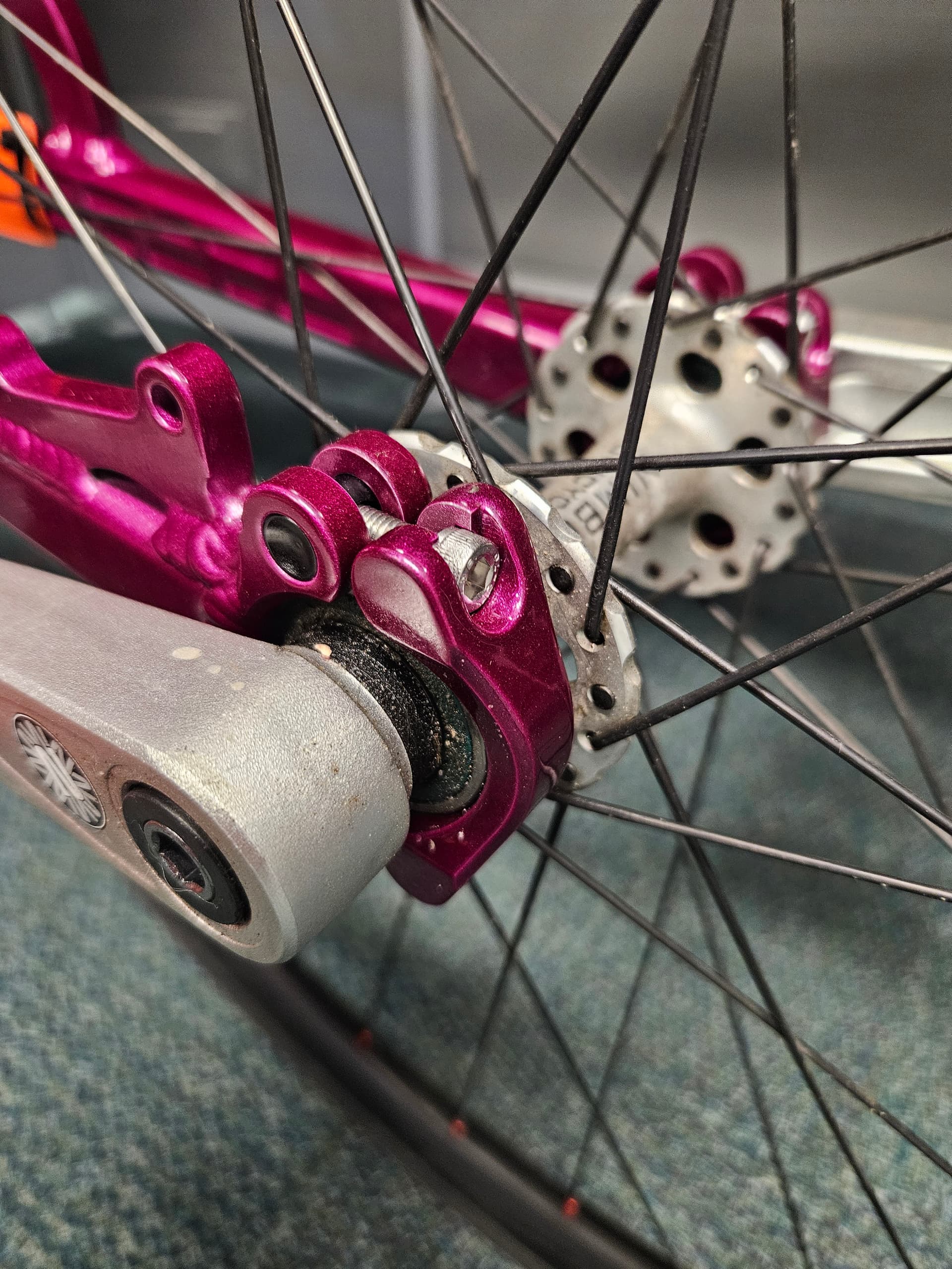

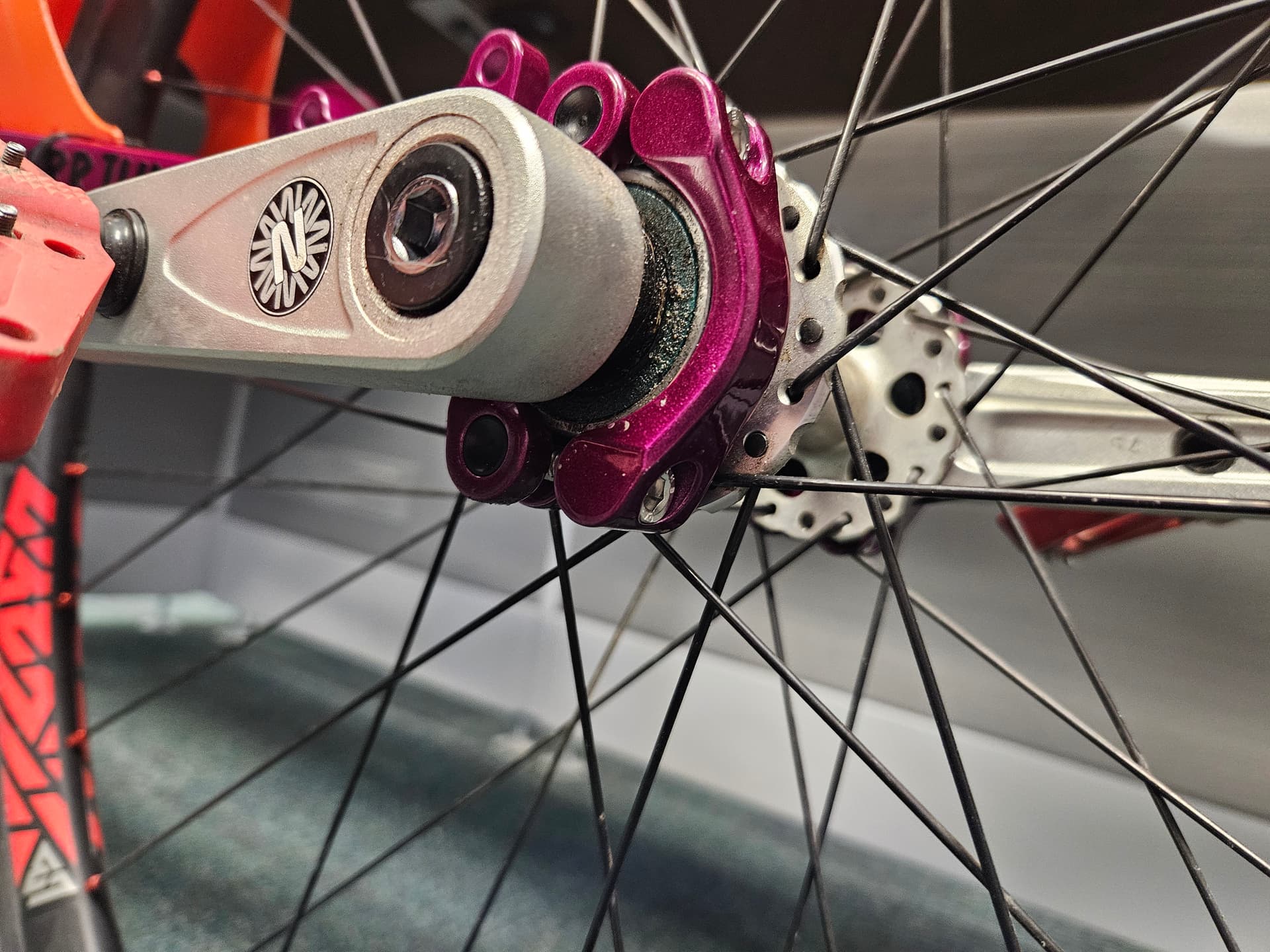

Sexy, can you show amazing bearing holders closer?
You only have to undo a single bolt and the other one swings out of the way. Very nice for crank adjustments on the fly!
Thank you, I fancy, there is quick locking clamp, like on underseat tube is.
Yeah it’s my first Flansberrium frame. Can highly recommend it. Jakob made it turn out beyond my highest expectations.

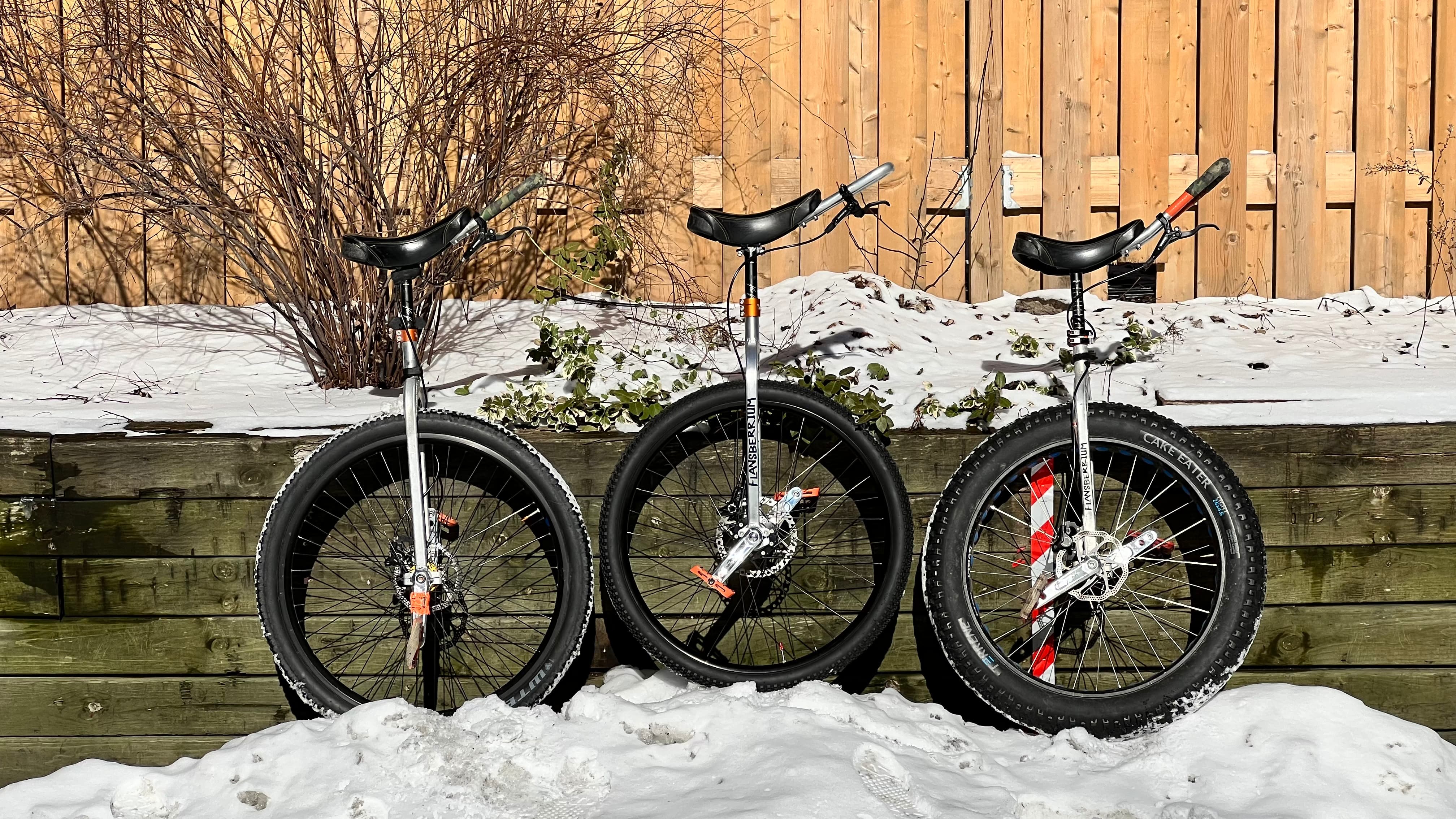

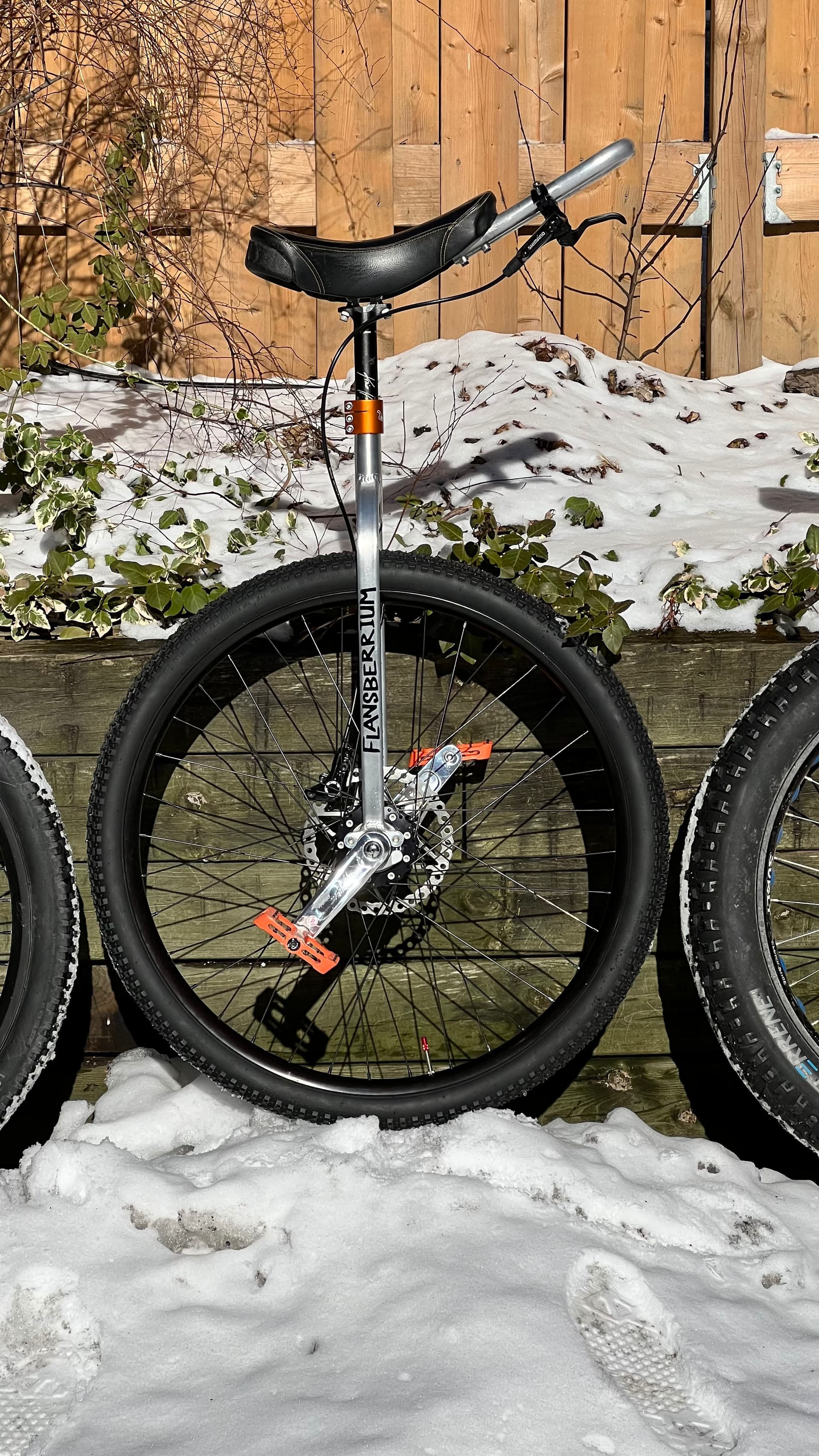

Jacob is the best! I have been riding the 29 for 5 years and the FAT26 for winters. He just made a 27.5 for my brand new Schlumpf. I like them bare metal to see the beautifully made welding.

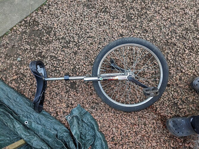

My unicycle is just a Frankenstein that grew over time. It started as a 2004 Nimbus Trials I got off Facebook marketplace a few months ago. I changed the cranks to 125mm and pedals to the generic beginner unicycle pedals. I also changed the KH saddle to a Impact Naomi. The tire and a spoke broke and I had a folding bike front wheel lying around so I spent a day building a new wheel from the parts.

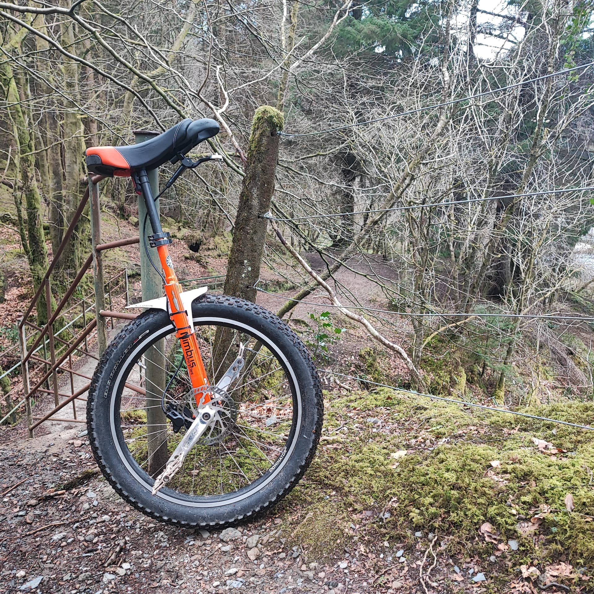

Just realised I only put 2 of today’s photos in the ā€˜latest ride’ thread so I’ll put the other one here too.
My Nimbus 2 24 muni with a specialized big roller 24x2.8" tyre, Shimano mt200 with a d’brake - it’s an older frame without a mount. Kris Holm spirit 125/150 cranks (in the 150mm position), and Superstar el Plastique pedals.

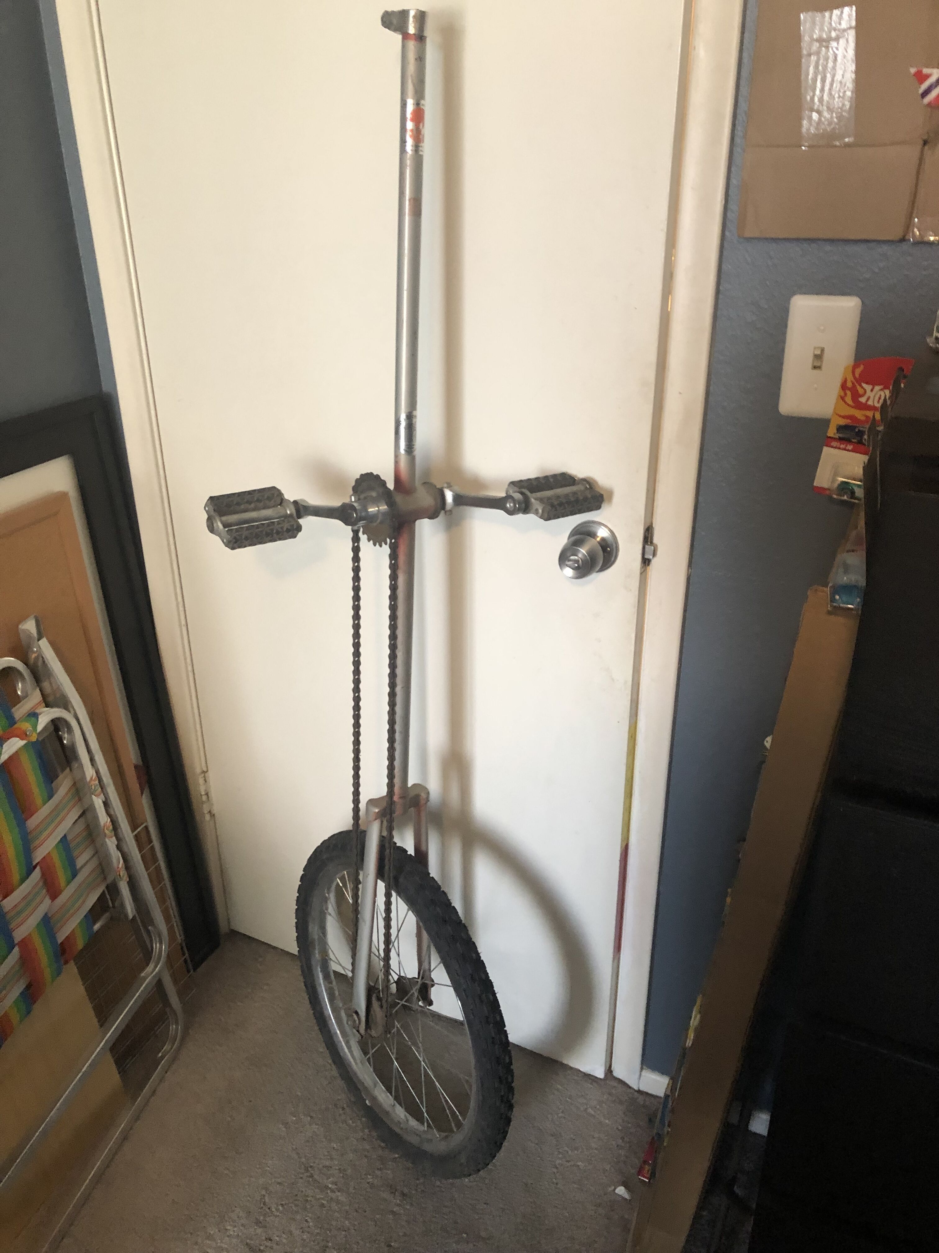

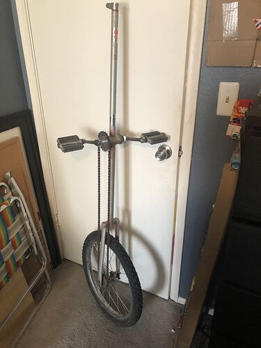

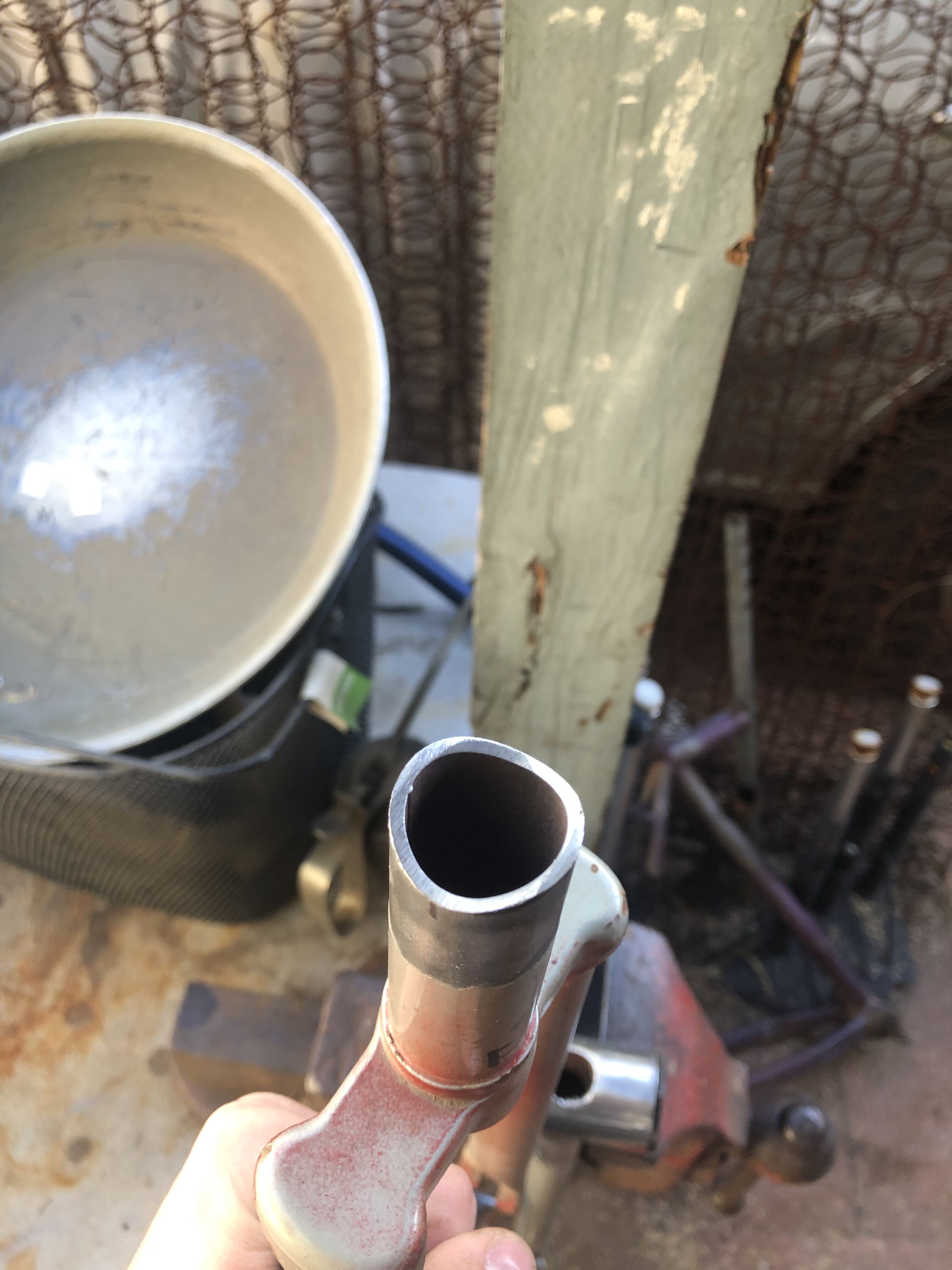

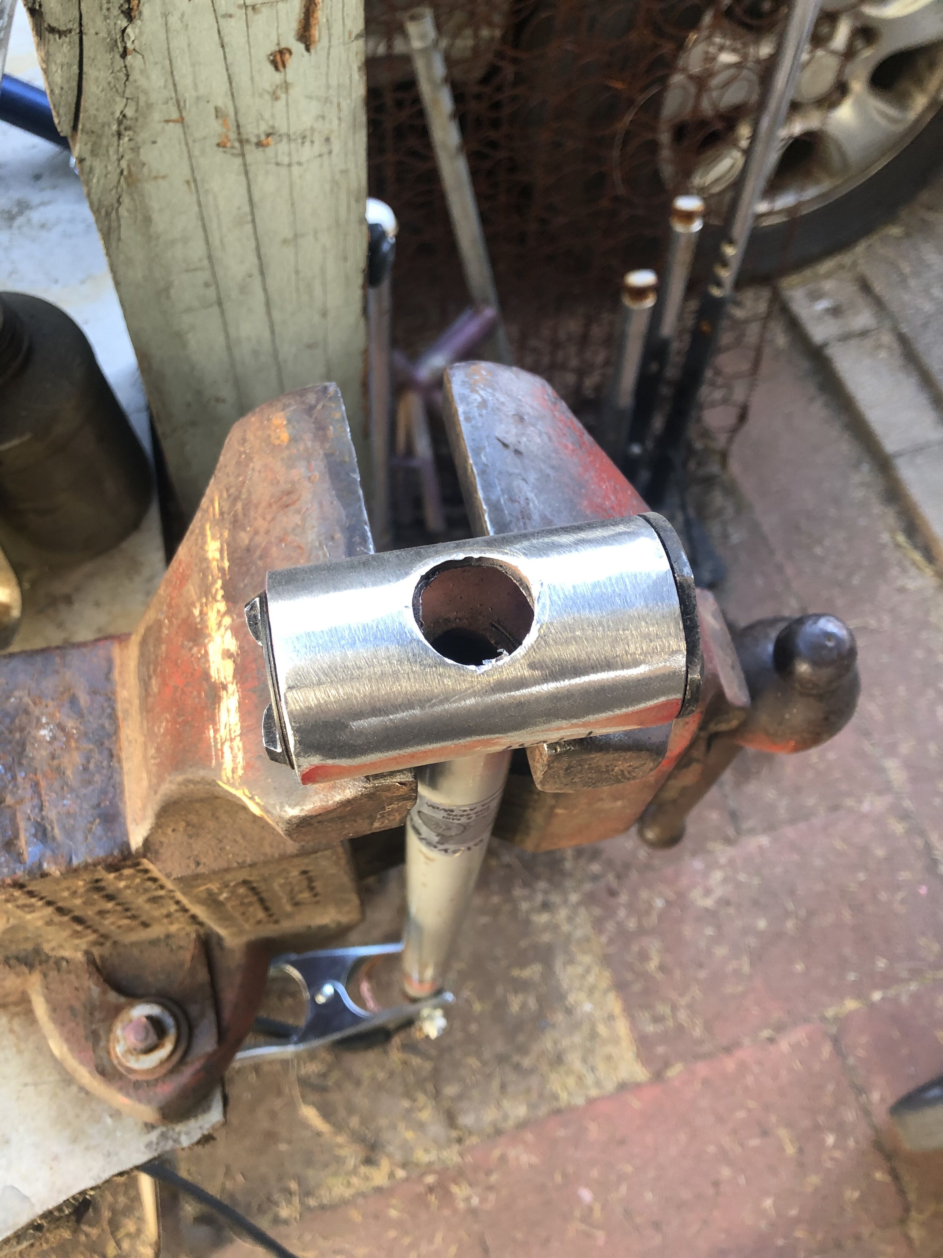

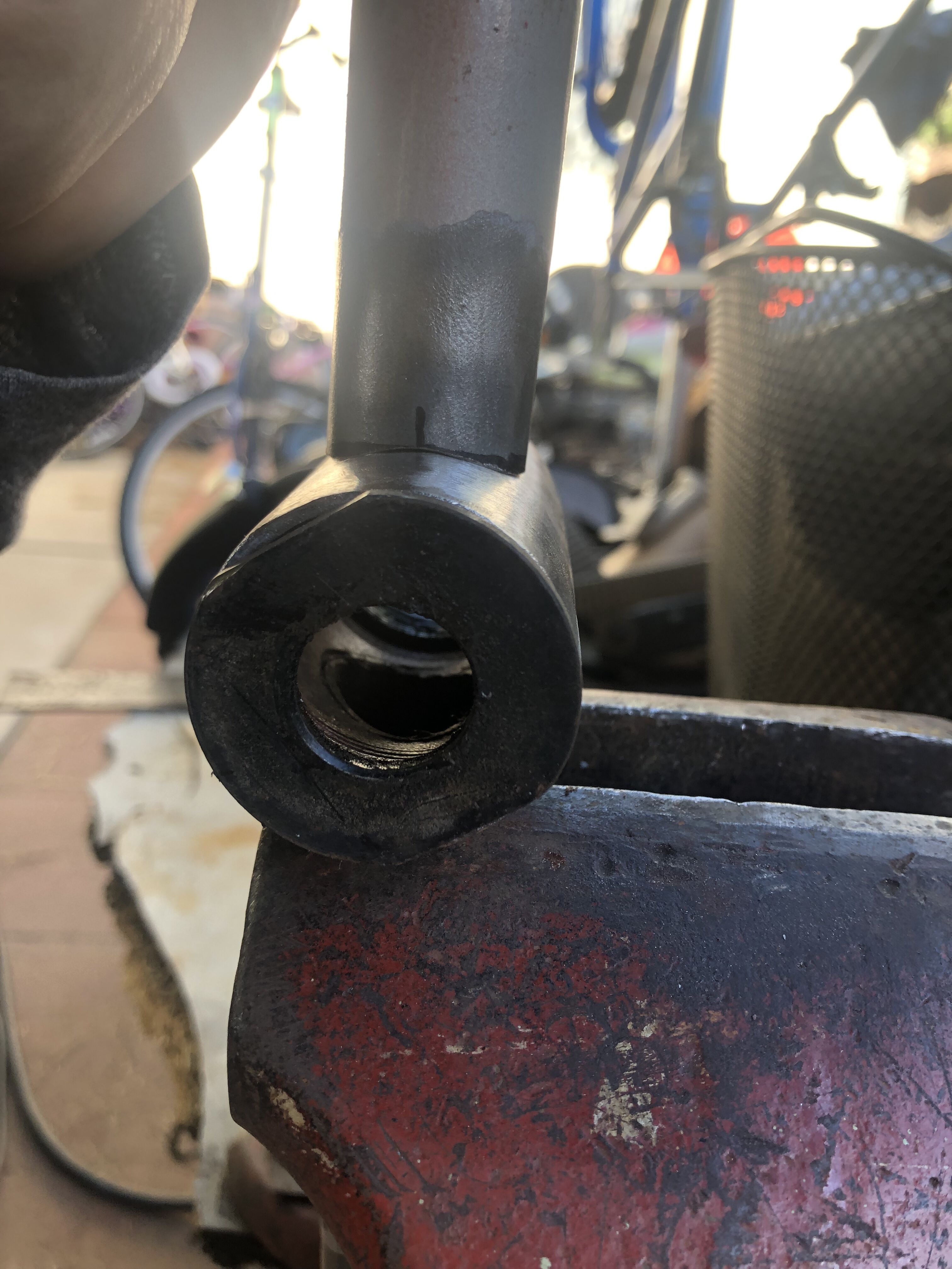

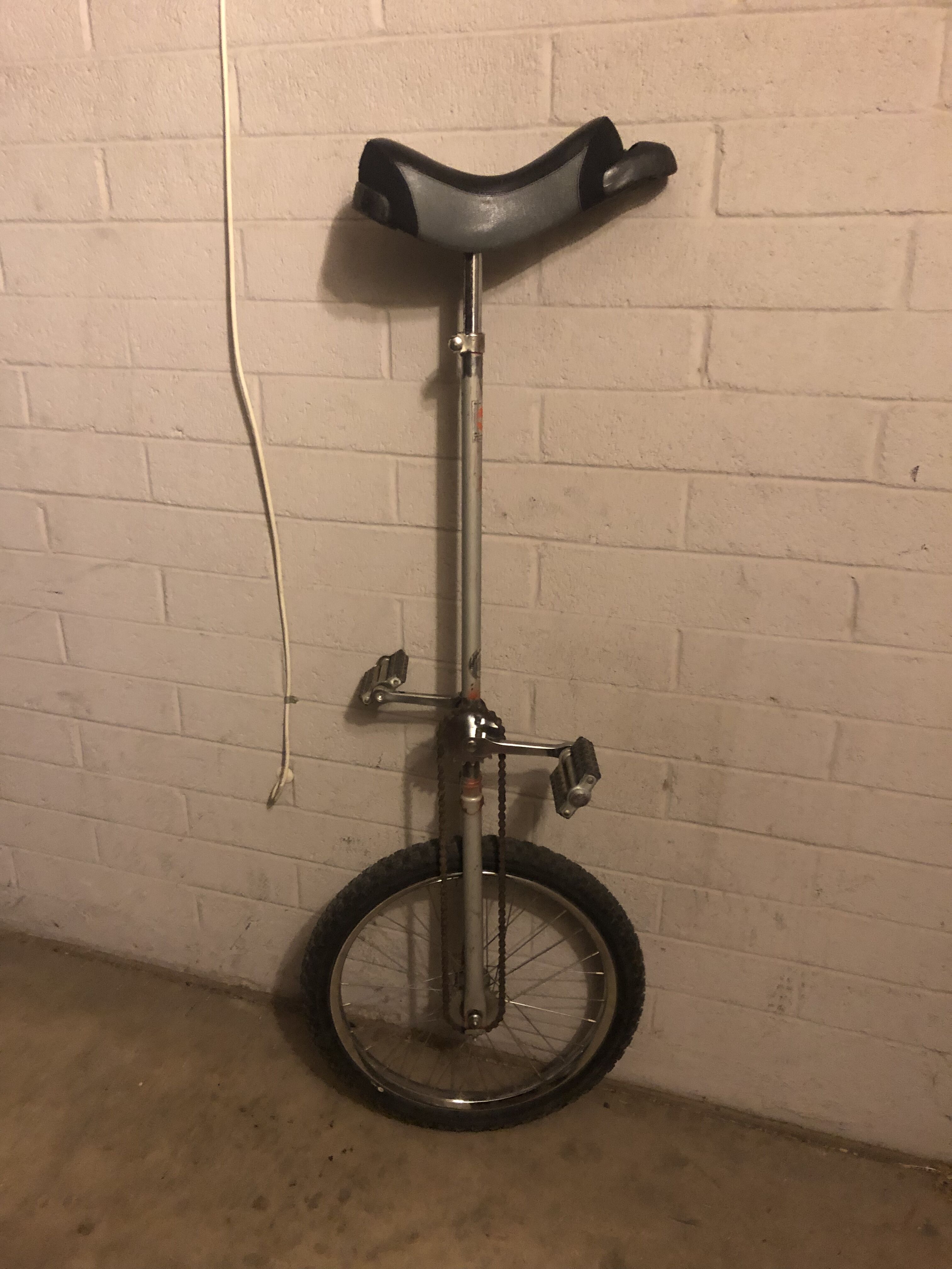

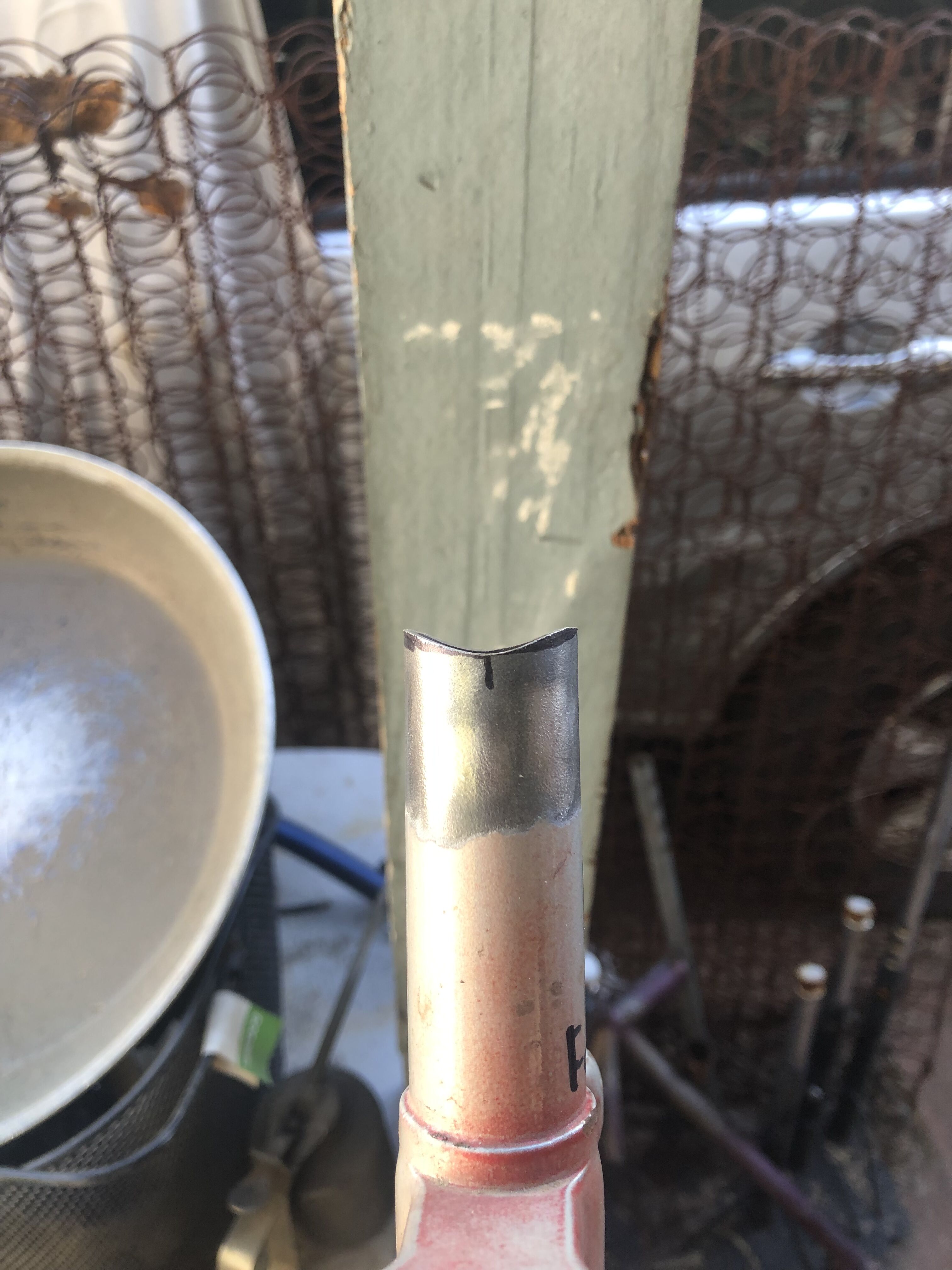

I finally cut down one of my 5ft giraffes down to a 4ft yesterday. I disassembled it for this almost one year ago and just never got around to it. I gave it a test ride and idled a giraffe for the first time.
