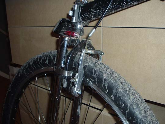

I have a V-Brake on my KH29 because I pick up speed with it going down hills.
I used to have a V-Brake on my KH24 but took it off because I rarely used it when doing technical MUni. Now I am going downhilling old Garbage mounds. ( Usually about 30 to 60 meters high with a 60% incline!) I am thinking of putting a Magura on. Chain reaction bikes does have good prices.

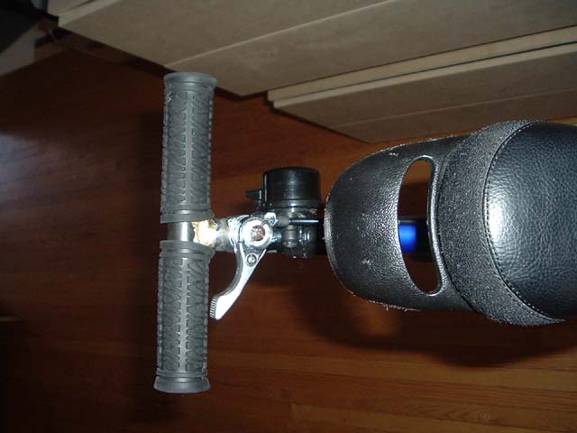

I use a drag brake on my 29er, I ride road and like hills. The parts cost me about $20.00 at the used bike lot. I use a gear shift rather than a break leaver so that I can set the brake and not have to hold it on long hills. Here’s how I did it.
Dave
I think a drag brake is a great solution for roads, but not so much for muni where you are constantly feathering brake pressure (or should be anyway).
