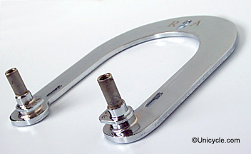

At a unicycle event I went to in Germany, there was a couple of guys who had 24" uni’s with V-brakes on them.
I couldn’t and didn’t speak to them, but watching them mount, they locked up the wheel and stood on the back pedal to swing over the seat. Strange.
I’m sure you can get clamp-on V-brake bosses, or even weld some on.

V-Brake Adaptors
I posted a thread about half a year ago about maguras being to expensive.
Regular bicycle V-brakes work great. I used Mission 4bolt adaptors to do the work. They give me more than enough breaking power.
http://www.bikedock.com/posit/shop/search.php
I forgot to mention.
I forgot to mention that Woodman also had a Magura to V-brake adaptor but it is nicer but much more expensive. The Mission adaptors cost about 7 British Pounds per pair. I actually took the brake off of my Onza 24 and KH24. i just don’t use breaks on technical trails. I have keapt the break on my KH29 and it is great for keeping control down big hills.

Yes you can get adaptor blocks to mount V-brakes on magura mounts. However, I strongly suggest you check ebay for maguras, there are usually several sets going cheap at any one time. My two pairs cost £14.50 and £10.50 each, this is probably cheaper than getting a set of v-brake adaptors and buying a v-brake. There are also issues with hitting your knees on the protruding v-brake arms, causing the brakes to come on unexpectedly, which is no fun.

The knee knocking thing - I’ve never heard anyone who has actually ridden with v-brakes who has experienced it turning the brakes on. You need quite a bit of force to brake, I’d be surprised if you could do it just with your knees.
Some people however, either because of the shape of their legs, or the positioning of their brake mounts, can’t use v-brakes on their uni, because they rub on their knees or knee pads. I know John H tried v-brakes, but they rubbed on his legs too much, he has some custom welded mounts, which work okay for maguras, but aren’t in the right place for v-brakes compared to his legs. On my Schlumpf, where I’ve got them, I never hit them, and I know a few people who have them on their munis with no problems.
V-brakes have some big advantages, particularly that the cables are nice and durable, and don’t get pulled out at the ends when you crash, and you don’t have to worry about them when you dismantle the unicycle for travel. You can also mend them while on trips without having to find somewhere with magura stuff, every bike shop has a brake cable to sell you.
But pricewise there’s not masses of advantages. If you add £7 to the price of a v-brake lever + a v-brake, you’re close to the cost of buying a Magura HS11 from http://www.chainreactioncycles.com (who ship internationally), or an HS33 off ebay. Do HS11s work on unicycles? Although v-brakes are often available for cheap or free if you know someone who has upgraded their bike to discs.
