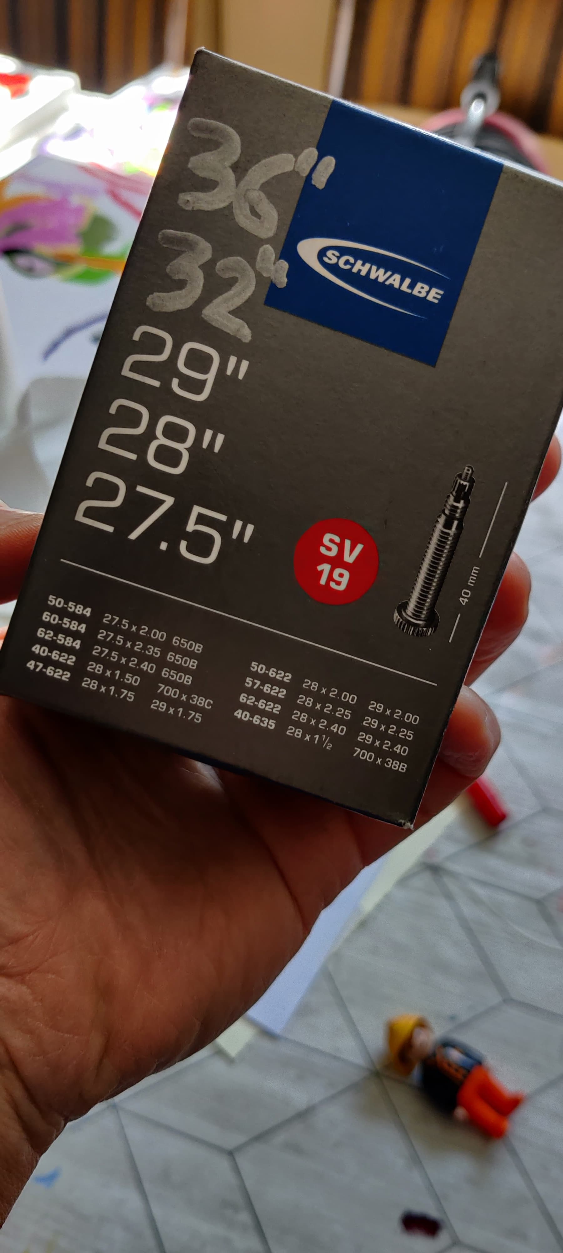

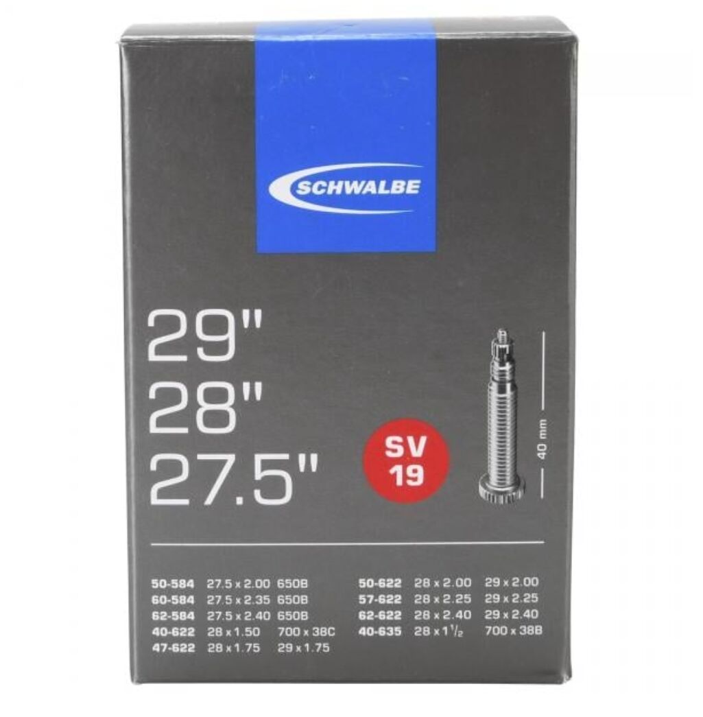

I need help with the tube. I’m still testing the wheel so won’t mess with tubeless and I need to remove the tire+tube every moment to check those hell of rope spokes. I read about the Schwalbe SV19 model… but I cannot understand what type exactly. There are too much flavours: 1. 27.5/28/29 type (the same tube expances for all sizes) 2. 29/29+ Air plus (which seems stronger and it is used for cargo bikes, maybe less stretchy) 3. 27.5+/29+ free ride (which is the only described to 29x3)…
Which one are you riding for a 36er with presta hole?
I’m using the SV19. There is only one tube with that model number.
The other you are refering to is called SV19AP (air plus) and SV19F (freeride).
Is this one-size fit all?
Might as well be… I put a 24” inner tube into a 29er and a 29er tube into a 36er. Both seem to work fine.
It seems mine has an updated packaging, but yes that is the correct tube… :wink:
