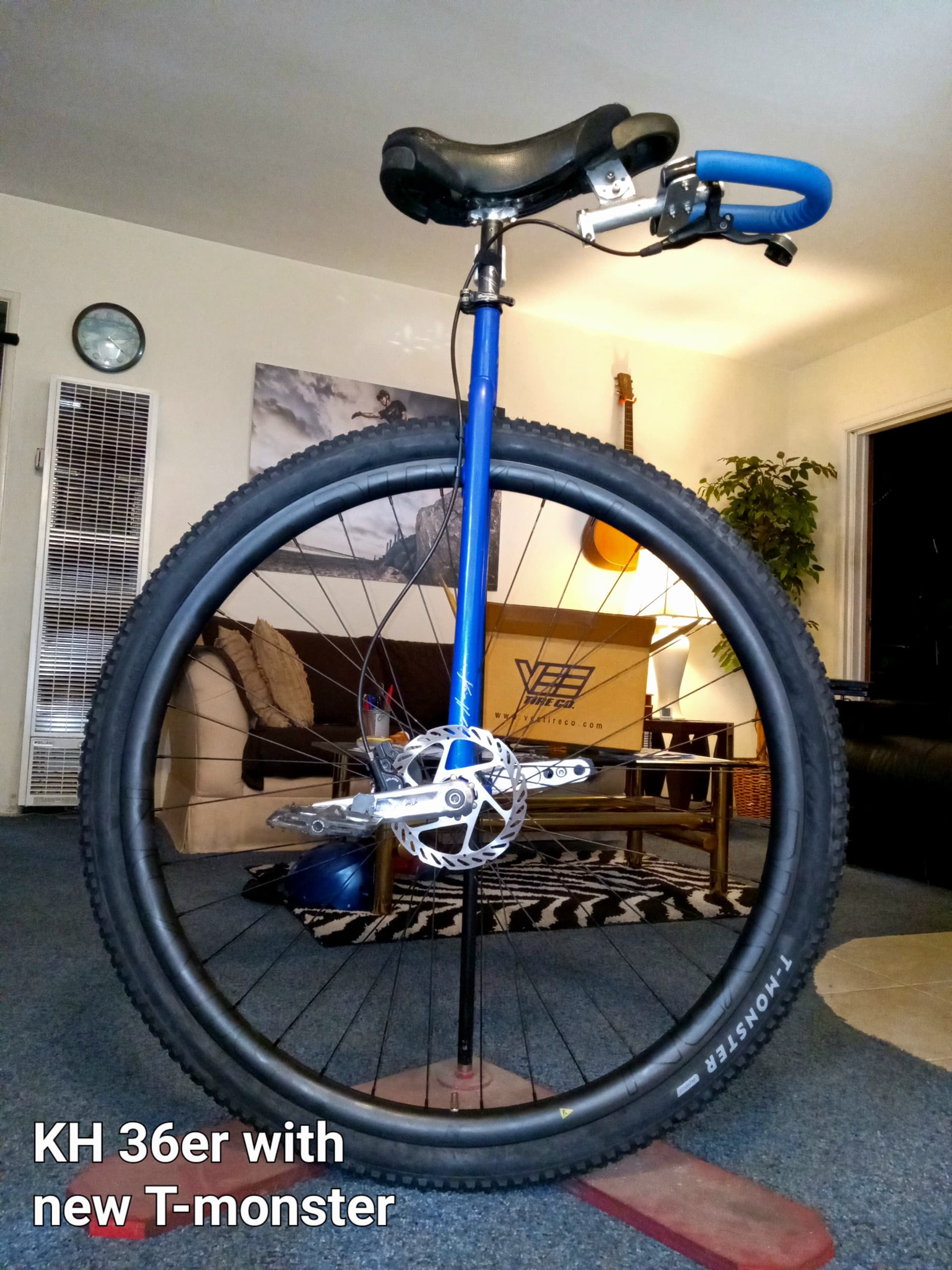

After what seemed like an eternity, my T monster just arrived today. I was lucky to get it shipped directly from Vee tire co, ahead of arrival at bicyclebuys.com , where they will be available soon. All remaining Vee tire stock of the TM has been shipped to bicyclebuys so keep checking their website, or you might also be able to pre-order.
Im just hoping that the TM will stay on the rim at higher pressure!

Now that I’ve had time to ride it, there’s a big problem. On level, smooth and even ground it pulls HARD to the left. Here’s what I’ve done so far to try to correct the issue, all to no avail:
1: inflated to various pressures: 40, 45, 50, 55, 60.
2: flipped rim
3: changed frame
4: changed saddle
5: turned saddle left & right of center
6: changed crank lengths
Wheel seems dished correctly (non disc hub) and is centered in frame. Tire is perfectly seated to rim with even bead all around and spins true.
Edit: switched tire around so the tread direction is reversed and now it pulls to the right. This would seem to confirm that it’s definitely a tire issue and not anything else I listed. So now the question is, what now?
Suggestions welcome.

It’s the curse. There’s no fixing that.
Should be ok as a Muni tire.
Two things yet to try:
  1. Mount the new tire on a Stealth2 rim/wheel.
  2. Try a different inner tube.
I highly doubt there will be any difference in behavior though. Sounds like a manufacturing defect in the tire.
Just seen your edit. If it’s pulling more to one side and is definitely the tyre, then I’d email Vee and see if they can send you another.
One side should not be different to the other. That sounds like a manufacturing fault. Is one sidewall noticeably more supple than the other? Slightly more tread I’d expect to be less likely to cause such an issue.
