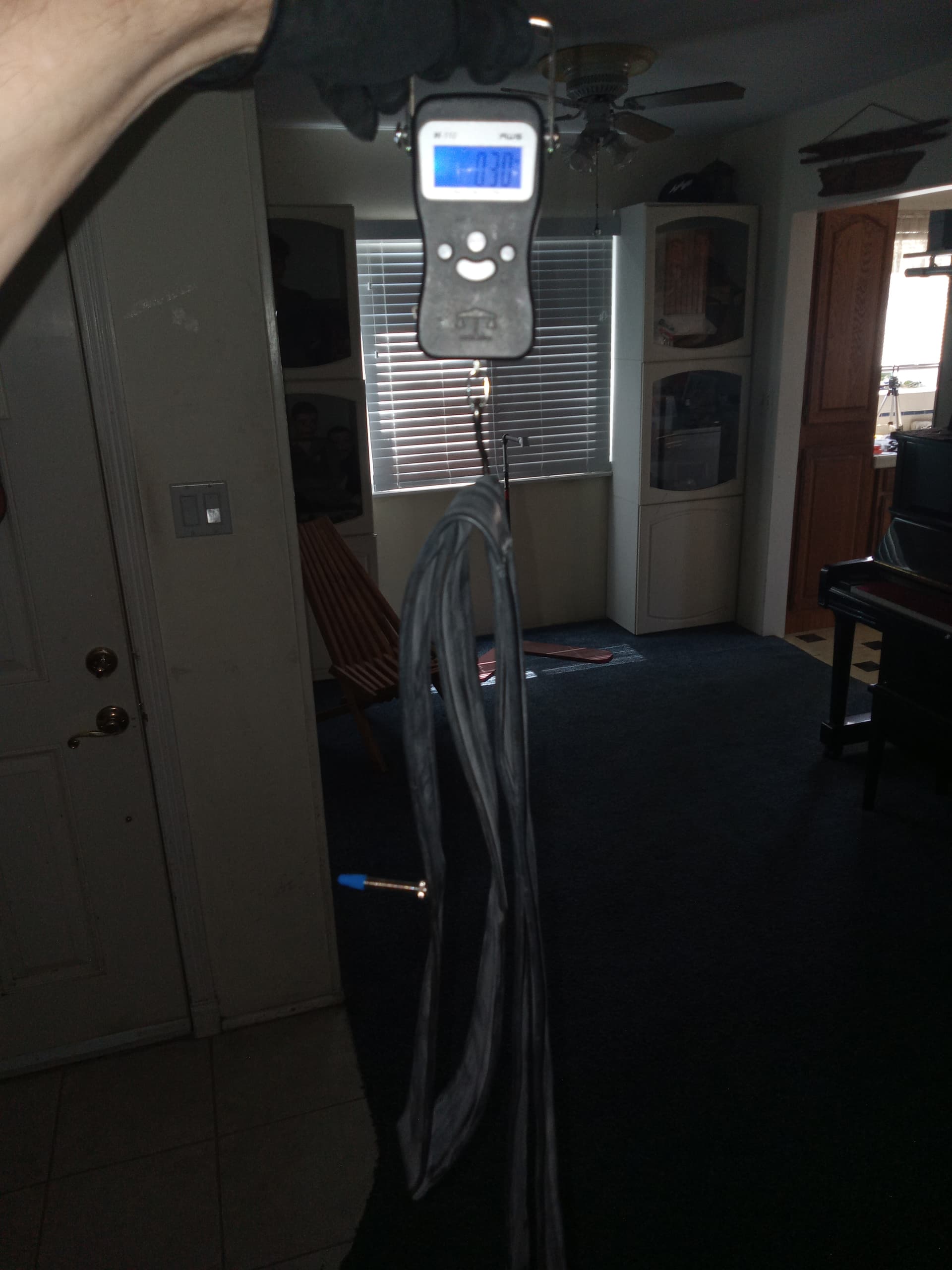

I get 11oz (.3 kg, 300g) on mine, brand new out of the box.
The one I received from Bicycle Buys was 324 out of the box.
Interesting that there would be so much weight variation in a tube. Either that or some scales are less than accurate.

For reference, the Foss 36" Presta tube I have is 254g.
