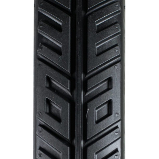

What I’m really wondering is if the King George ultimate (lite) would be equally as compatible as the TM, especially since it’s considerably lighter than the TM, and also because it has a more road-specific tread design which probably translates to lower rolling resistance.
No, it’s the same casing as the NR Lite.
So the KG would have the exact same fit at the NR? Maybe the NR’s BSD is slightly larger due an error in its specific mold, and not affecting the KG. But if the carcasses of both tires are the same then the tread design wouldn’t really make a difference in the fit of the tire.

1: The King George ultimate is the lightest 36 inch tire on the market, which translates rotational weight.
2: it has a more road-specific tread design than the TM.
3: If it turns out to not be compatible with the Nextie rim, I can use it on my standard 36er setup with the Stealth ll rim.
4: A new 36er tire to try.

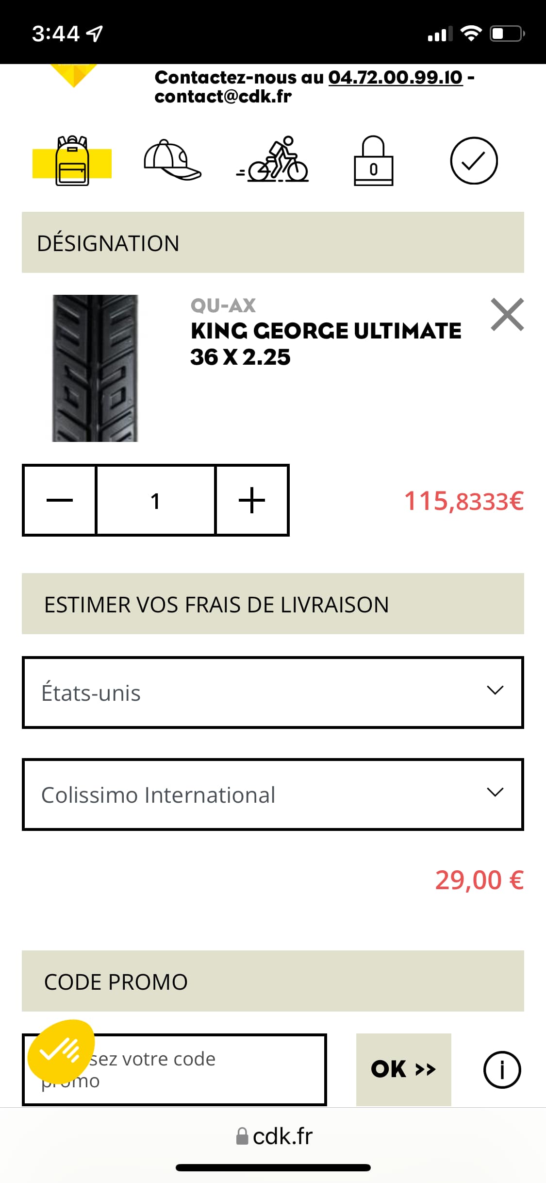

Romain has them at CDK:
https://www.cdk.fr/king-george-ultimate-36-x-225-31077.html
They say they ship internationally. Might cost a lot though.
Looks like 29 euros to the United States. I’m guessing/betting Terry will pull the trigger on this one. :grin:

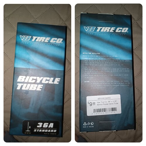

Just got the vee tire 36er tube delivered today, and it was just $9. These are hard to come by right now but I think there’s one left from this seller:
Thanks, Terry! Someone bought the last one before I got there. Oh well, gotta be quicker I guess.
I found one here (pre-order, 4/18/22 expected in-stock date):
https://www.performancebike.com/vee-tire-co.-36-bike-unicycle-inner-tube-presta-2.25-40mm-bu0343/p1306109
Thanks for the prompt, Terry!
Dang! Sorry about that. The good news is that it looks like they’re going to be back in stock soon, at least I hope that’s true.
You can pre-order them at Performance Bikes. They’re $8.99 and it says they’re expected to be in stock by April 18th.
Thanks, Terry! We are on the same page, I guess! I found it at Performance Bikes right before you posted the link. I haven’t yet posted my newly adopted Titan 36er, but will soon.
