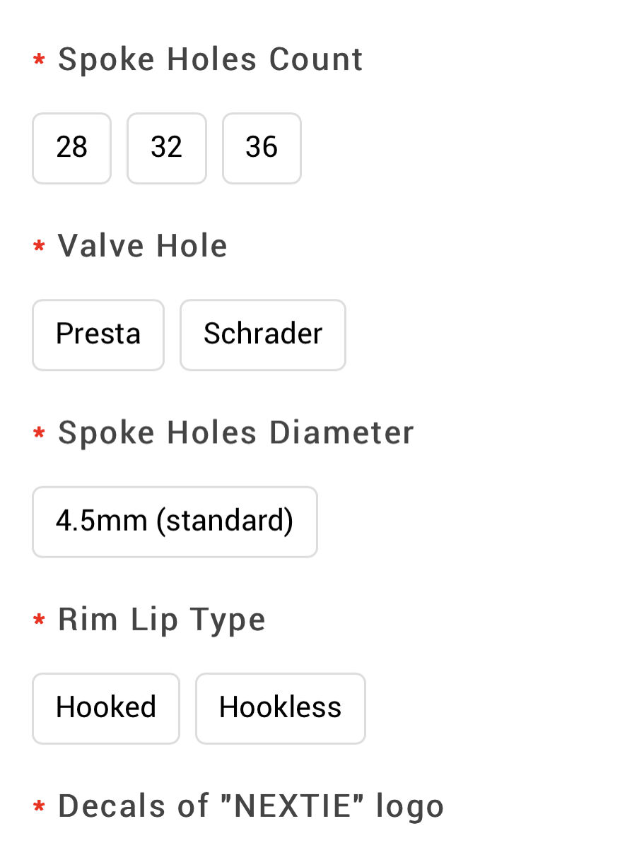

They should give you the option of drilling the rim for a Schrader valve. The 32 foss / night rider light tubes have along valve stems.
I believe they do give you the option if you ask. It’s pretty easy if you have a drill to enlarge the hole yourself. I’ve done it with several rims without issues. Presta Valve holes are typically 6mm in diameter and Schrader holes are 8mm in diameter.

Nextie do offer it with that option now - as I think it must have become clear that for some regions / build options Schrader was the only option.
I would presume this does mean there’s no reason why it can’t be drilled - naturally you’d prefer it done on their factory but it seems encouraging as an option.

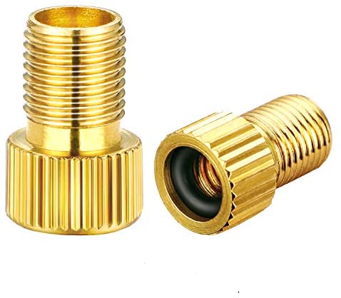

You can use a Presta valve in a rim that’s drilled for Schrader. You just need a $1 adaptor.

I use these adapters.
