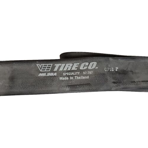

The fault is probably using a 29er tube. The rubber of the much smaller and thinner tube gets stretched to the point that it can too easily rupture. Also, when stretching a 29er tube onto a 36 inch rim, even if it looks okay on the outside, the tire could still be impinging on the tube at some point, unseen from the outside, and may not blow right away but rather be like a ticking time bomb. This sure sounds like the more likely reason.

Sadly on 36" tubes the supply around here is zero for Presta ones (which is what this rim’s drilled for).

Vee Tire T-Monster 36" works with the hookless rim according to Nextie (and my own experience - it’s actually my KH36 that is pictured on the Nextie web page). I have not experience any issues with it at all. Using a stretched Schwalbe SV19 tube inside.

I think the main risk of running a 29er tube on a 36er rim is that the smaller tube lays flat and snuggly against the rim, making it hard to get it out of the way of the tire when installing it. Even if it looks ok on the outside, all it takes is the slightest impingement of the tire on the tube and then it’s not a matter of if, but when it will blow.
As has been stated many times, there are no TR 36er tires available and trying to run tubeless is not recommended. The carbon rim, lite tire(s) and vee tire 36er tube cut weight significantly without risking a sudden — not to mention messy — blowout, that could result in serious injury. The last thing I want to worry about while riding, especially long rides!
Btw, the NR will not work tubeless, unless you run a “ghetto” setup. Again, not recommended.
I found that the Michelin AirStop 29" 48-62 (1.9-2.5") does seem to extend more than it expands, so I blew it up a little before fitting. This helps to limit the potential for trapping it, and I’m not sure the risk is any greater than with a 36" tube.
For the amount that I massaged it and moved the bead around before initially inflating I don’t think my initial issue was it having being trapped or damaged, more that it was just a stretch too far as I was asking it to stretch in both directions more than its rated size.
I’m in the same camp as you though - saving over 500g is enough. I’m happy enough using a moderately light tube rather than trying to go tubeless or really stretching the limits of what you can get away with.

Yes, and also the fact that the Nextie is wider than the Brauss which means that a 29er tube has to stretch and fill an even larger space, adding to the risk of failure.

It does, but the 29" tube I’m using is designed for up to 2.5", so going up from 29" to 36" but down from 2.5" to 2.25".
Based on some quick maths using the BSD and the circumference from the rated inflation size of the tube, I’m stretching it to a total of 11% more than its rated size, rather than the 20/21% it seems if you just go on the wheel size/BSD.
