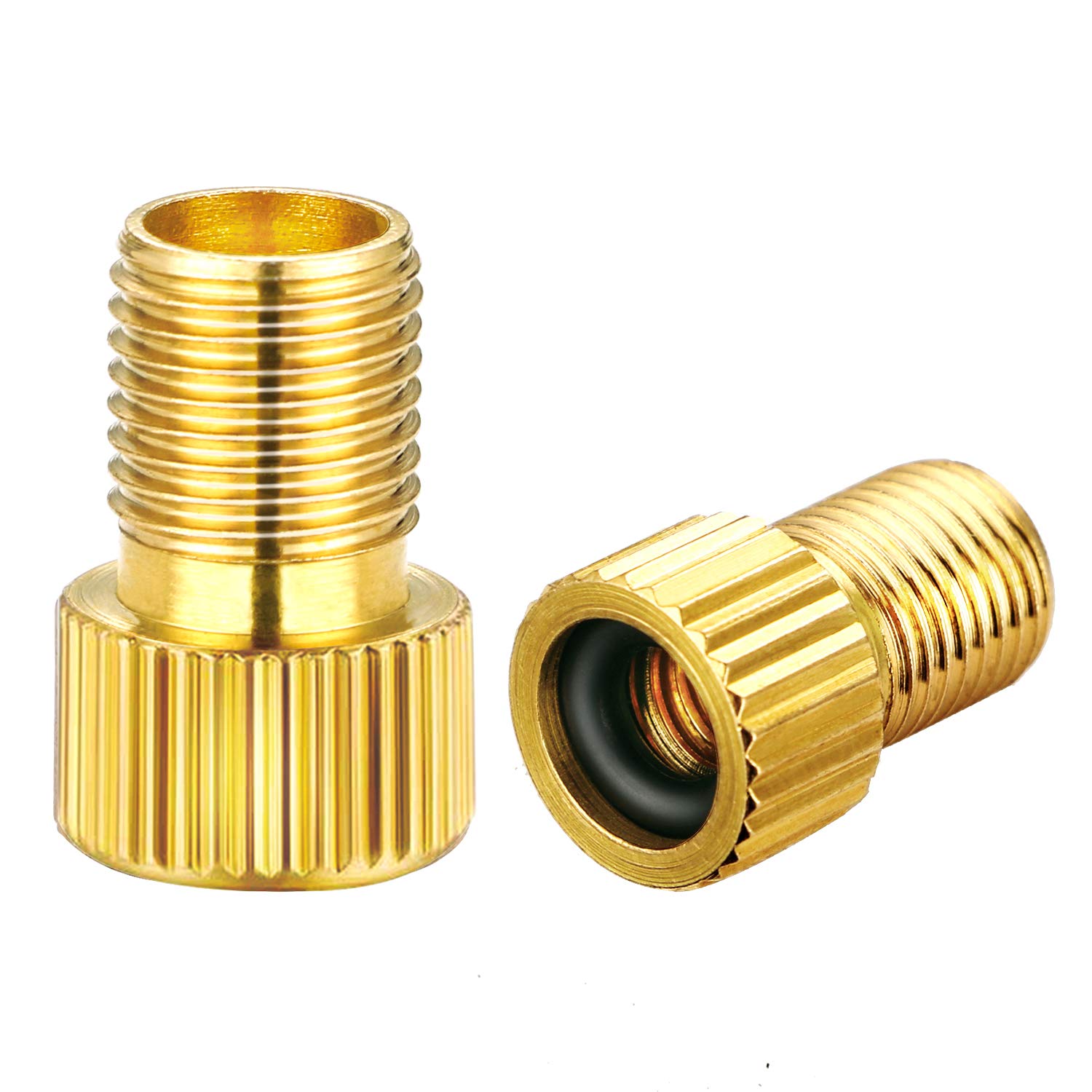

Shouldn’t be an issue. I initially had the Brauss 36er CF rim which is also quite deep, and ran the vee tire tube without a problem. I did use a Schrader adapter which extends the length to about 48mm.

A bit more expensive than a Schrader adapter (which is a great idea)… but if you are in the market for a new pump it might be a consideration.
