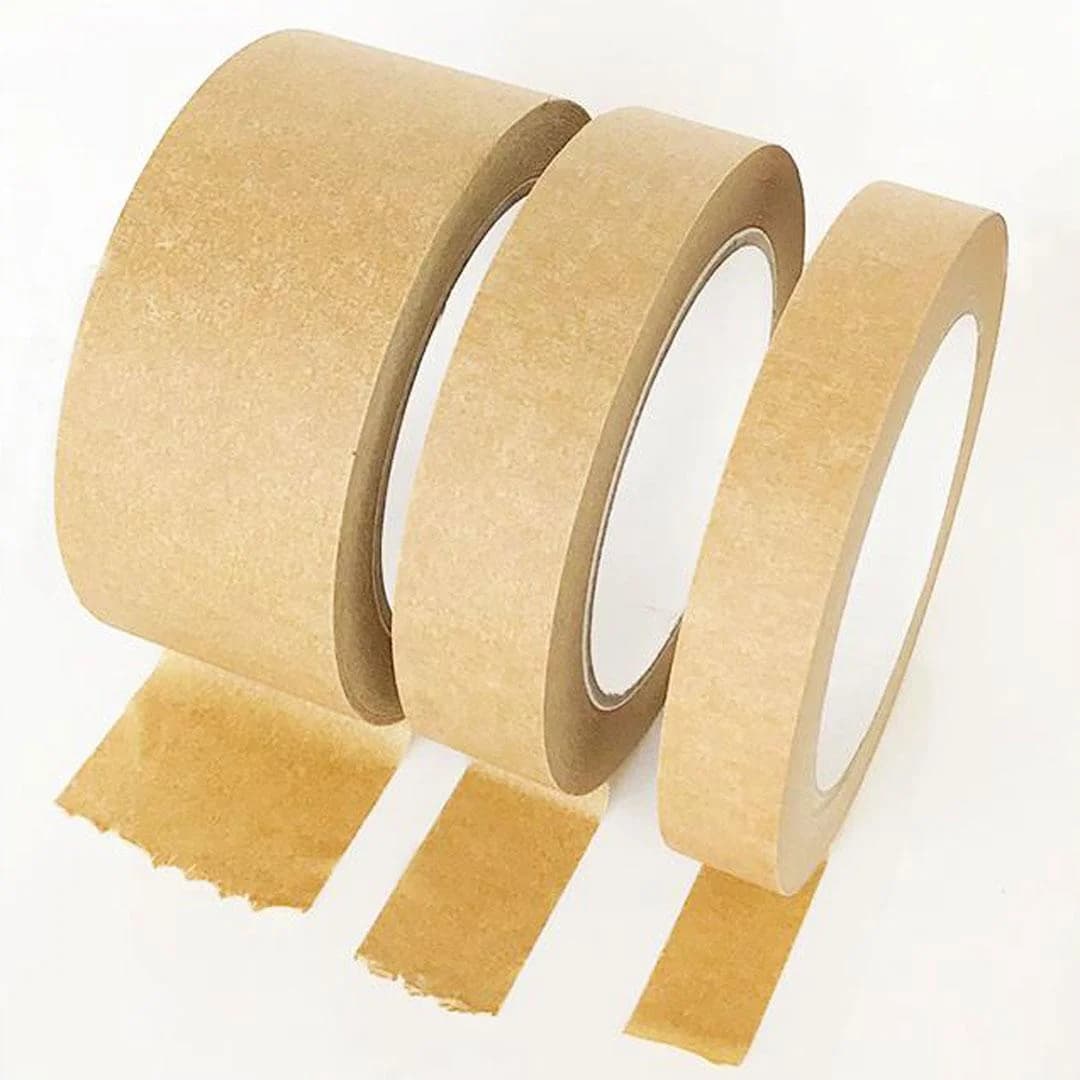

I prefer paper tape for paint job, about 4 laps if high pressure for road purpose, 3 for off road purpose
Electrican tape will move into spokes holes with high pressure
By this do you mean brown paper packing tape?
No , not brown packging tape
So, not this?
If not, I’m not sure what you mean by paper tape.
I think he might be meaning masking tape.
So this is masking tape
