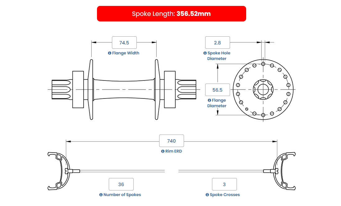

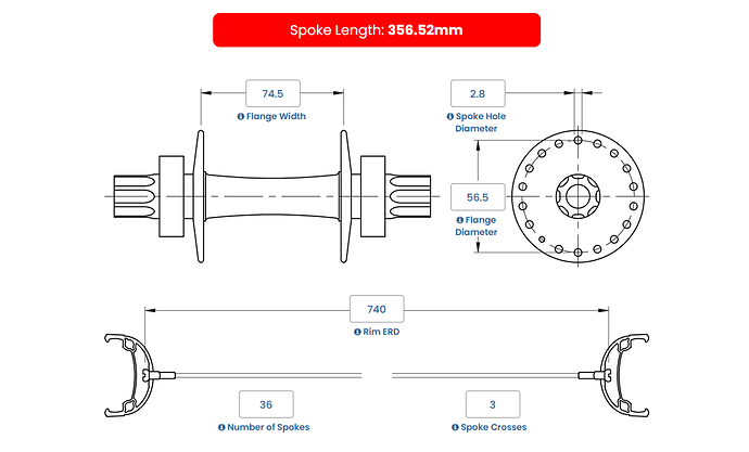

Yes, I did include 3x pattern in my request. This was their reply, which is wildly longer than the UDC UK spoke calculator gave me.

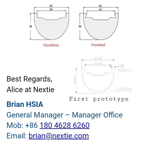

Alice also sent me the updated profile drawimg for the hooked rim. I inserted the original prototype on the bottom right for comparison. You can see there is a slight difference in the rim channel: it’s a bit wider and now has slightly raised points just above the channel, and the vertical walls below the hooks appear to be more squared. The dimensions remain unchanged.
Well, it doesn’t help that they’ve made quite a big mistake on the calculator…
As I said before, they’re only going to throw it into a calculator (incorrectly in this case) rather than actually being able to confirm anything.
The updated drawing doesn’t fill me with confidence, as the ERD is the same, the BSD is the same, and the wall height is the same, but hopefully the slightly higher looking bead lock and the hooks will do what we need them to do.

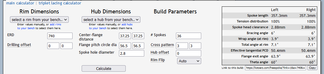

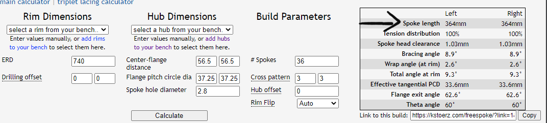

UDC
Freespoke
I won’t go into detail of why they’re different but it’s down to a small factor added to the calculations UDC use. Presumably it’s the right thing to do as lots of calculators do the same :smiley:
Yep, that’s the same result I got using the calculator.

I have zero confidence this will reduce the possibility of a blowoff - the wall height (or lack thereof) is simply too short for the bead to fit into. I just don’t see it happening.

I just sent an email to Alice requesting that they make a short video showing the nightrider tire being mounted to the hooked rim, and inflated to 60psi. Hopefully she will have that done and send me the clip. Not sure if that will prove anything but it would give us an as-yet unseen perspective.
From Alice this morning:
"Hi Terry,
No worries at all. We must do the test before we ship the rims to you all.
I have double-checked with our engineer, the max tire pressure for the Hooked 36’’ rims can reach 60psi. The hooked areas are no problem holding the tire bead."
And, regarding spoke length she said that she inadvertently juxtaposed the numbers and that corrected result matches that of the UDC calculator based on the same criteria.
