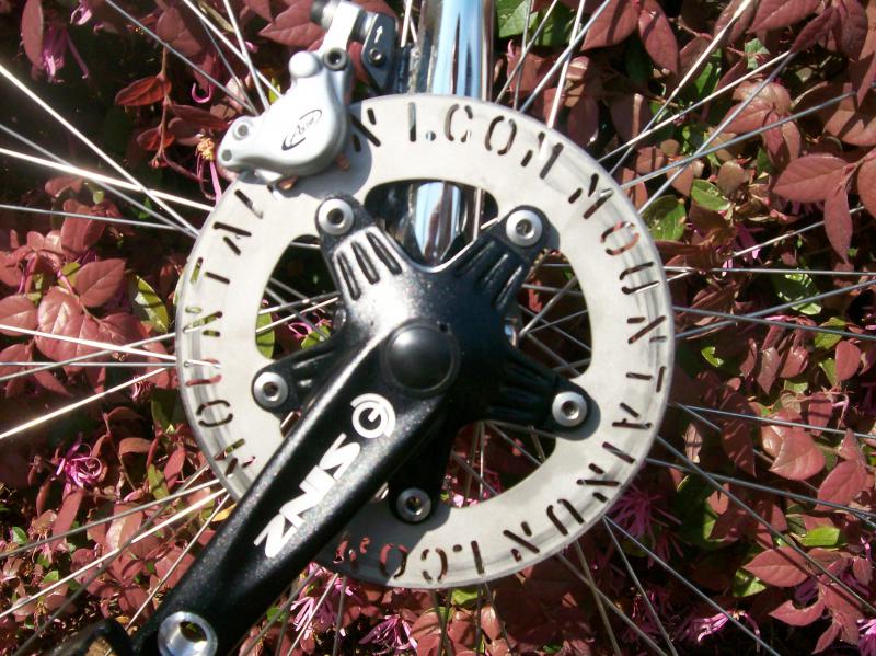

Does that mean there’s a Nimbus steel-axled disc-compatible hub, or are you risking the aluminium-axled one like on the 36er?
(you’ve got the disc on backwards, by the way. The spokes should curve the other way - it’s to hold the rim of the disc taught under braking to stop it crumpling, although probably less important on a unicycle where we’re not going to brake as hard as a bike)

Is that a mountainuni rig?
See thread: Mountainuni Disc Brakes Have Arrived!
Nurse Ben seems to have some inside info indicating the new one from Nimbus for muni will be steel: 26'' vs. 29''
Bearing holder brake mount…
uniShark, I think you are probably right about it being from Mountainuni.com.
At least it looks like their idea for the bolt-on mount that I saw somewhere in that thread.
I was one of the testers for the weld-on mount with their custom rotor bolted on to a pair of dual-hole (125/150) Sinz cranks, and it has been working flawlessly for months. I love having that brake on my 36er, it is so smooth. Also, I can now just open it up on any size downhill knowing that if I need to slow down I can slowly modulate the brake to get my feet spinning less that 200 rpm’s…
