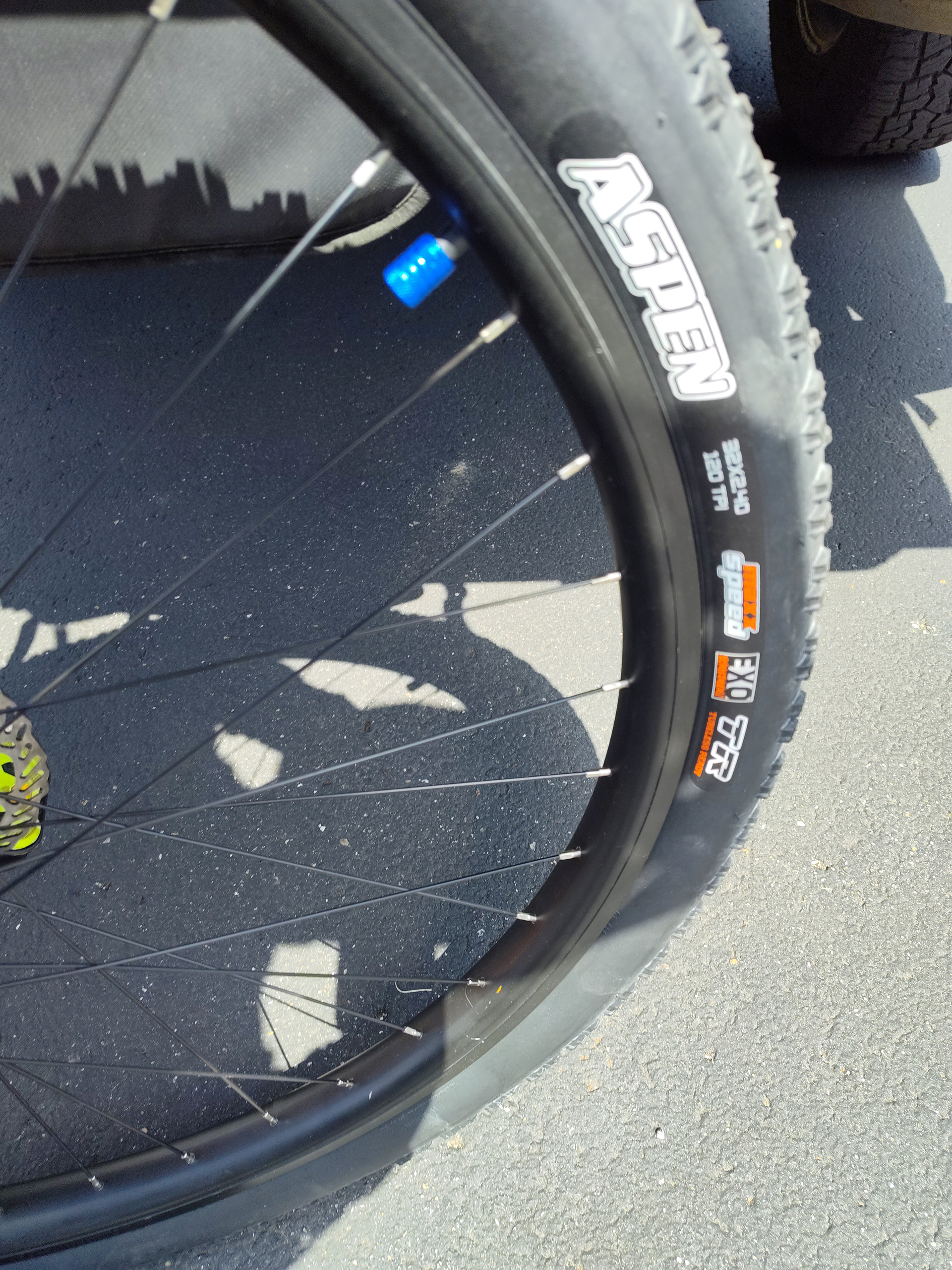

Thanks to the magic of Amazon and a shout out to 365 cycles, the Amazon seller, I received my Maxis Aspen and mounted it this evening. Unfortunately I won’t have a chance to ride until the weekend. Greatly looking forward to it, stay tuned

First ride on the Aspen on pavement . It is definitely lightened up my rig. I tried 25 and 30 psi, with 30 psi feeling better to me, I know its 5 psi higher than rated. Im on the fence right now weather I like it better than the night rider. A trail ride is on the agenda for this week, I’m going to try 25 psi and see how it goes.
I wouldn’t be worrying about that on a hooked rim with a nicely sized kevlar tyre bead.
I’m going to dispute my own claim. After spending some time on the Aspen on different surfaces I have settled in at 25 psi. I really find the control better and my speeds are higher than at 30 psi.

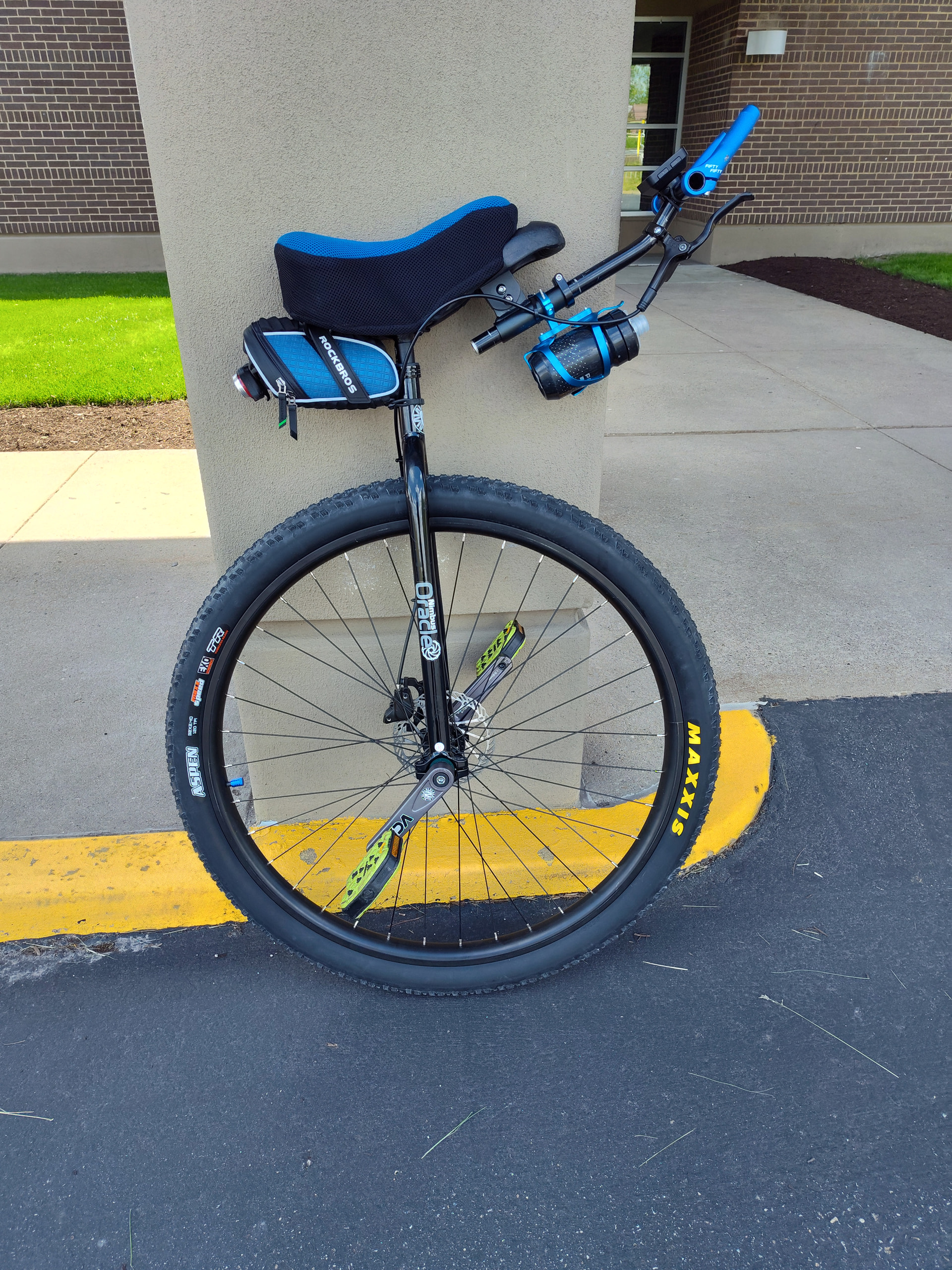

One last thing , I may have finally put together the perfect unicycle for me. This 32 unicycle as configured with the oracle frame, Maxis Aspen tire, KH saddle with air saddle cover, 138 cranks, KH touring bar, shimano disc brake, Look pedals , rock brothers saddle bag, aluminum bottle cage and fifty - fifty aluminum bar ends. This unicycle has everything i have been looking for, it is light enough, fast enough, comfortable and in my opinion looks great. I’m very happy it’s been a journey and transformation from the used UDC Titan 32 I started with.
Nice ride, what kind of things do you keep in the saddlebag? I generally wear a hipbag with things like phone and wallet. My rides are so short that even if Im 5km away from my car, I can just walk back if I have to.

phone, keys, wallet, allen wrenches. If I go for a long ride I have a small back pack I can carry extra water, a tube/ tire levers a multi tool and a pump. it’s been a while since I’ve been on a ride to warrant the back pack.

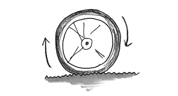

Interesting read about 32″ Wheels
We already know that the bigger wheels don’t have better ‘roll-over’ when it comes to the (relatively) small surface irregularities of gravel or cobblestones: They absorb the irregularities within the tire rather than lifting the wheel over them (above). We’ve just seen that the larger diameter also doesn’t give a 32″ wheel more momentum. The only ‘advantage’ of 32″ wheels is that they’re heavier.
Odd I was sure bigger wheels have a better angle of attack to the same bump and it is therefore smoother over said imperfections than a smaller wheel.
While I like the stylised intent of the article and that it wants to stick to facts. It feels a bit selective and with an underlying conviction that this is just another marketing ploy.
So I read the article, and then clicked through to their “Why 32” wheels don’t have better roll-over", which on the article has changed to “Why 32” are not faster".
Wheel size doesn’t really matter as long as the bumps are small enough that they can be absorbed by the tire.
So far every tyre released has been intended for terrain where you’ll get bumps that are larger than can just be absorbed by the tyre. What a weird set of articles.
I didn’t say that the article reflects my opinion. However, I found it interesting that René Herse contradicts the conventional thinking about rollover, which is worth investigating. But others have more technical knowledge than me.
