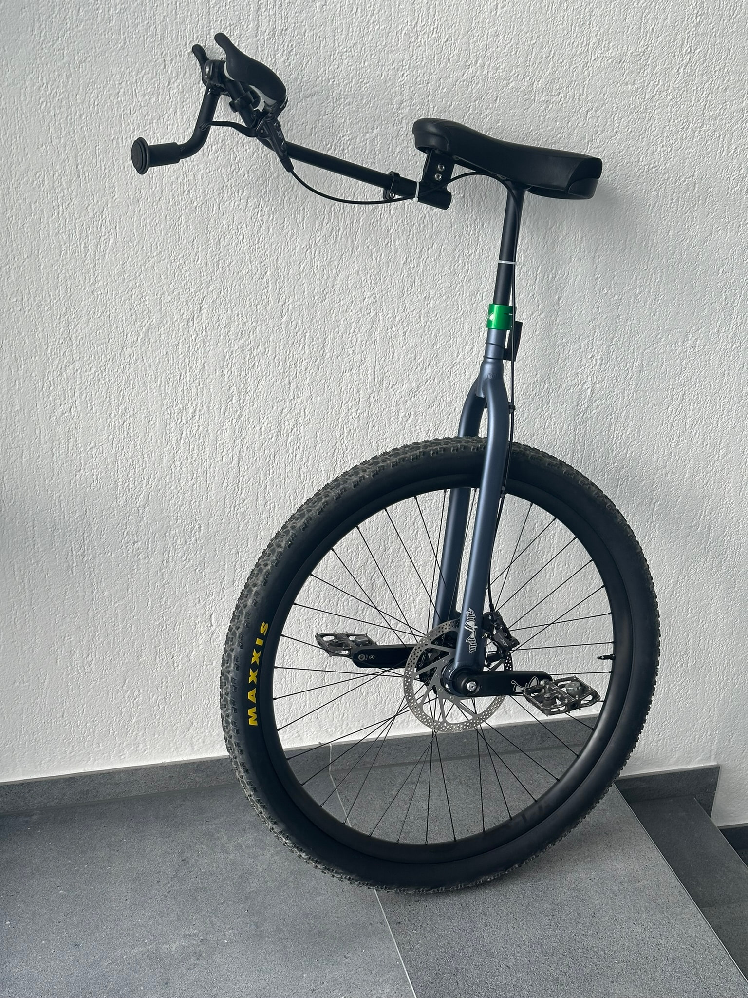

I use the Aspen 32x2.4 for road and gravel riding, paired with a Schlumpf hub. Less than 100 km so far. However, I found it to be a bit too compressible on asphalt at 1.7 bar, especially given my weight (~100 kg). Therefore, I now ride it at 1.9-2.0 bar for distance riding to reduce rolling resistance. So far it has not popped and I am very happy with it :grin:

It is the TR3230 from CARBONAL. It is a 30 mm wide, 28 mm deep, symmetrical carbon rim. I am using a tubeless setup with hooks, configured to match my Schlumpf hub with 36 spoke holes.
