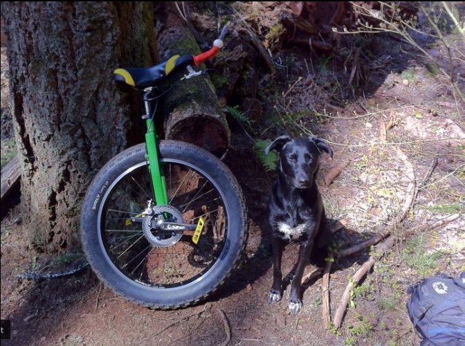

That Surley is a monster of a unicycle! how much does it weigh in with the Larry?

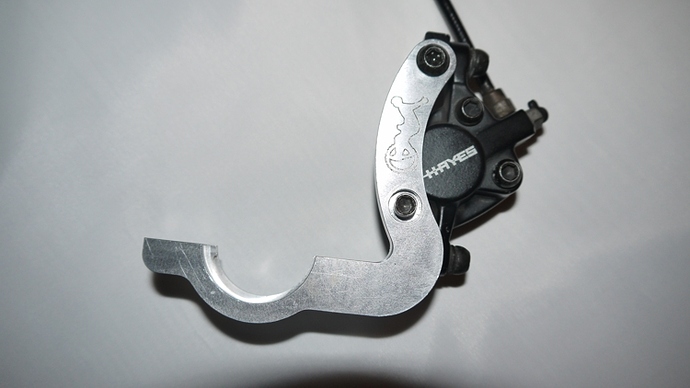

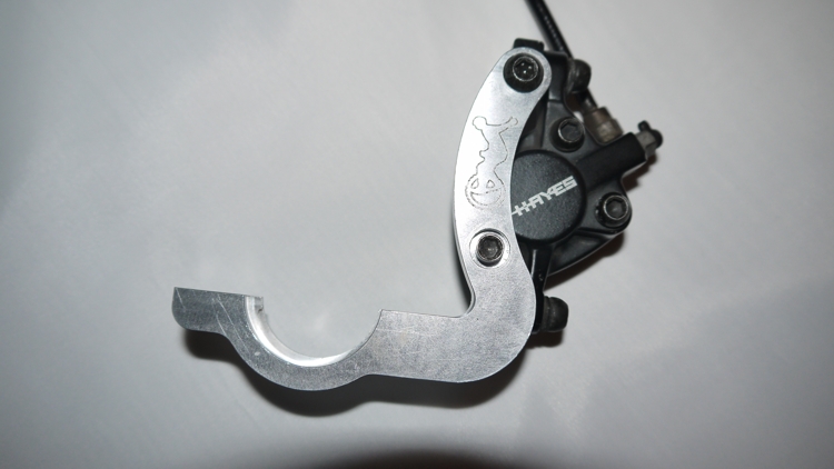

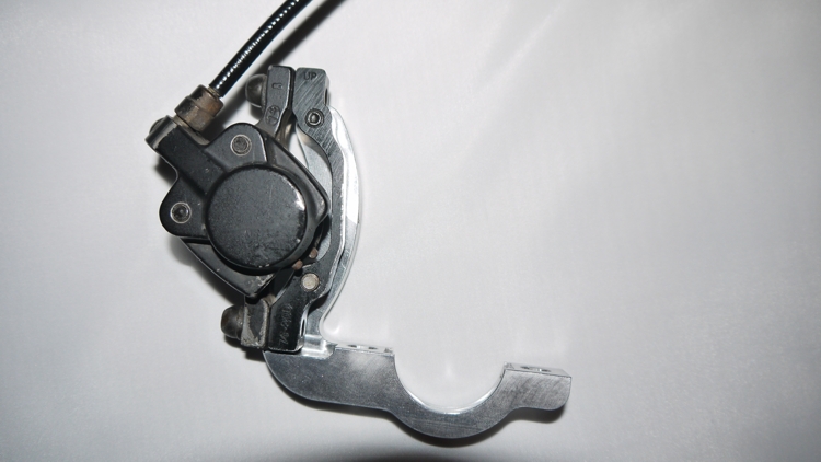

160mm inboard rotor testing…
We figure that a nightrider frame with an impulse disc wheel could be mated with our UCM without having to replace the nightrider to get the disc on your Uni.. the 160mm adapter fit, but the caliper struck the UCM. So, we modified the UCM and the corrections will carry on to future production. this means that the UCM will work for the MountainUni right side outboard and for a nimbus left side inboard system from 160mm rotors to 203mm systems!
Cool, so I might put that disc brake on my older Nightrider as well.
Yup, that’s the plan… you can use the current UCM for the MountainUni system, or the second generation UCM to put the impulse hub with Bengal brake and 160mm rotor in your old nightrider, tell us if it’s square taper so we can send you a shim.
