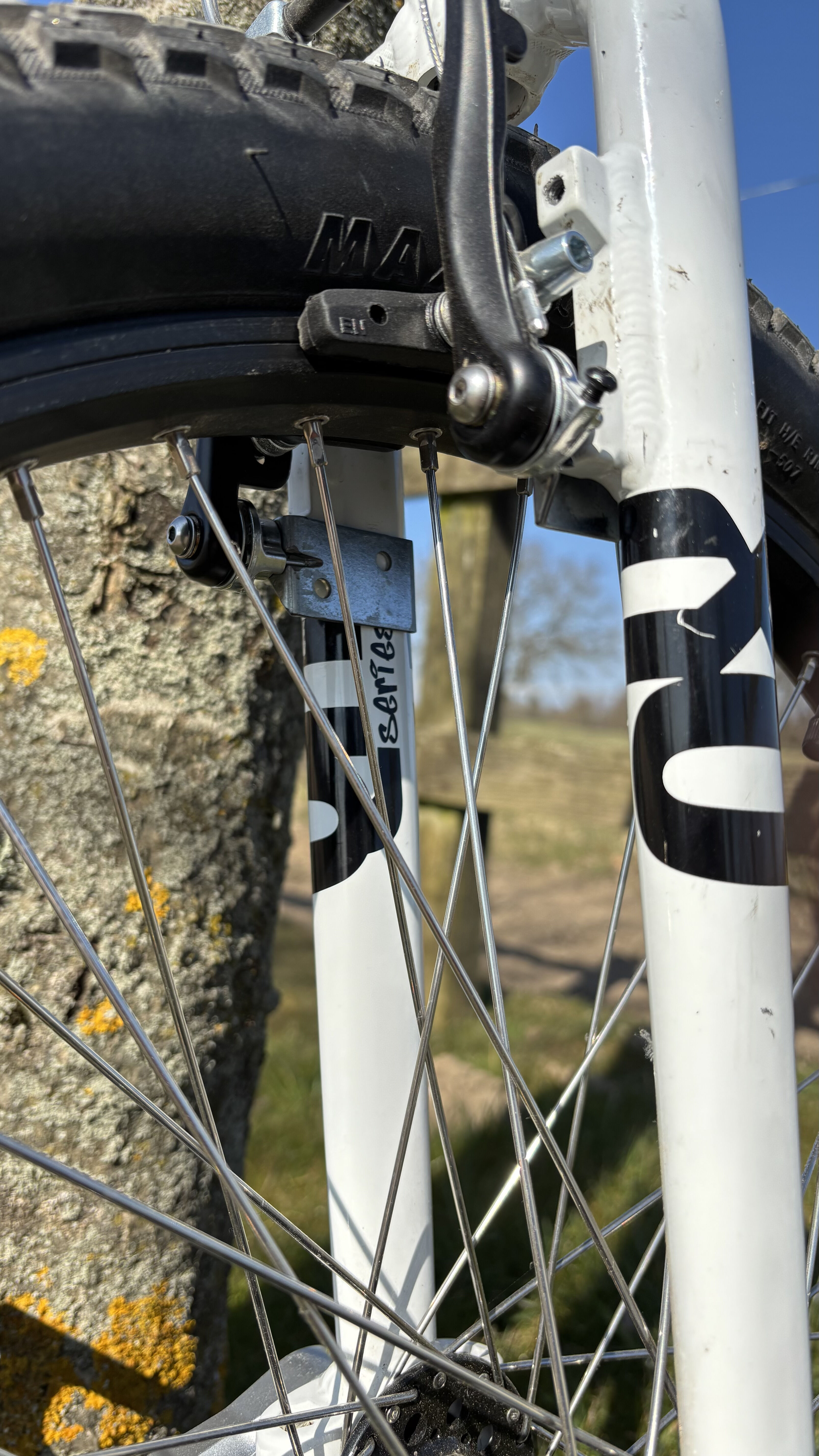

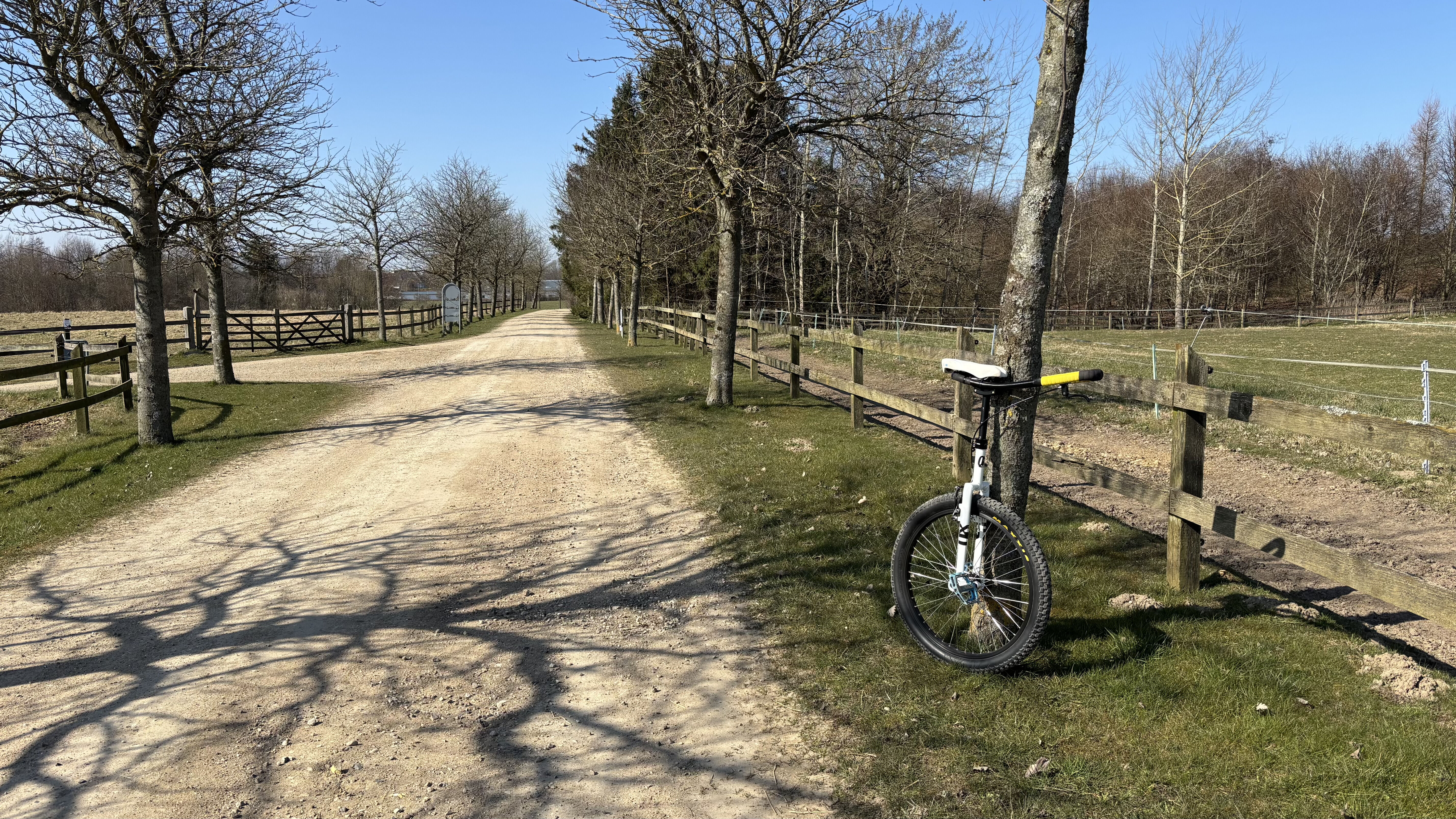

My small wheeled unicycle got a v-brake. Details about the Magura → v-brake conversion can be found in this thread. Quite a fun and successful project.
It looks happy doesn’t it ? :slight_smile:
I missed the brake. All my bigger unis have brakes.
It makes the downhill parts much more relaxing.
Whats next? Probably shorter (that the current 89mm) cranks…
Is there an advantage with traditional v brakes as compared to magura brakes or is it just that they are harder to procure?

The v-brakes gives more room for adjustment. The Magura HS (hydraulic v-brakes) only fit if the rim width is “right”. So if running a narrow rim like me the pads simply cannot reach the rim. I believe I have tried in the past on this unicycle with a HS11 (which I have since sold). You can source special adapters like these but Brexit makes it a very expensive experiment that does not guarantee to solve the issue. And installation of the v-brake was probably ~20€ including various hardware, the brake and the lever. Cheap, fun and effective.

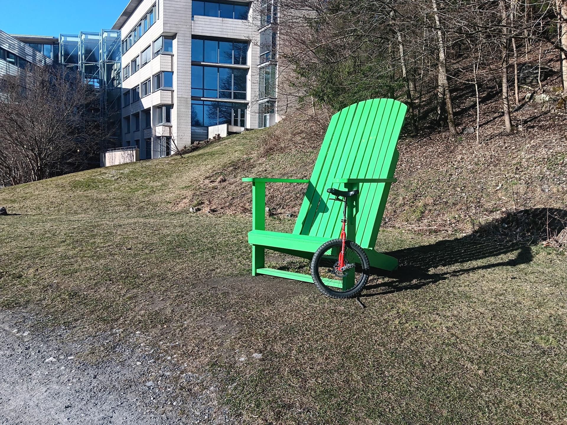

Look at this tiny, little, micro machine I cycled in on today. I include a chair here for reference.
And yes I need to buy a bigger saddle.

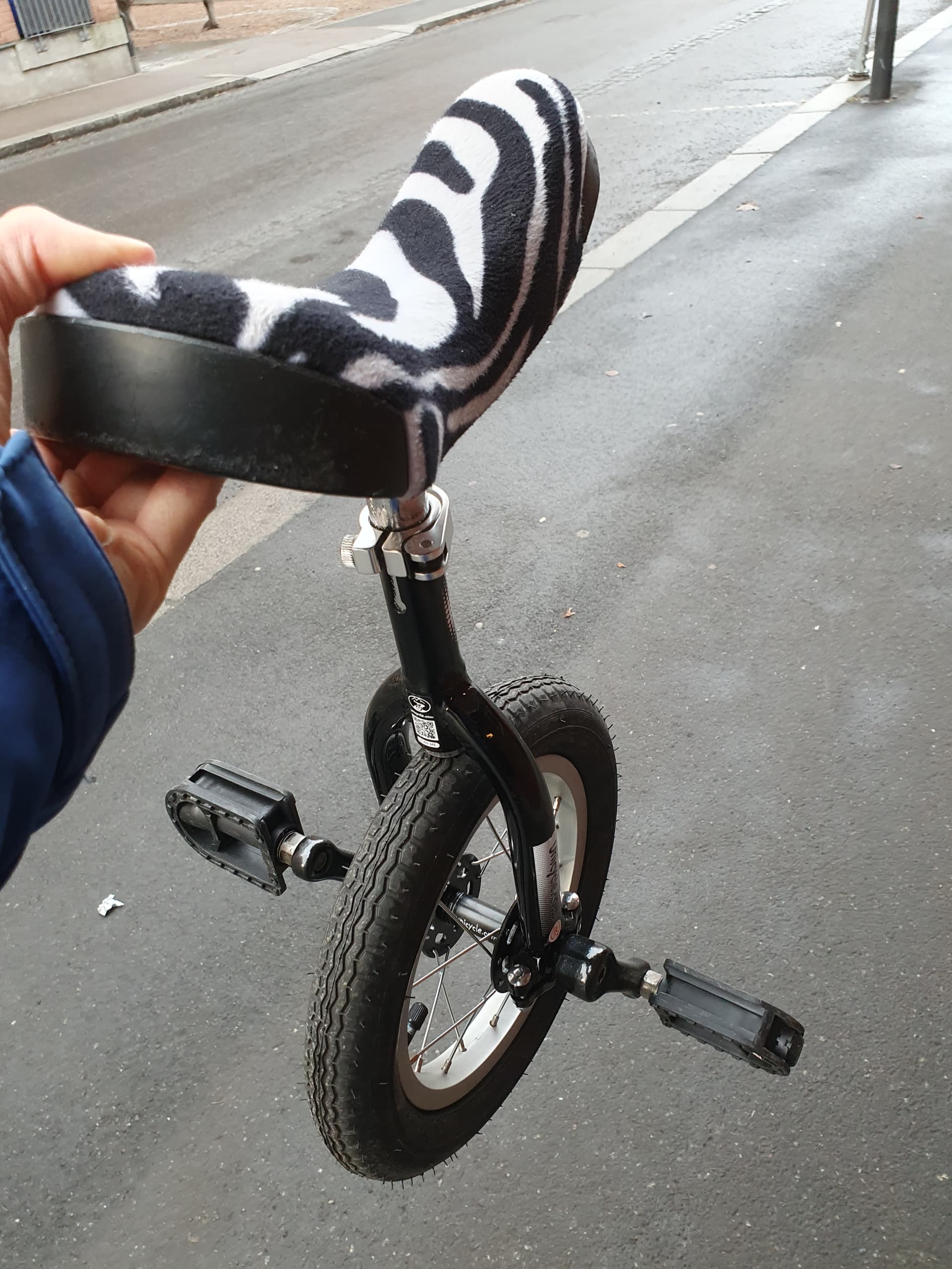

Lets give my smallest wheel and my longest seat post a go!
Starting with the only setup that lets my son reach any pedals with cranks longer than 45mm. 12"/89mm and the shortest seatpost cut even shorter:
This was rather tricky but unexpectedly doable. I have actually tried a 12" before on Jordalslekene but then the seat height was about twice the length.
So is it even possible for a 183 cm guy to ride the 700 mm seatpost without cutting it down?
Just barely, with the post rubbing the tire, on my toes and kinda jiggling from side to side, streching as much as I can! I guess 75 mm cranks would have been slightly more ridable (and made more sense I was struggling with pedal strikes when turning!), but I cut the post a bit nevertheless and put on a proper saddle.
So I gave this crazy 12"/89mm machine a 1 km spin yesterday and that was quite something. I was having a hard time not to let others simply walk past me. And when trying to go real fast, that is past 8 km/h or 140 RPM, I just had to jump off in the front since it felt so unhinged.
I don’t think I am even going to bother with 75 mm cranks on this nanomachine. I’ll be moving straight to 45 mm if they even work anymore. I guess I will try a 3 km ride, or maybe even 5 km like @Syoten (oh and did you give shimming your 50s another go, as discussed far above?), but furter than that can’t really be any fun at all. Speed bumps and curbs are challenging enough even on 89s. And 45s won’t really make matters better.

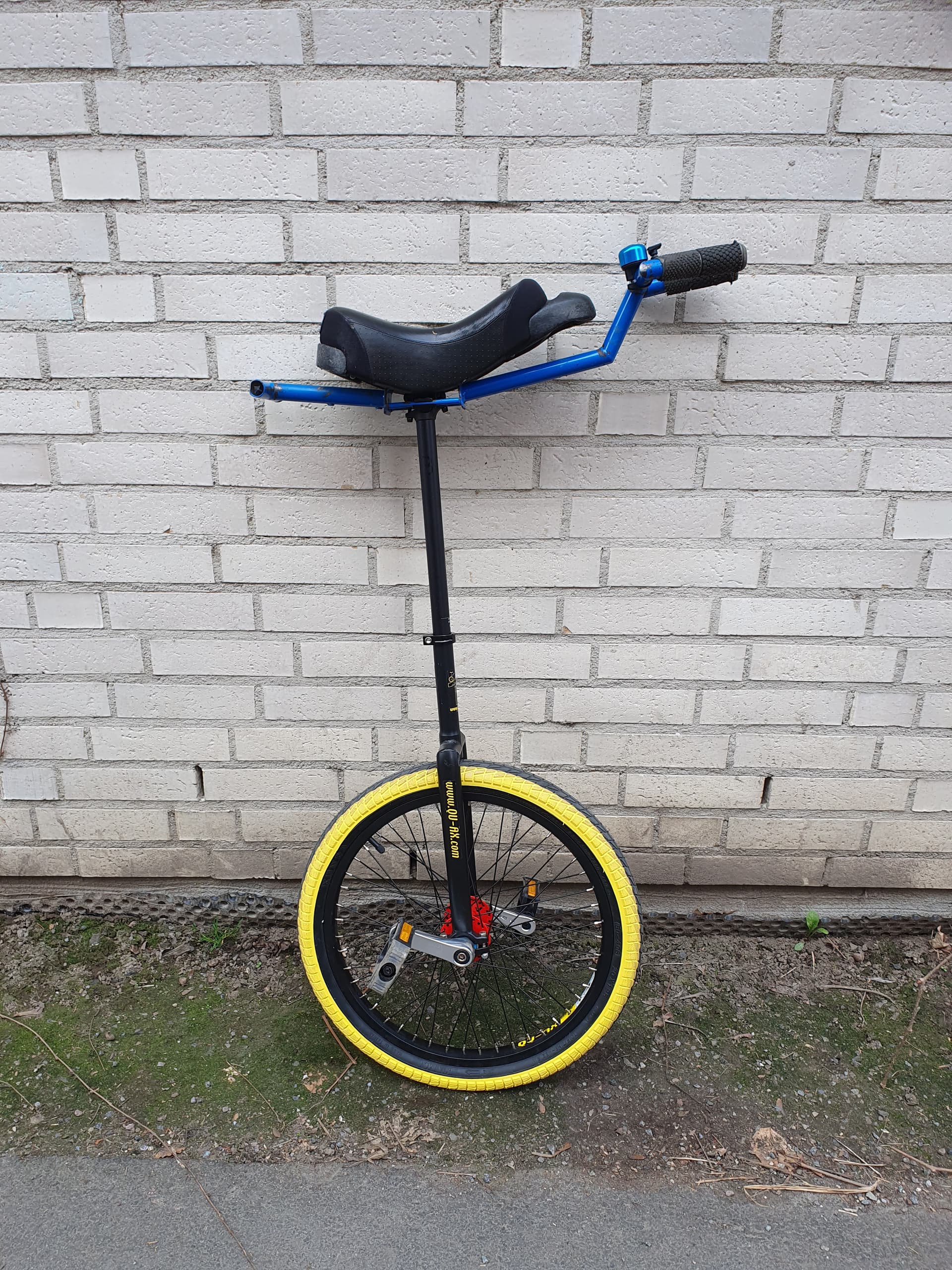

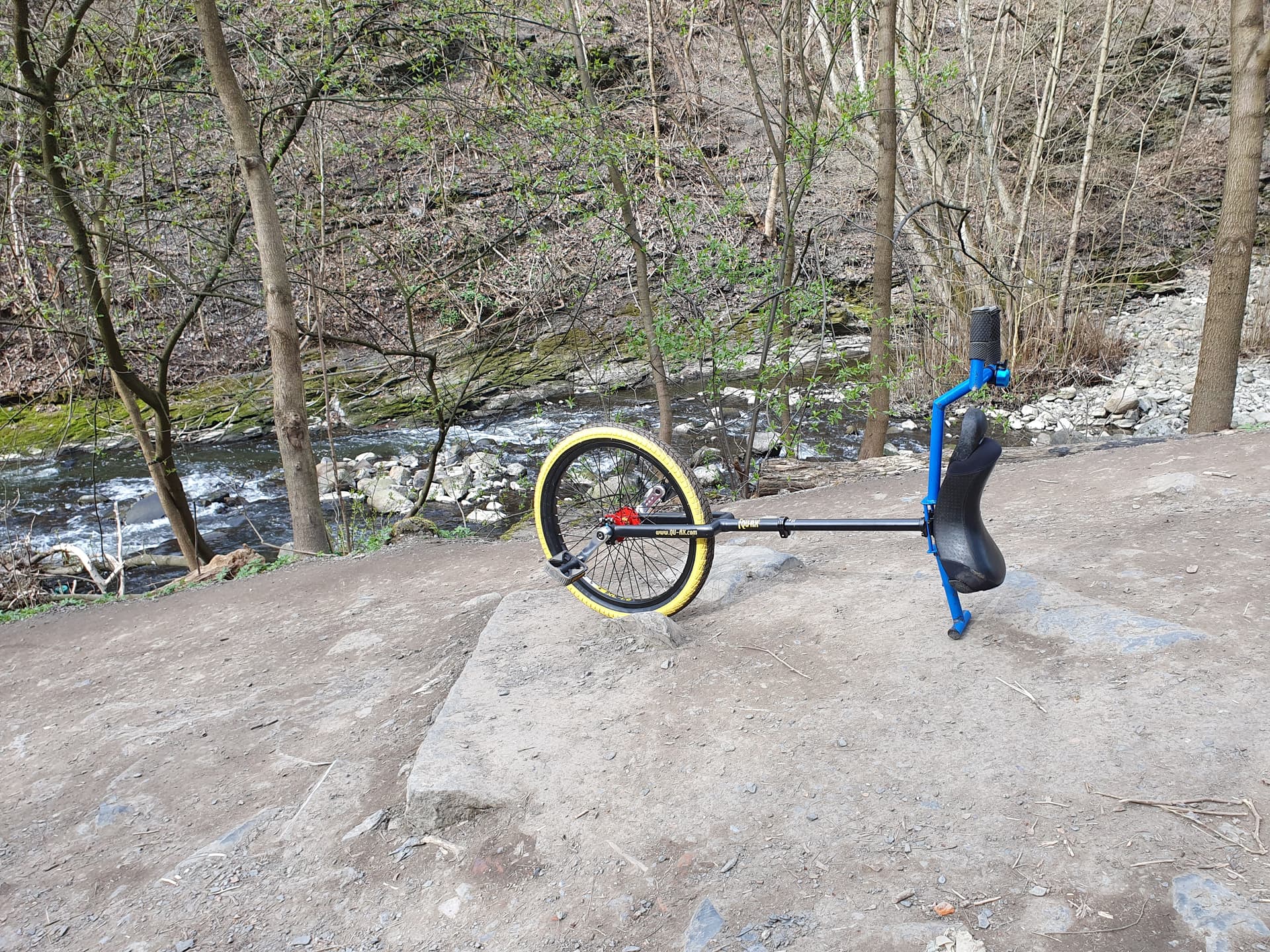

A friend lent me his 20", so I could finally try some proper Micromachining! :star_struck: The seatpost was to short, but luckily I have a new seat post for my Coker handlebars I haven’t cut down yet. So now I was ready to try the @Wheelou setup, as it had 100mm cranks. And I have to agree, this was challenging indeed. It was like treading air and all the movement made my legs numb.
So I put on some 89s like @pierrox instead. And this was a pure joy! I can do absolutely anything on this machine, and it was easy to push to 15 km/h. I even enjoyed some light Muni! :star_struck:
This was great fun and I could even ride backwards and just fool around. Speed bumps and curbs were no challenge at all after riding the 16"/75mm combo. This was soo satisfying.
I will definetaly try 80/75mm cranks but I think I will be happy with and enjoy the 89mm setup more actually, for the increased versatility. For instance, I didn’t struggle downhill, which night be an issue on shorter cranks.
