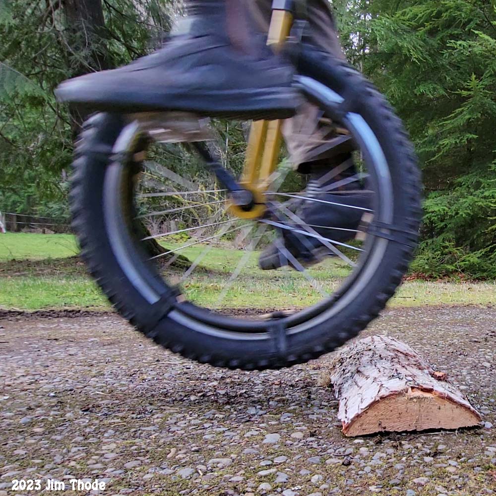

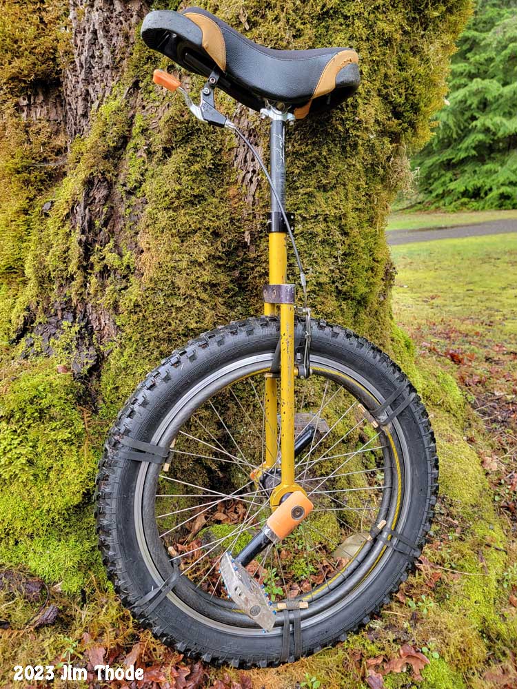

Now we just need a follow-up experiment to this one:
Wonder if anyone here is willing to take a stab at the world’s heaviest 16 inch wheel :slight_smile:
I don’t have a 16" but did add about 9 lbs (4 kg) to my 24" with a similar results. It rolls over bumps more reliably.

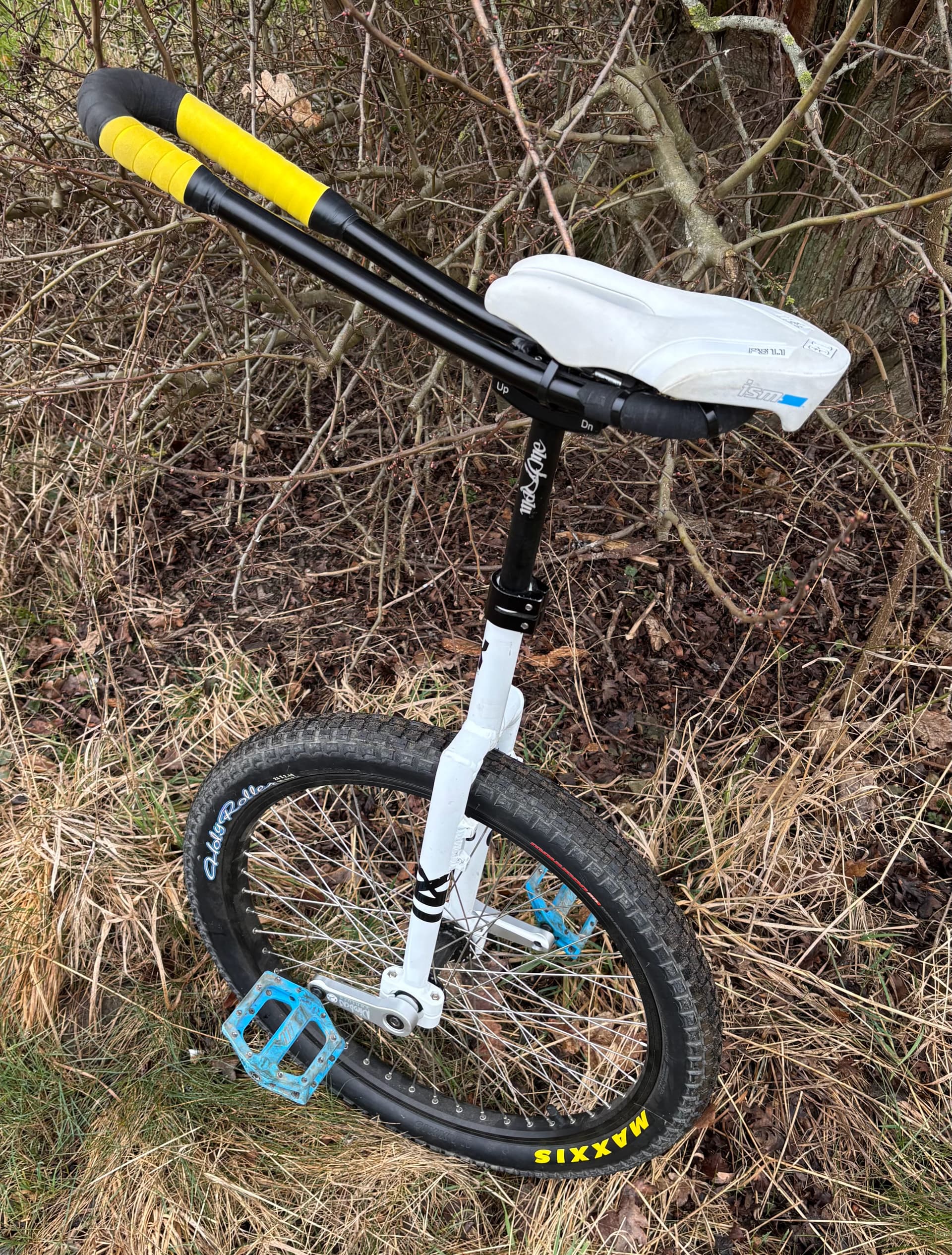

I did a rebuild of my 24" using various old parts and some new 89mm cranks. It’s not micro - but I can’t see myself riding a smaller uni for any reasonable distance :slight_smile:
It’s a Nimbus 48h hub, Alexrims/DM24 rim and a Maxxis Holy Roller 24"x2.4" tire.
I was quite surprised how well it rode - also on the uneven gravel parts of my 9km route.
Average speed (14.3km/h) was also not much lower than on my 29" with 110mm.
I never ride brakeless so that was to be honest my biggest fear. But even on the longest steepest descend around me I managed to ride (very slowly) from top to bottom.
I’m tempted to try even shorter cranks and add a brake but I’m not sure I’m ready to do that kind of investment in a micro machine…

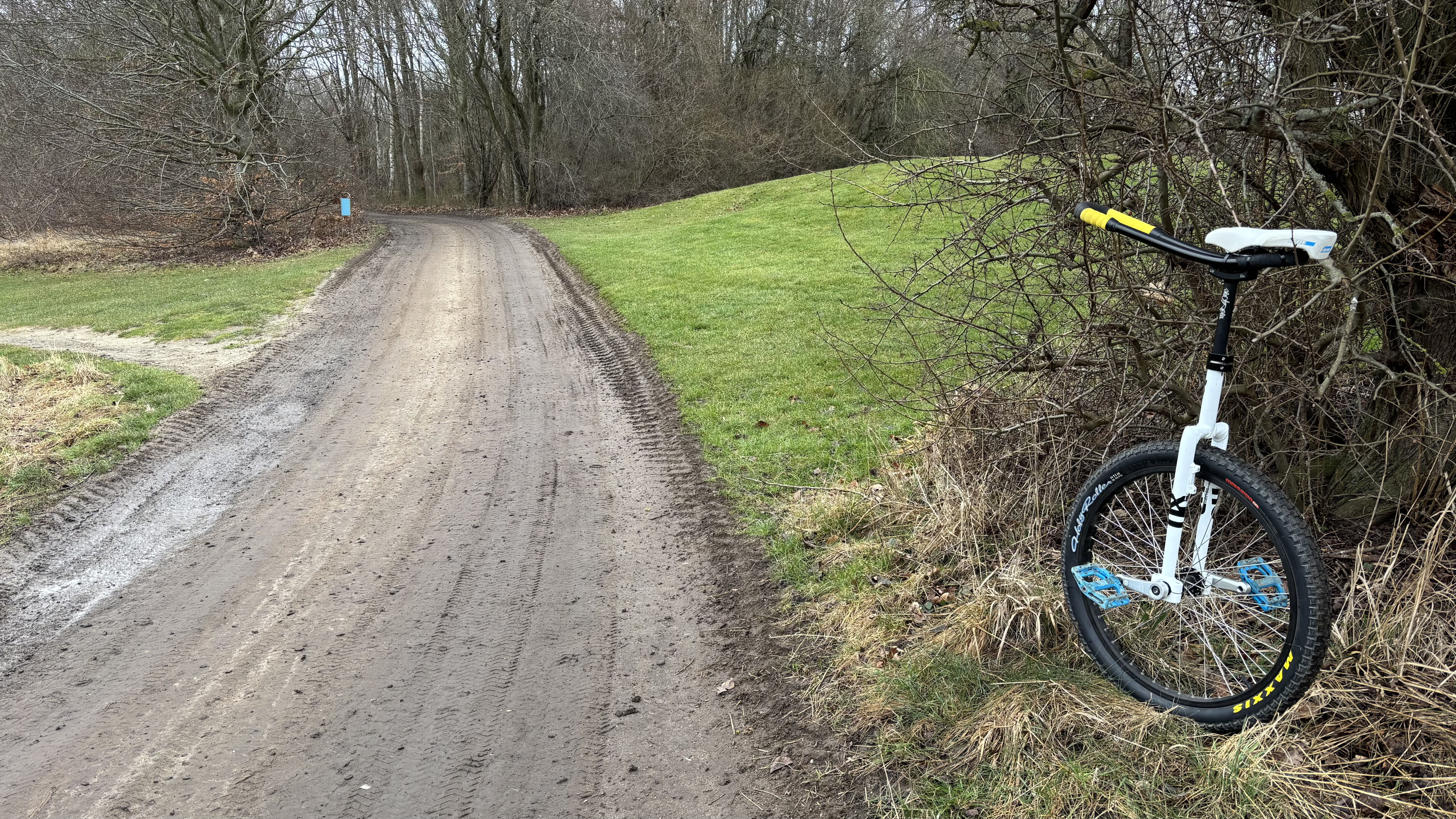

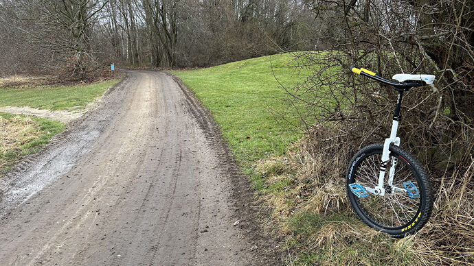

Went for a ride today, one of those quick ride where you only have one hour and not one more minute. So you don’t overthink, and just get on with it.
And gosh that was cool. Really getting into this “small wheel - short crank” experiment. I was really confortable with the 89mm today, zero fall and some decent speed. And more control. Almost thought about getting some 75mm, though it might be early, and miss Bank is probably not so impressed.
Lowered the tire pressure to 2 bars, and it is the sweet spot for the tire (and my weight).
Loving it!
