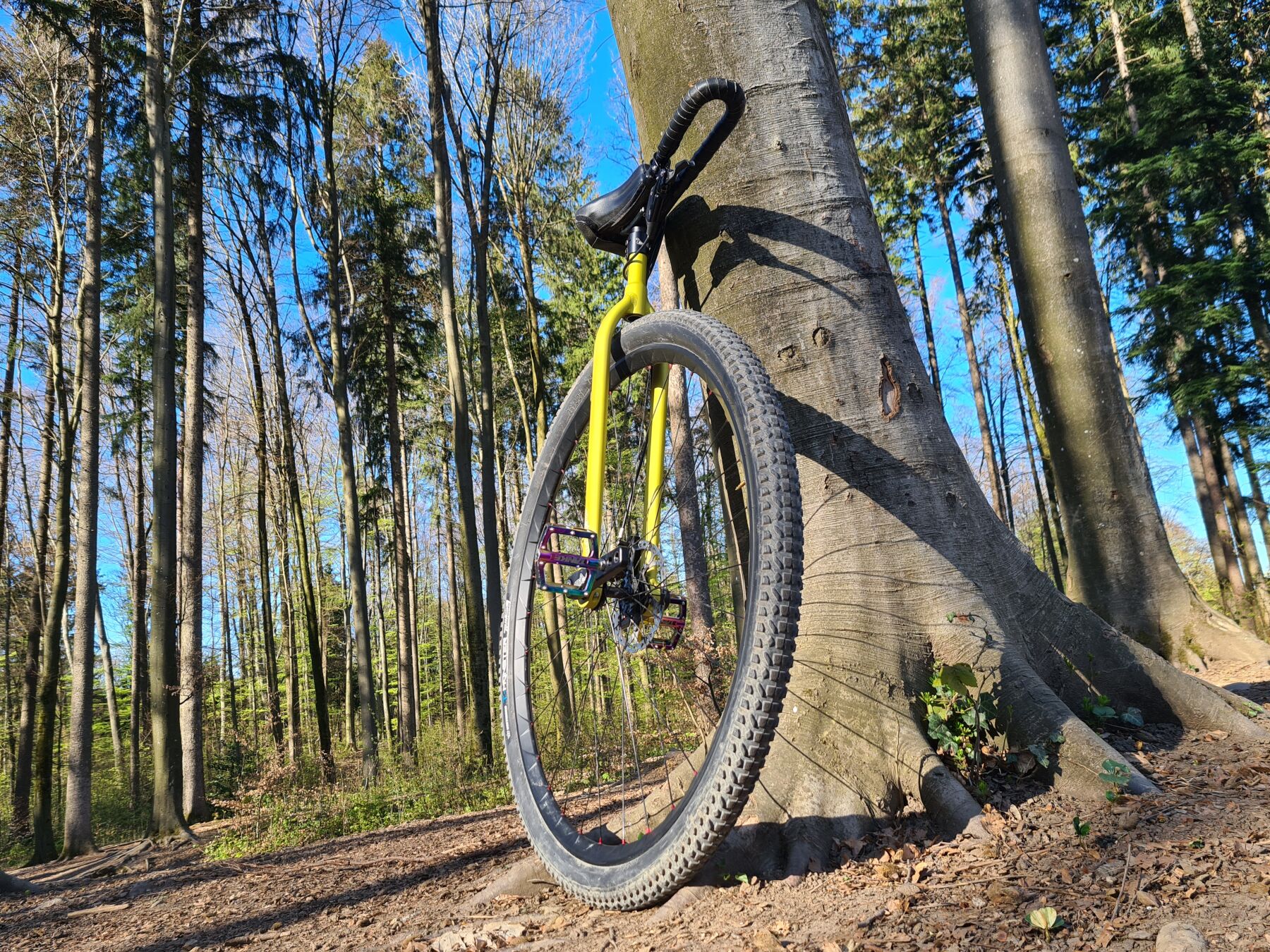

My new 36" build :grinning:
Oh my gosh and THAT rim! How is it?

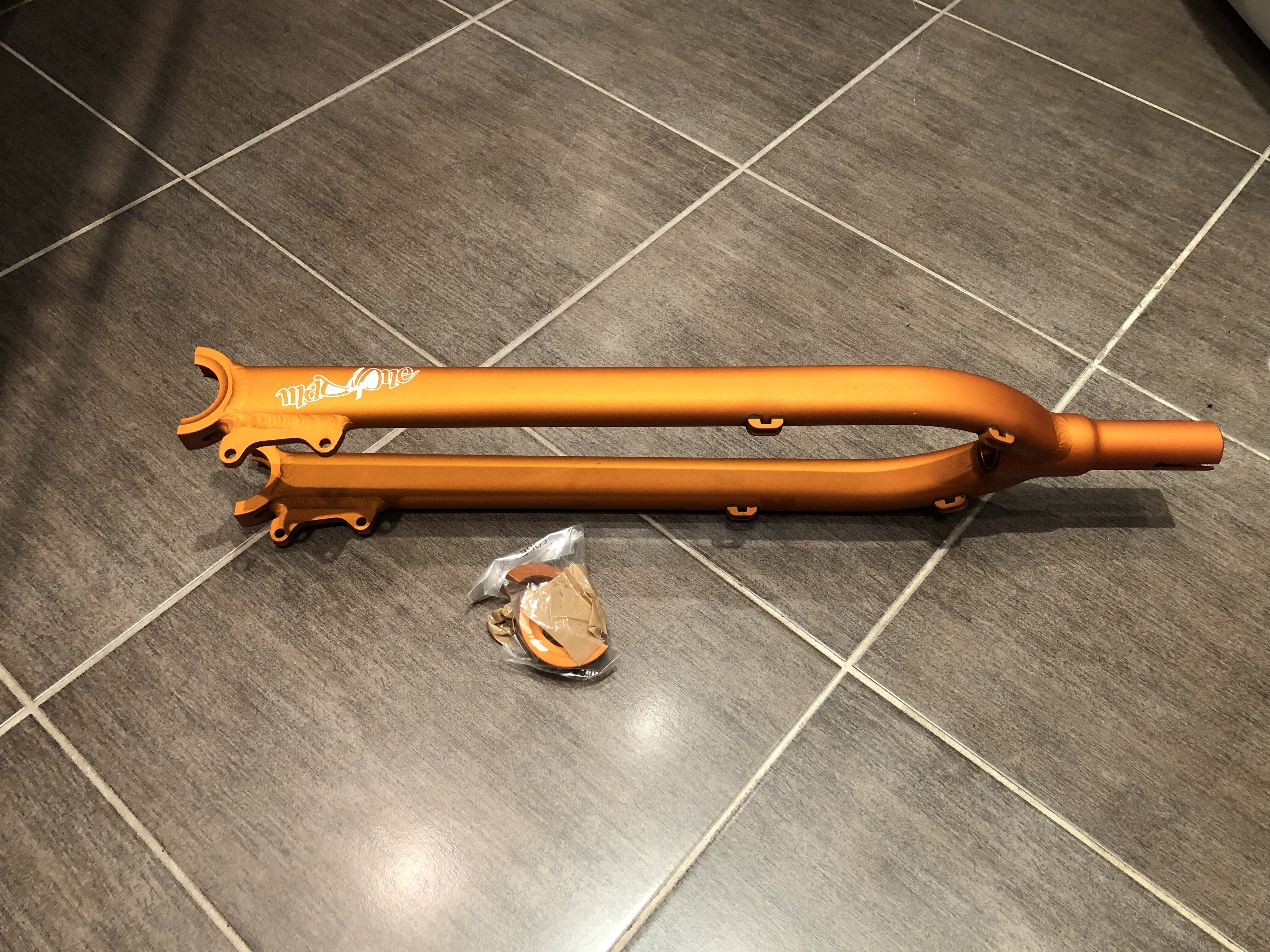

P.S. I got my frame today but I am going to have to wait a while before I can source other parts, e.g. a rim.
P.S. Side note. I also ordered another frame at the same time, so that I could put this together for one of my kids (and yes I am doing the typical parent thing, where I force my hobbies on to them! :laughing: )
You got a very nice one too!
No problems with the Braus rim so far - it’s my only 36" rim so I can’t make any comparisons.
Well I have to say yours finalised looks amazing. I hope you are enjoying it!
P.S. I wonder if you are the first one (outside of the M4O team themselves) to try out the frame. You probably are!
EDIT: And @UniMyra just pointed out which “Ben” you are and I feel silly. I guess you had this for a while? :wink:
