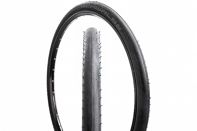

My interest in getting a unicycle has re-sparked recently. I’d like to have a 24" wheel with a slick-treaded tire. The problem is that this size seems to have the least number of slick tire varieties being marketed. And when I say “slick” I mean ‘totally bald’, like this Schwalbe Kojak, except in a 24" instead of the 20":

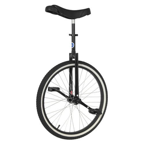

The unicycle I was considering is the Club 24:

Schwalbe make a fair few slick 24" tyres (I think they’re usually put on things like folding bikes and trailers). Doesn’t the Durano come in a 24", and the Schwalbe One?
They’re just a few I vaguely remember when I was shopping for slick tyres :smiley:
You can get the Kojak in 24" if that’s what you really want, just search Google.
You’re right! I found a folding-bike-centric shop that has it! The Schwalbe website shows a void in sizes between the 20" and 26", which, along with not finding it in a web search previously, had me discouraged.

It’s 23-520.

And I’ll add, with Roger in mind, that I’m surprised to see UDC USA only offering two choices of 24" tire, both of which are 3" wide. What about all those unicycle you sell with “regular width” 24" tires, like the Club? Where do those customers go for tires? Possibly local stores, because UDC USA can be pricey when it comes to shipping…
